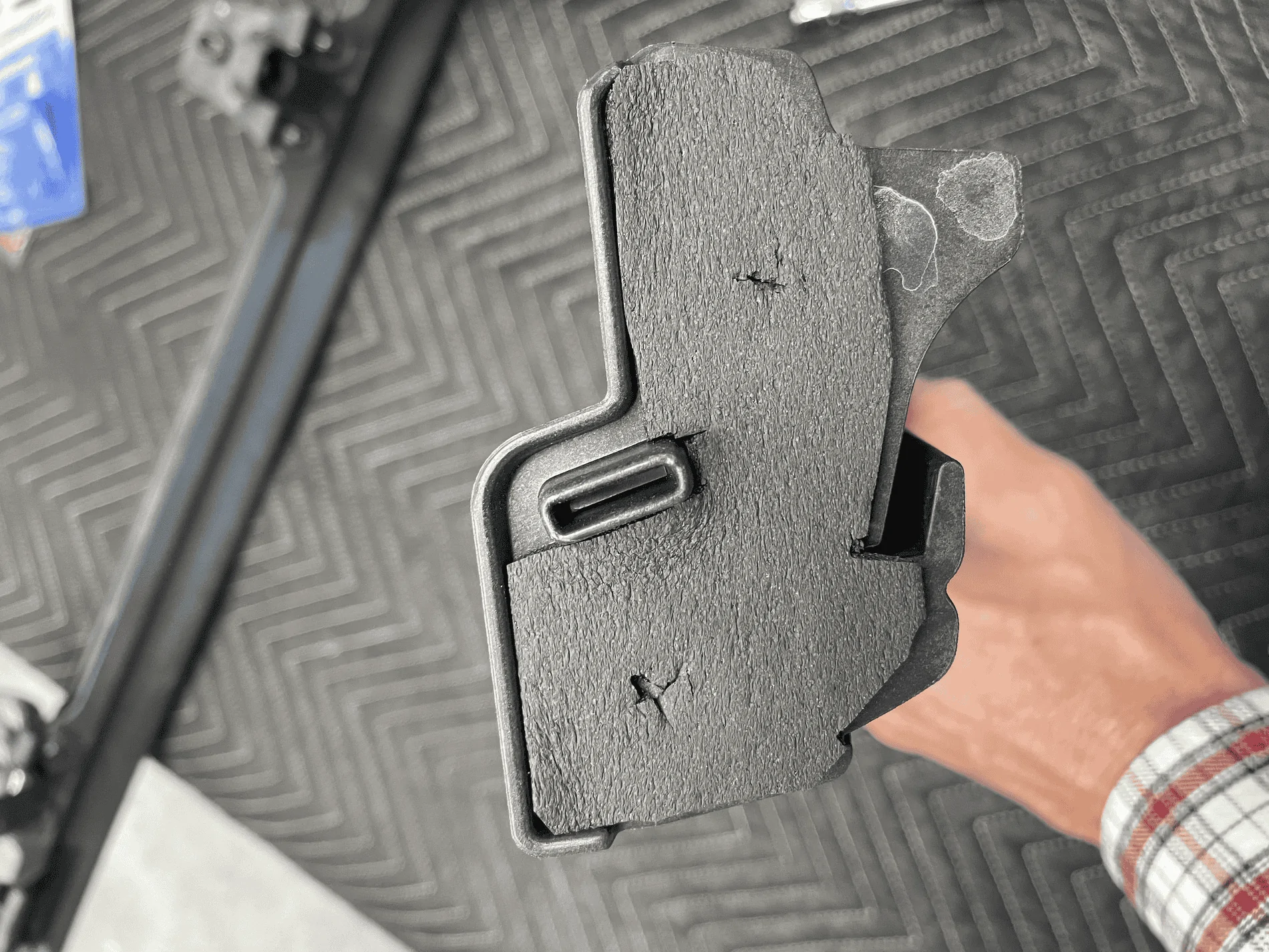

I custom ordered a JLUR last year with the dual top group. The soft top comes largely unassembled, in many boxes and wraps, all packaged inside a very large box the size of two coffins and stuffed into the interior of the back of the Jeep. Taking delivery this way, there is no feasible way to verify contents. When I finally (one year after taking delivery of the Jeep) opened the boxes to install the soft top for the first time, I carefully laid out all the components on a moving blanket and immediately noticed 4 bolts, 4 washers and 2 foam/rubber/silicone seals were missing. The missing hardware is used to connect the upper and lower sections of each of the rear door surrounds (parts #68251546AF and #68251547AF). For visual reference, I am missing the parts circled and labeled "I" "L" "U" "V" (how ironic) on the attached picture.

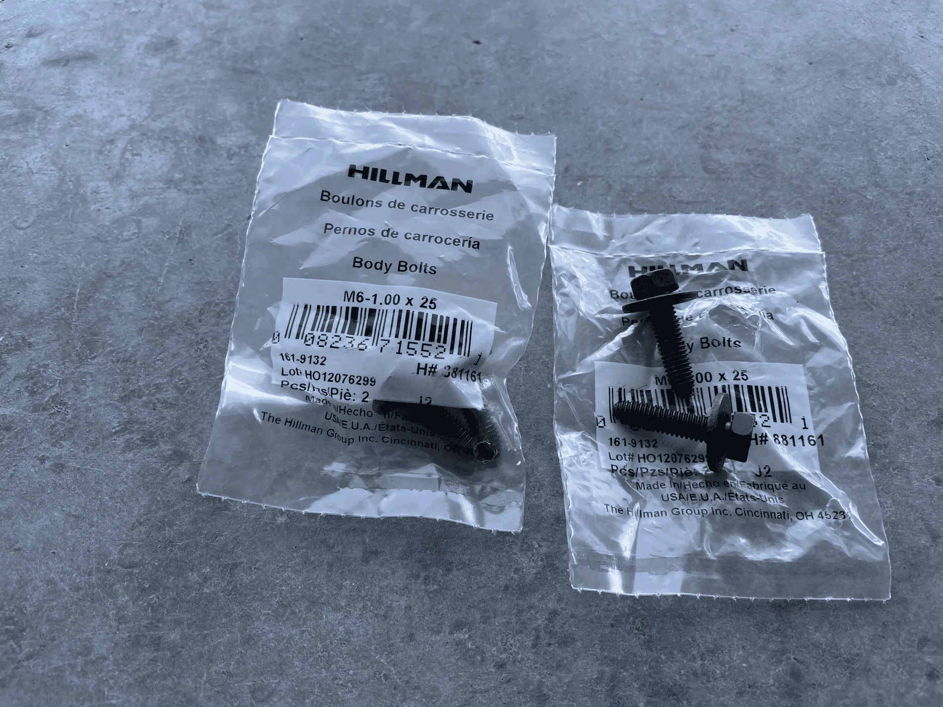

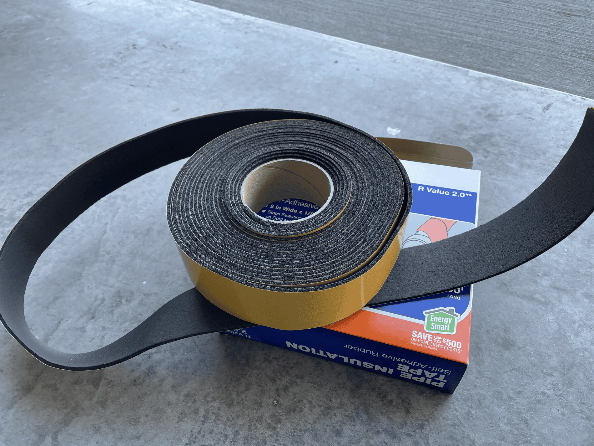

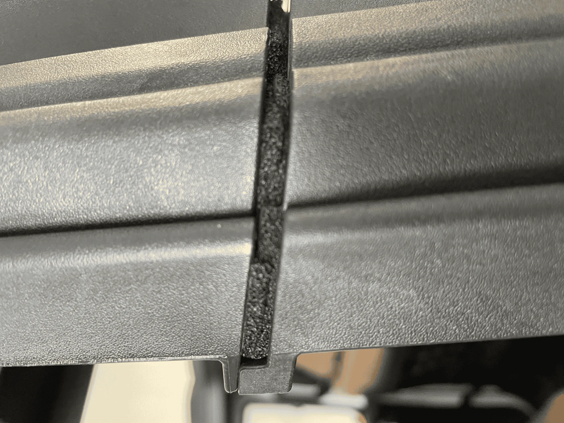

**Since Jeep will not provide the $10 of missing components (for my $63,000 purchase), I guess I will be shopping the local hardware stores for 4 compatible bolts and washers, and also trying to find a piece of rubber or foam which I can cut to fit and attach the upper and lower door surrounds. Does anyone have any recommendations for material and a template for the seal, and does anyone know which size bolts (length & thread) I should search for at Home Depot? Or, any other recommendations for how to solve the issue?**
