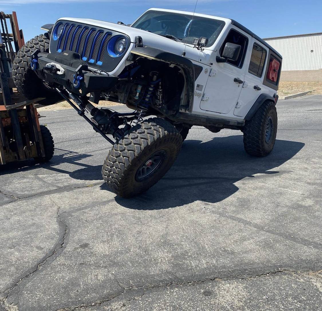

Figured while i was there picking something up why not ?
Lol. Definitely why not. And we all know you already had bumps set, but good excuse to have them pull out the forklift haha
Haha i was actually checking to make sure that new track bar bracket didnt hit the frame and to see if i needed different misalignment spacers on my heim on the knuckle. Hi steer is a pain in the ass. Dont switch from low steer unless absolutely neccesary lol
I will never need to do that :whew: But when you have a 10” lift, well. :LOL:

Maintenance
Is your coilover maxed out in this pic?
No, the front still has an inch or two, the rear is maxxed out. Even outboarding the shocks on the axle super far evos shit tower design the shock still hits the frame, so that holds it up. I can get away with 14” coilover rears easily. Fronts need better upper towers
That’s crazy. Looks great bud. I would think if upper towers poked out too much, tire would hit when fully stuffed. But that is only a guess on my part since I have never even seen one in person. Hahaha
Yeah you right they could hit with less offset wheels and skinnier axles.
