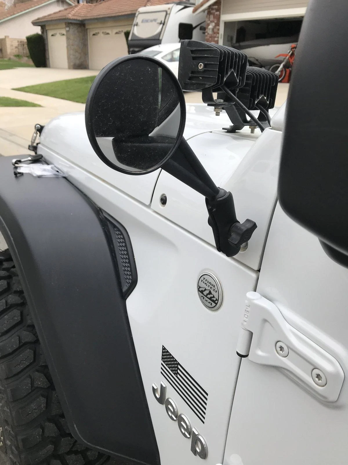

they provide little plastic sticker squares that fully protect the paint, hard to see in pic but it provides a nice thick plastic buffer against body paint
I just received my Lange Coyote mirrors in the mail and when I read the instructions about placing the plastic between the body and the mounting block I instantly had second thoughts about installing these mirrors. Does the plastic truly protect the paint? I'm worried that if the mounting block gets lose or vibrates it might scuff the paint even with the plastic protector in place. My Jeep is still on order so I can't see exactly how the mounting block lines up with Jeep to judge for myself if the mount is likely to damage the paint or not. Hoping to get thoughts from any Lange Coyote owners. Thanks!

If you are worried about the hard plastic spacer, use it as a template to trace and cut out a small piece of rubber or thin foam to go between the mount and your paint.
To help keep the bolt tight, pick up some Purple Loctite, it a low strength thread locker that is perfect for accessories. Strong enough to lock the fasteners tight, but mellow enough that you can remove the fasteners fairly easy. It is designed for small fasteners (under 1/4"), but works on larger fasteners too.

You won’t have anything to worry about. It’s paint protection film. In fact I think it creates extra friction that if anything helps keep the mounts more stable. I’ve never had any rattle or movement at all since installing and those mirrors have spent many hours at highway speeds. Rock solid. I know there are other great mirror options too, but I love these. Can’t wait for the weather to improve and get the doors off again!

Thank you Jocko and Tech Tim. Looks like I should have no problems with the Coyote mirrors.

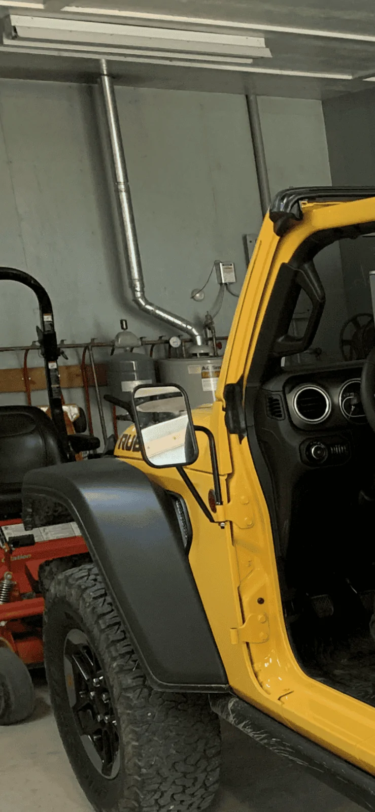

I have these mirrors on my JL right now. They shake like crazy and tend to pivot back into the body at freeway speeds, especially when passing 18 wheelers. They aren’t bad around town, though.

I agree, they do shake too much at speed to be very useful. Mine didn't pivot, but I haven't used them since I got my tazer and used the feature that switches on the rear camera with my blinkers (or just leave the rear camera on screen while doorless).
