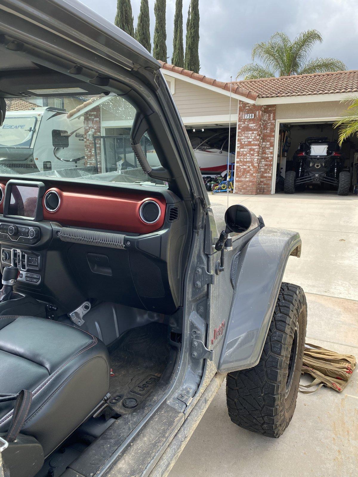

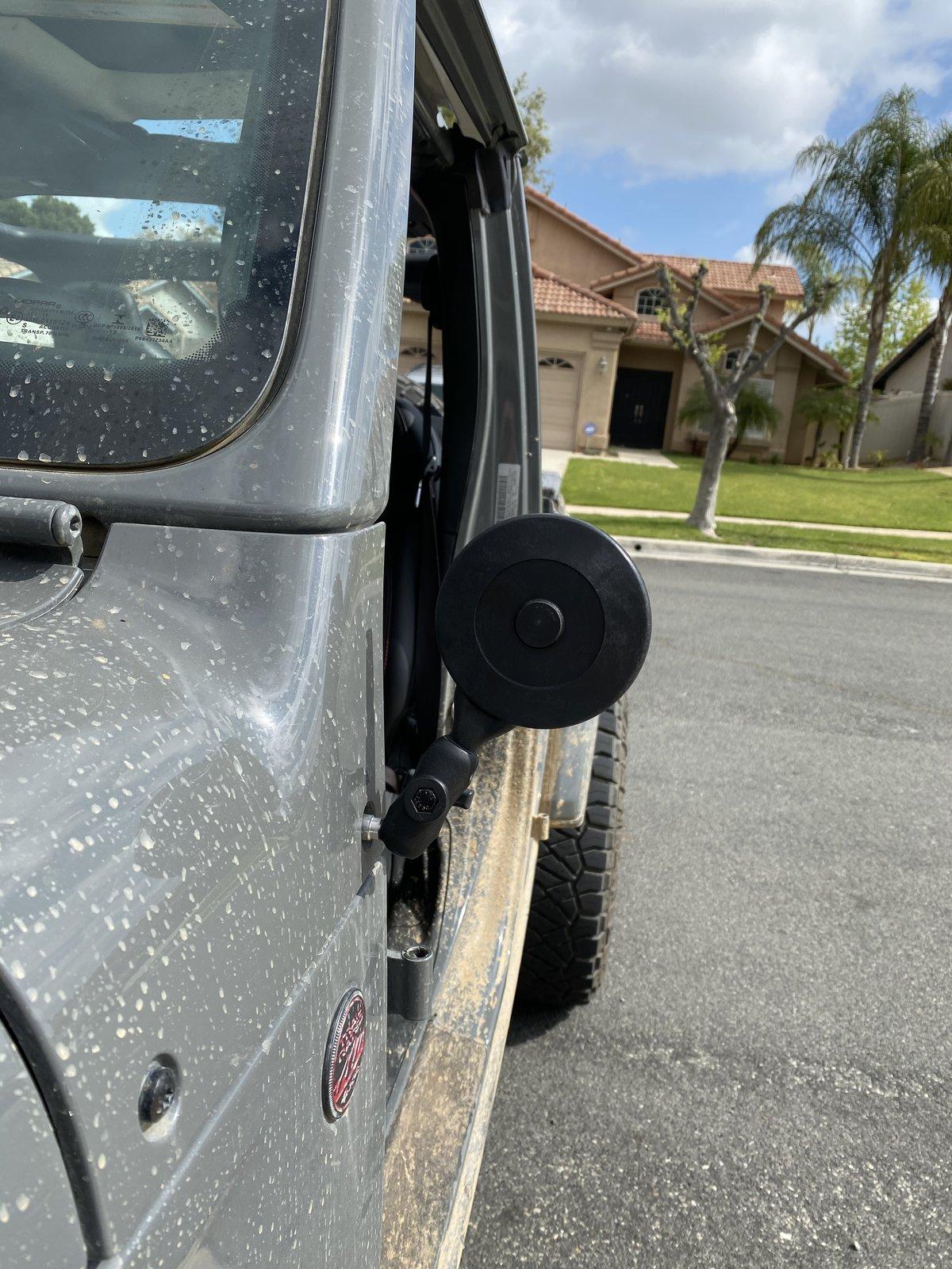

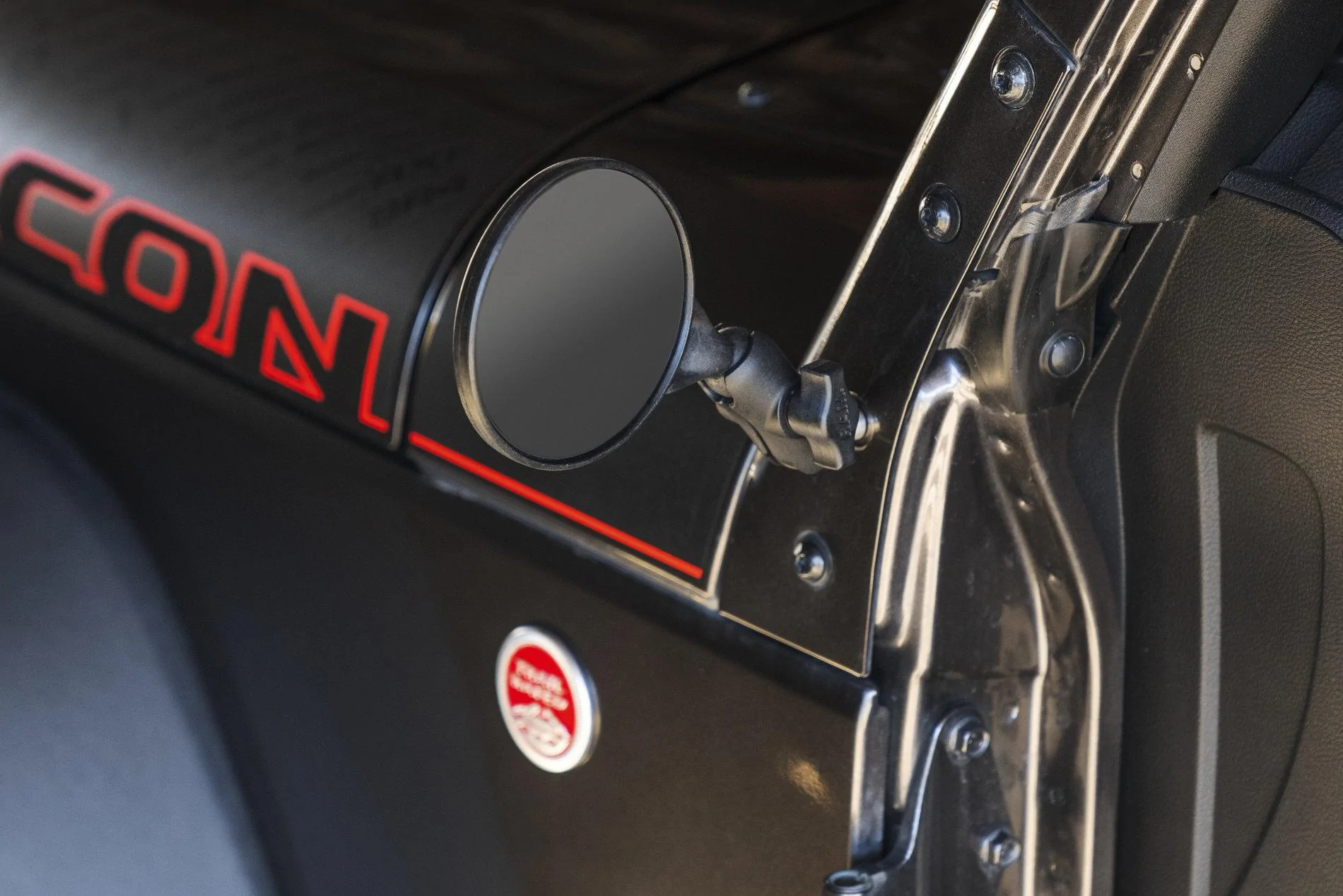

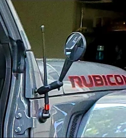

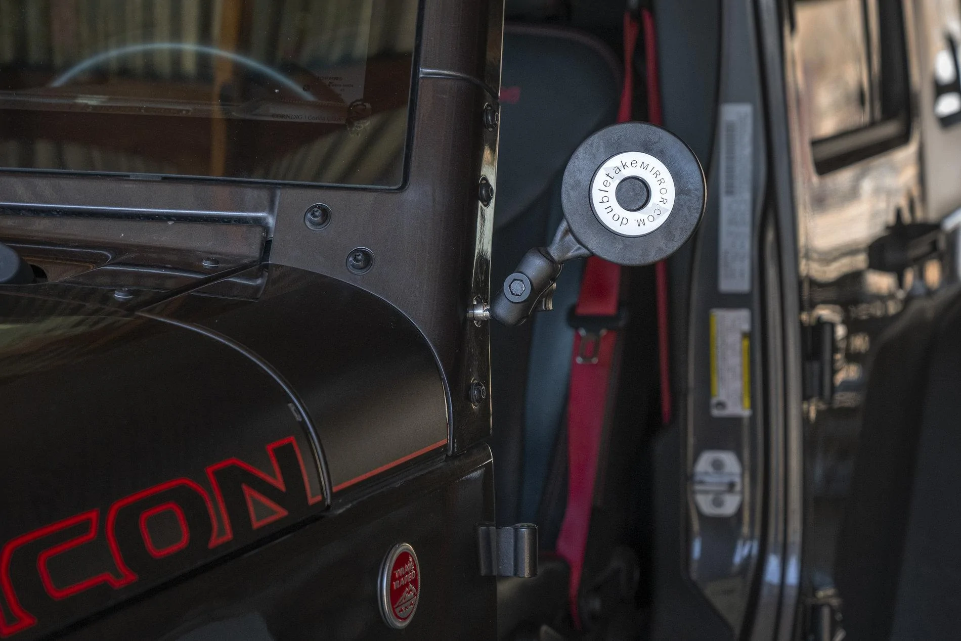

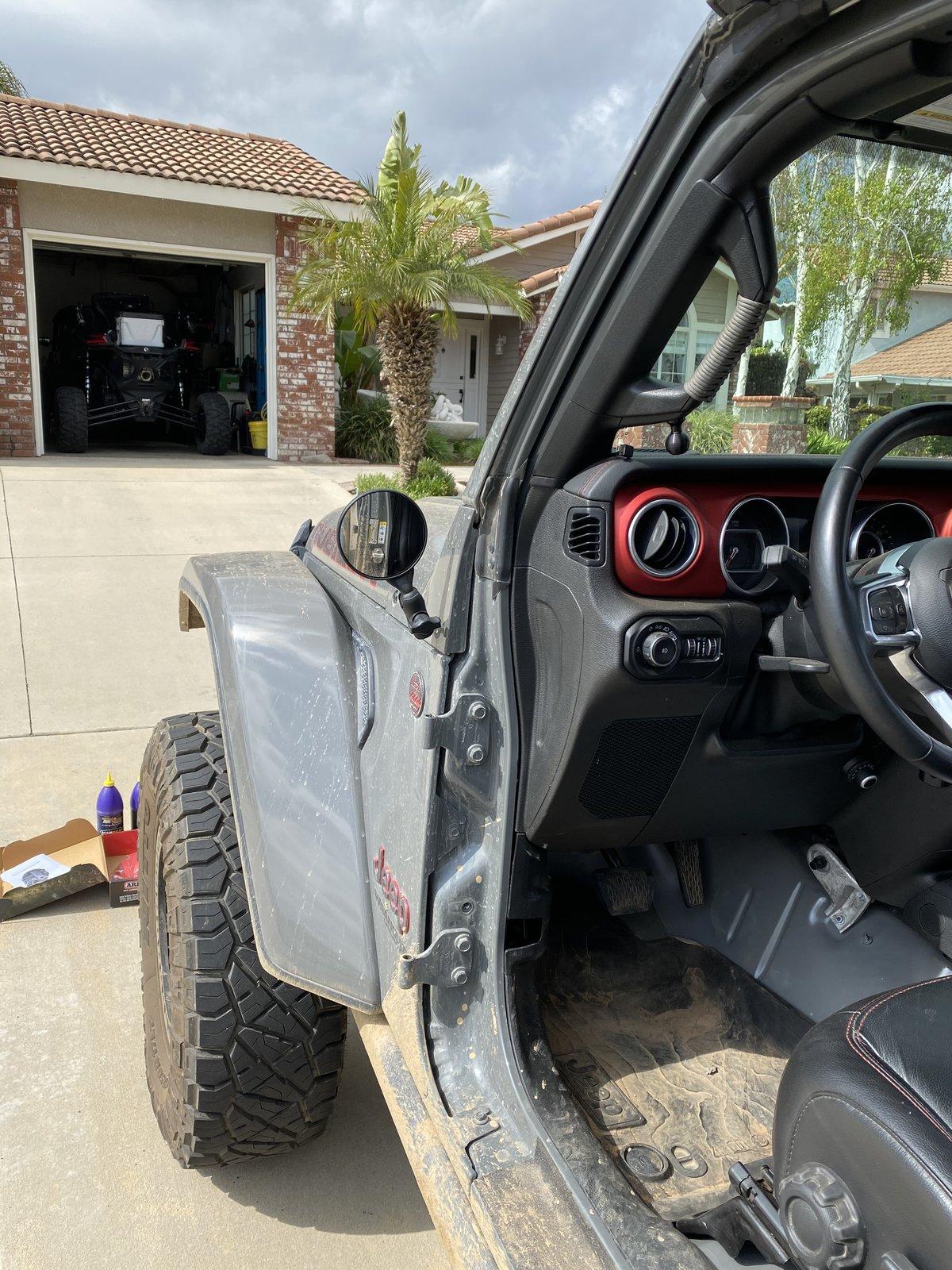

Alright so I posted this before in the doorless mirrors one, this is another option for people running doorless, and need some mirrors. They are relatively cheap and having the ram ball on the outside poses useful for other things.
They have a new style, either coming out or already out, they sent me these for testing and feedback. The new design is a shorter arm design. I really like the looks of them and they work well with the 2” short arm on the drivers side.
However the passenger side needs about a 6” ram arm to be able to see, and I relayed this to them. Possibly different for a jk because there are spots to mount the mirrors up higher than on the jl. With the mirror being a shorter design it really helps with the stability of them. No noticeable vibration at highways speeds.
Ill post the video I did of the original ones and include pictures of the new mirror style on the JL as well as on the JK. Ill also post the link to the jeep section of their webpage. Hopefully they will update it with the new mirrors soon, if not can always call them and see if they are available yet. They are calling them the “Scrambler” mirror.
