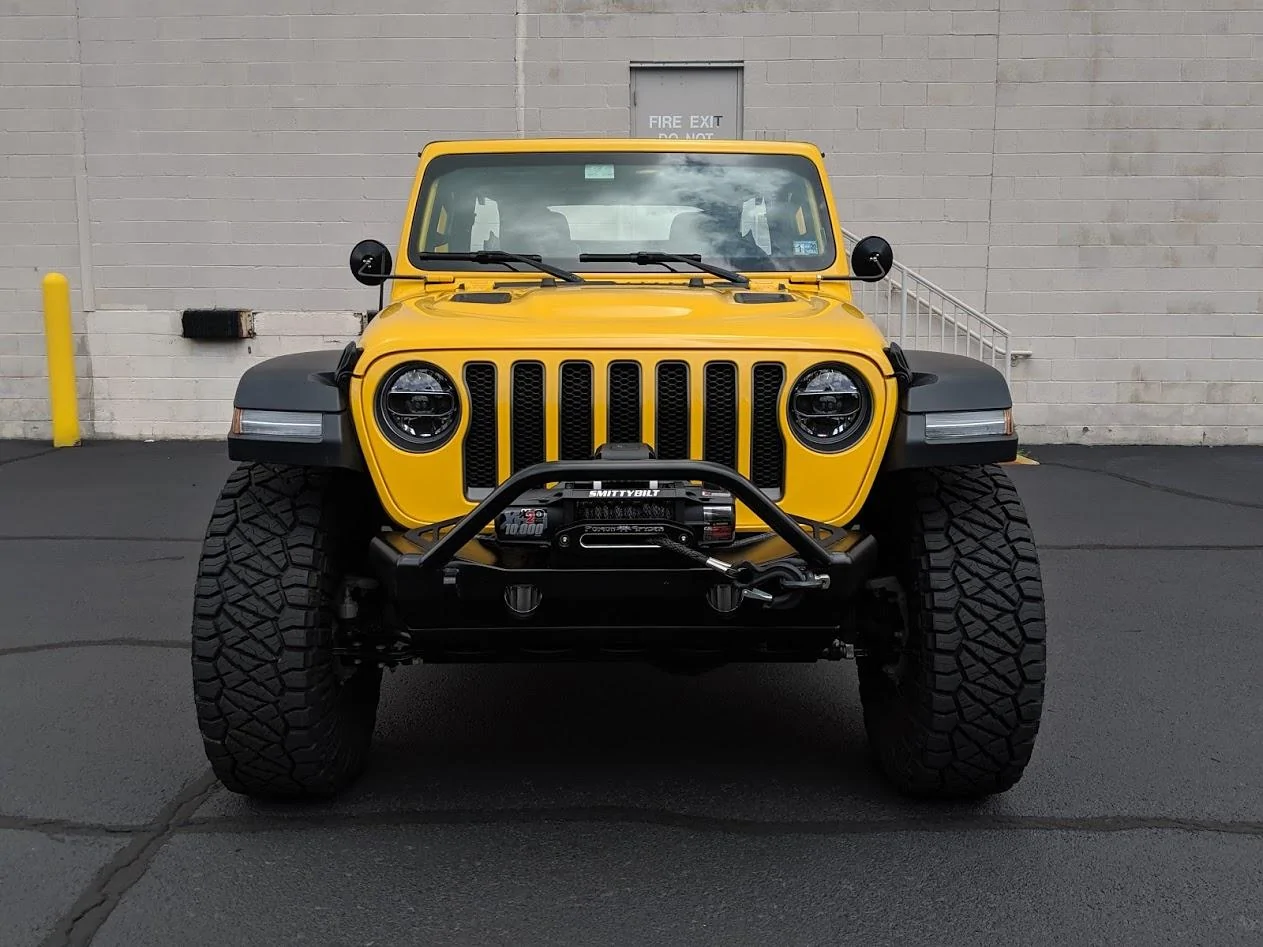

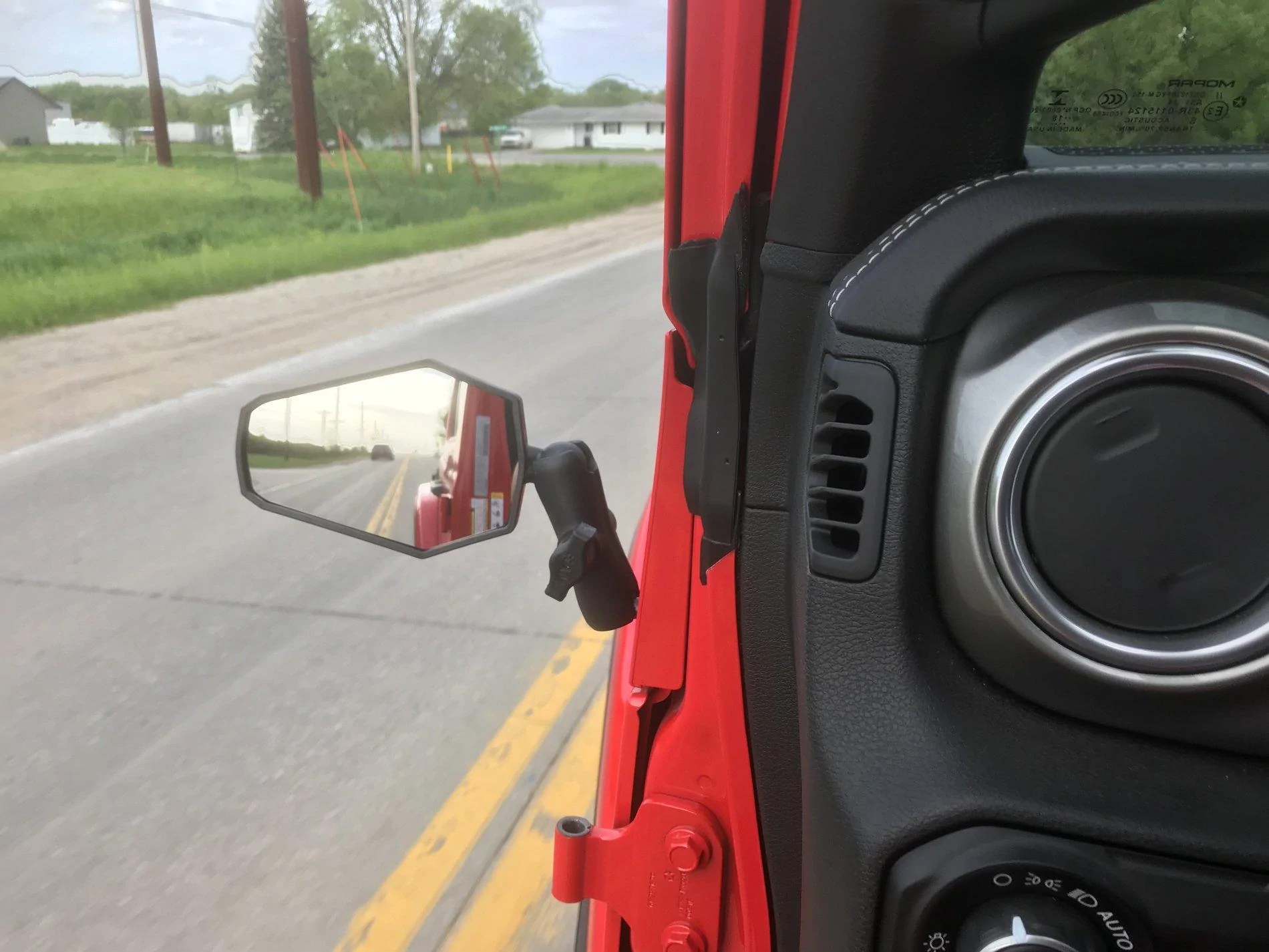

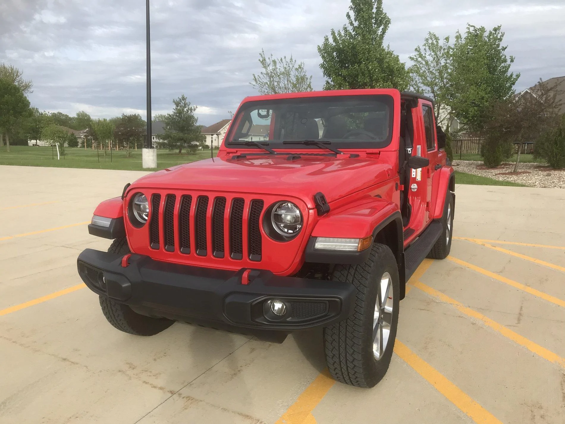

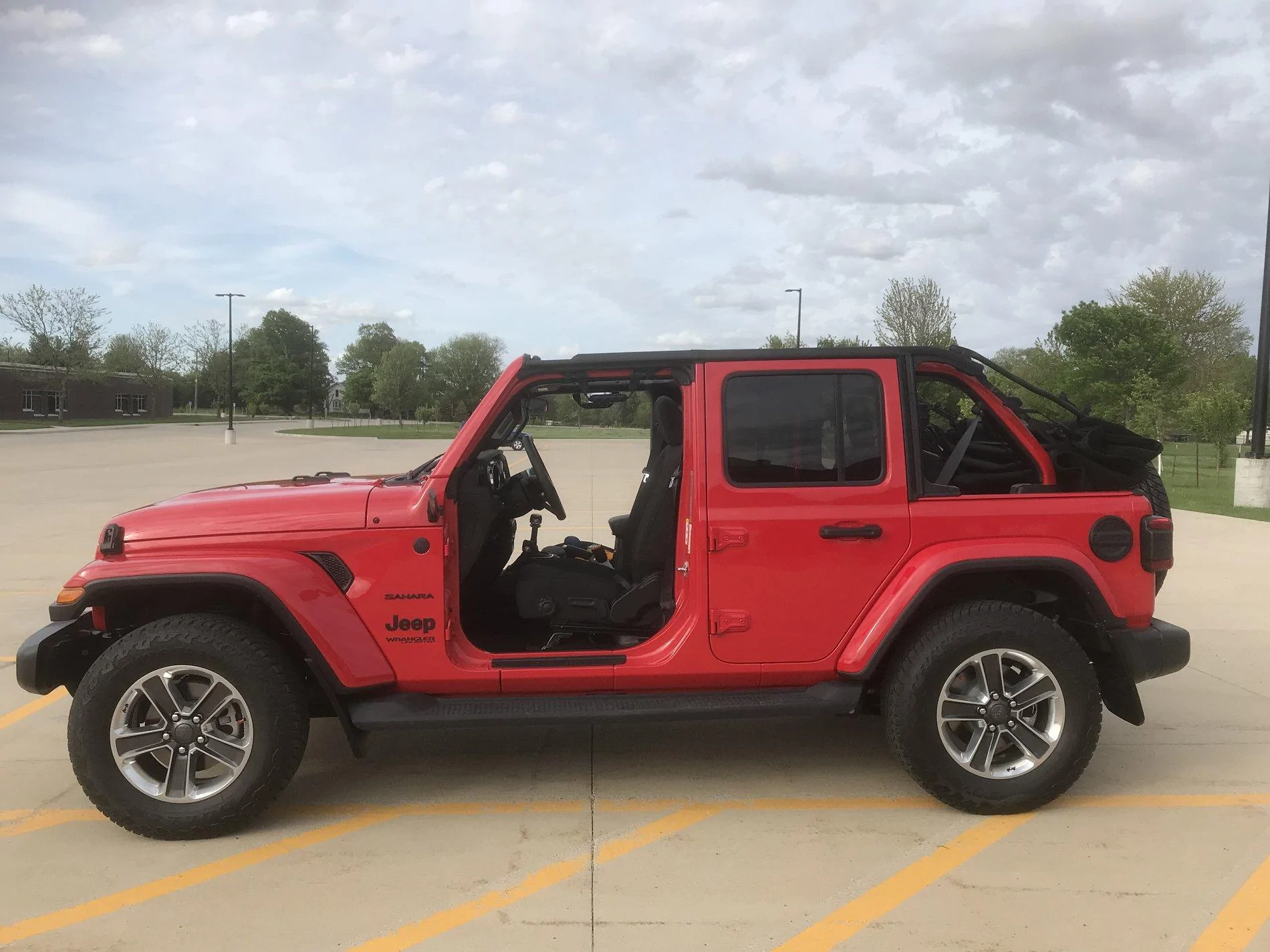

Worked like a charm! I love the new setup. Hardly any vibration at all! I love this solution. I think the Adventure mirrors are a cool shape too.
Finally. Weather that cooperated today in Iowa. 75 and sun. Got Wruby half-naked. Wife doesn’t like it when I take the back doors off with the kids riding. So I sneak it in sometimes... lol

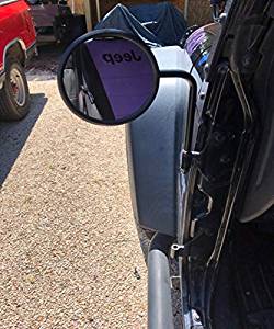

^ those appear to be single hinge mounts, similar to many others, as is typical. The consensus on these is that they vibrate, wobble, and worse - they move or swing inward when driving at speed. My advice - skip these and go for something more secure and stable. A few other options. Refer to prior pages in this thread.

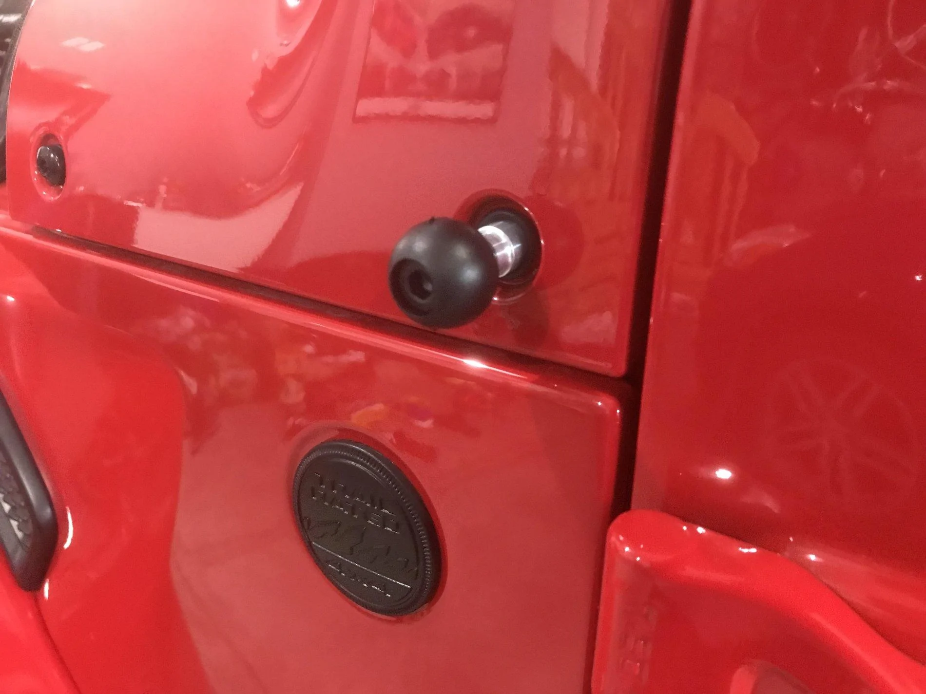

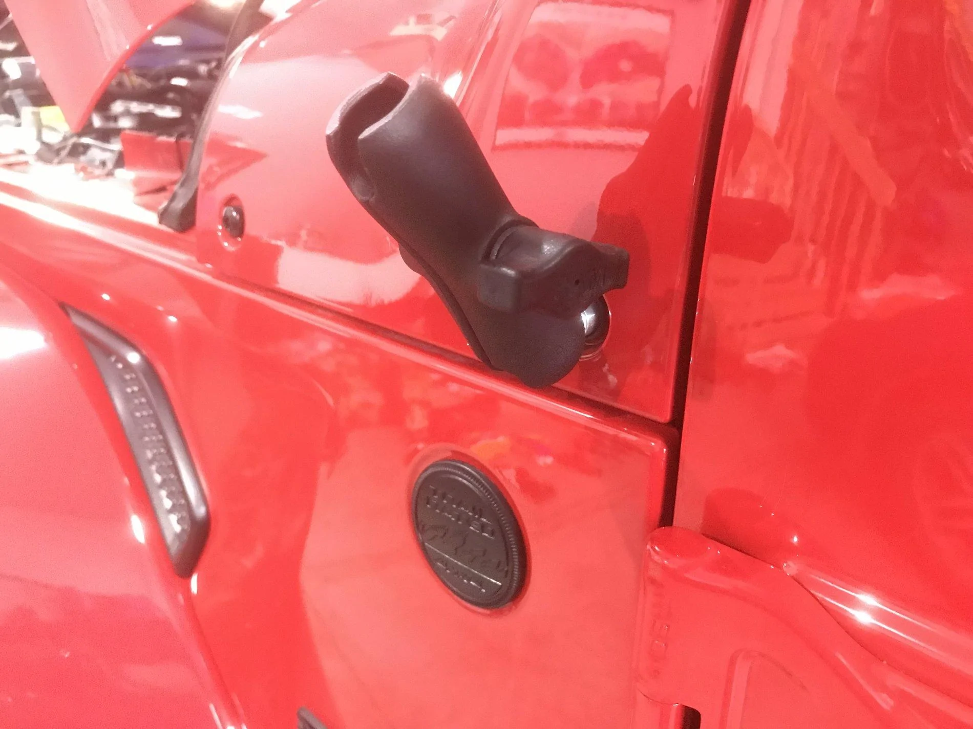

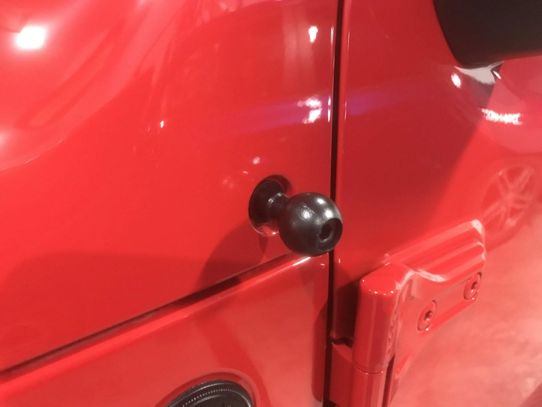

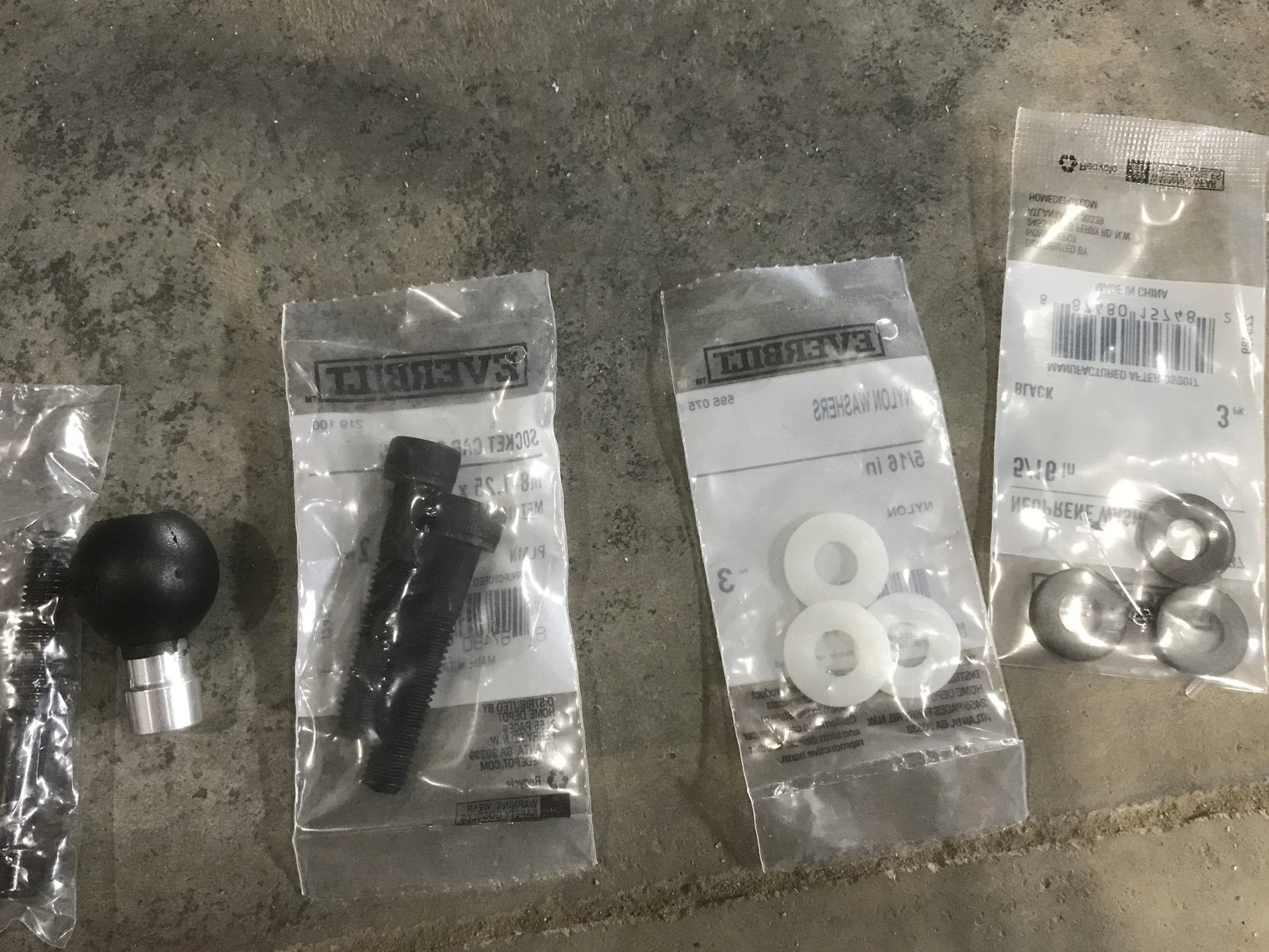

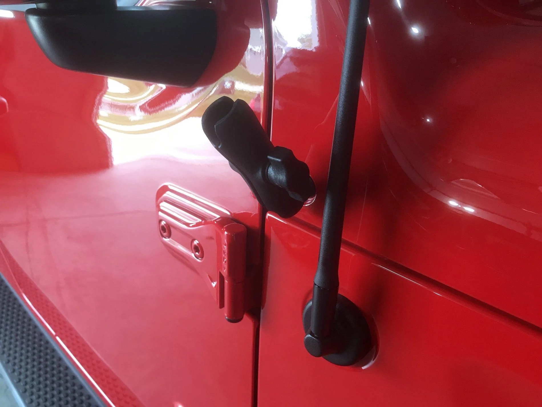

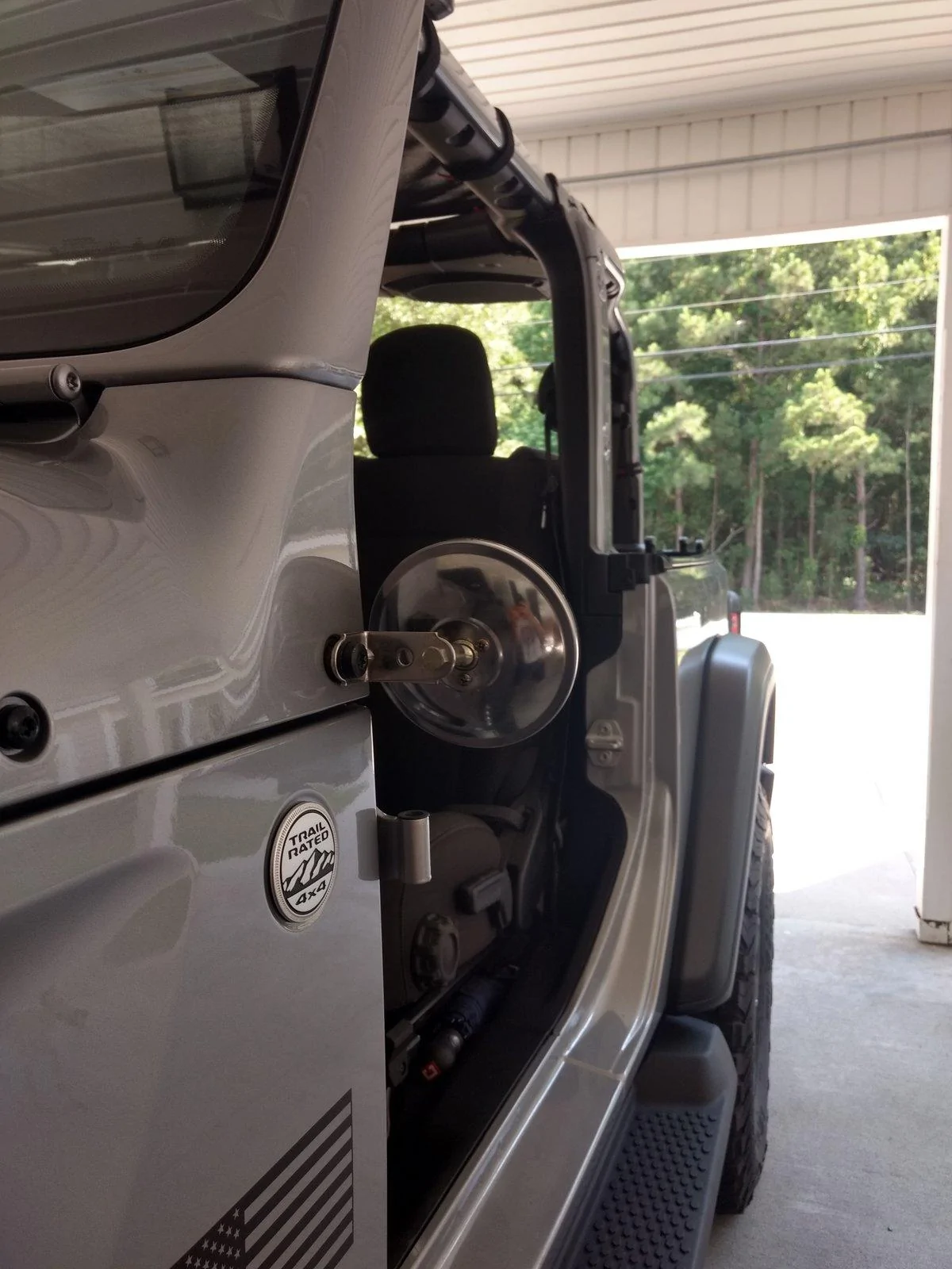

My DoubleTake mirrors don’t arrive till Monday, but I got the RAM ball and arm installed already. Went to Home Depot to get shorter M8 bolts and washers.
Then I decided the exposed chrome on the RAM ball stem needed to be black so I dipped it. Much better.
Great idea to do it this way..... can you maybe post a part's list on here as I am sure a lot of us would be interested!

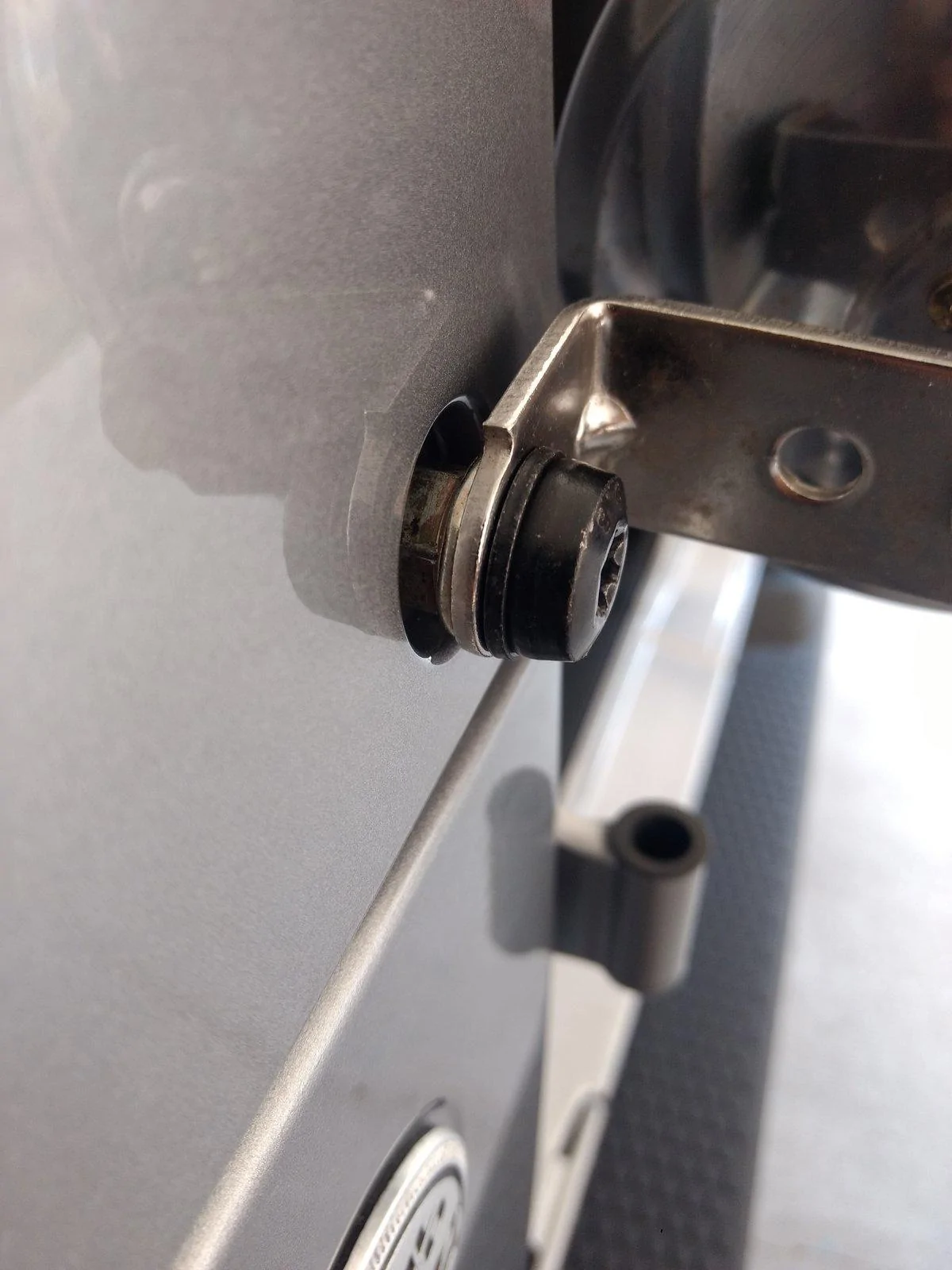

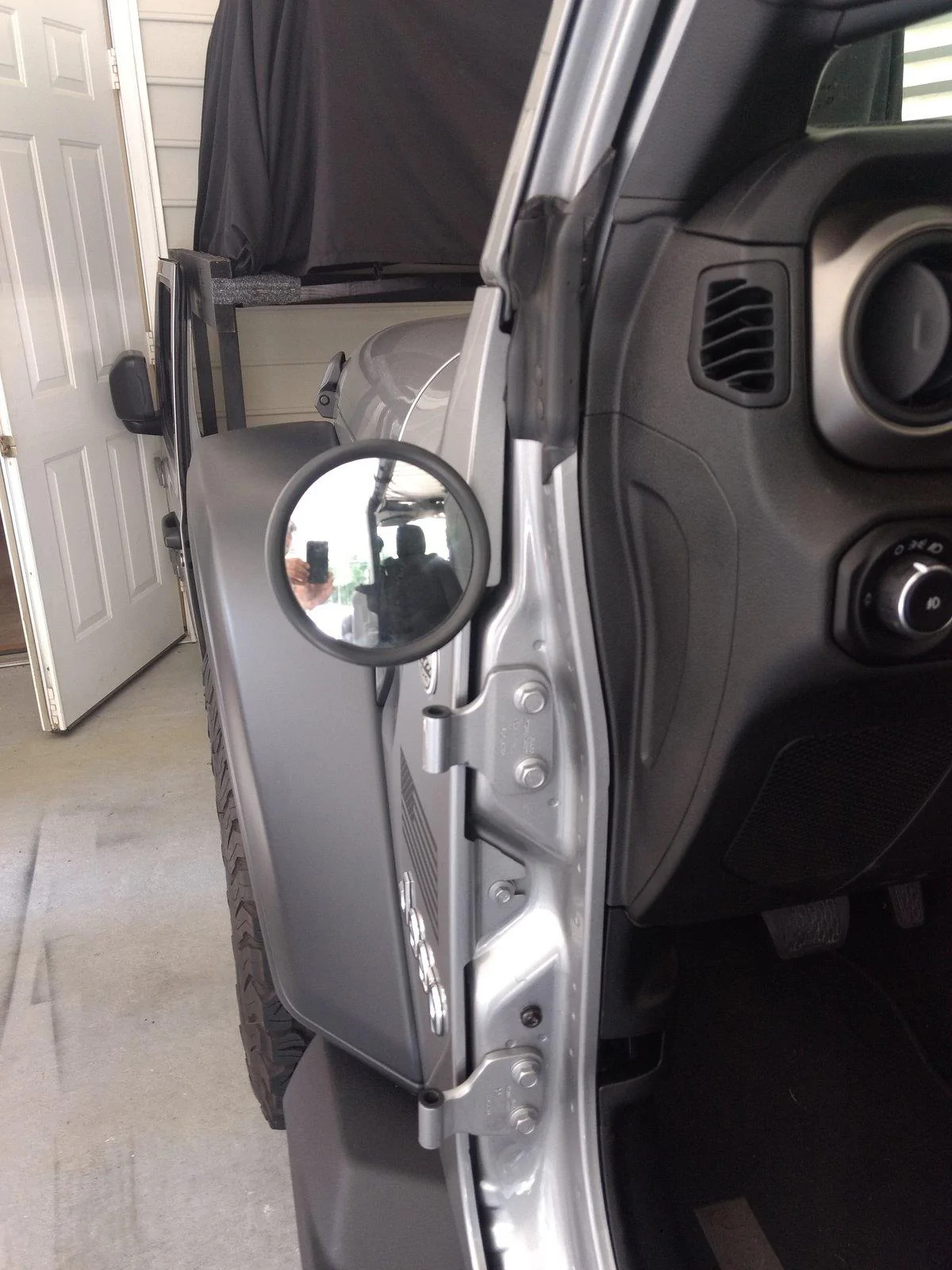

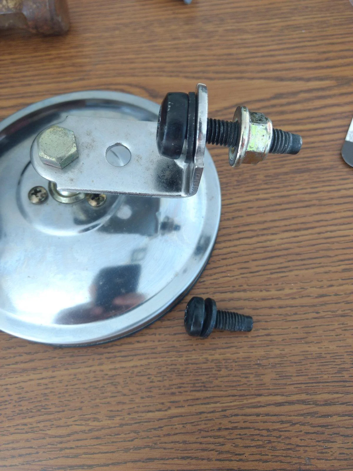

Heres an old golf cart mirror I had laying around that I put to good use, Removed the cowl bolt closest to the door and found one of my hard top bolts fit and was long enough to use a spacer between the cowl and the L bracket on the mirror, then I used a nut I found that was the perfect size. Its solid, no vibration and it doesnt move. Standard 5" mirror that probably could be found for less than $20.
I put the parts list in the description
Great idea! I love the simplicity. Our Jeeps are just so versatile and customizable, anything works.
What are you doing for the passenger side though? You might need a longer arm

right now just going with the single mirror, honestly I was ok with no mirrors but since I had this im glad I was able to use it......I must admit it is nice to have it there to keep an eye on that blind spot
