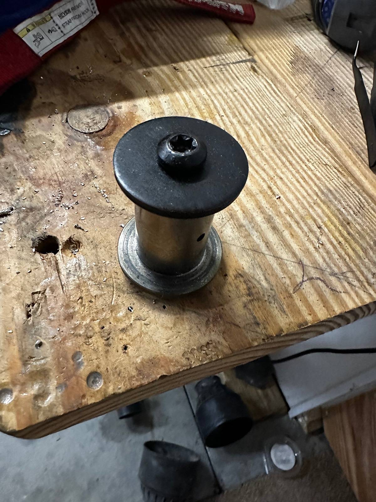

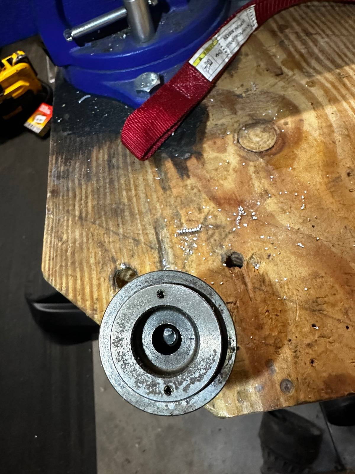

The timing chain has to come off to get the heads off, so timing chain. Once you are there the oil pump is also attached to the timing chain. At this point, might as well rebuild it. But, I hope you have better luck than I did. I rebuilt my JK 3.6 during the china virus so parts were hard to find. I ended up buying a complete rebuild kit, including the timing chain set, water pump, oil pump, lifters, gaskets, bearings, etc. for $500. A name brand timing chain set is about $400 by itself. Once it was back together, it wouldn’t start. The bolt holding the timing chain idler pulley broke. I tore the engine down again and replaced the bolt and triple checked that it was torqued properly. The jeep ran great for about 200 miles before that same bolt loosened up and ended up stripping the block. Moral of the story, use quality parts and avoid eBay. My only guess is that the timing chain wasn’t to spec. I ended up buying an engine with 31,000 miles for $4k.

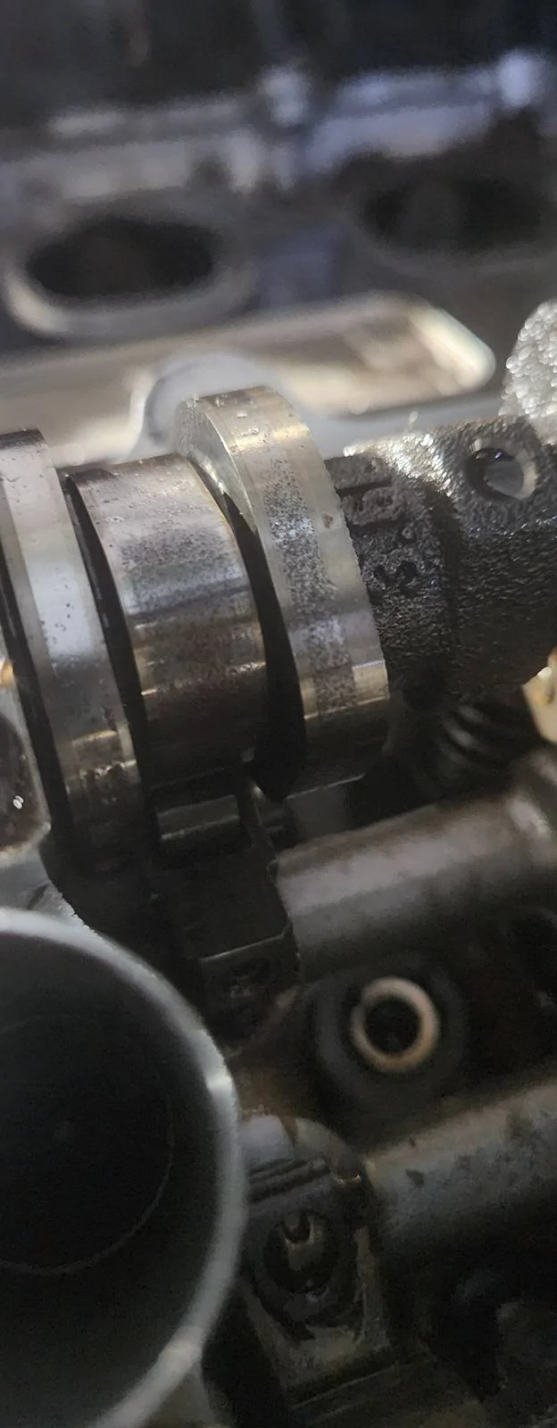

A little late with my update. After pulling valve covers and seeing scored cams I was not in the best of spirits. Engine got much hotter than first thought.
The lower intake is slightly melted strike 1
The cams are bad strike 2.
Too many miles not necessarily strike 3 but why not start over at this point.
Ordering a new complete engine includes everything with not enough miles to burn 1/4 tank of gas on the odometer. It's not the cheapest route, but best for longevity hopefully.

CarbonSteel
Jul 21, 2019
305
5,795
8,238
Make sure the heads or block are not cracked as well. A number of us on the forum have experienced it. High operating temps and 11:1 compression is a good recipe for either.

Service
That engine is smoked, not even a viable core imo. Replace the complete assembly.
