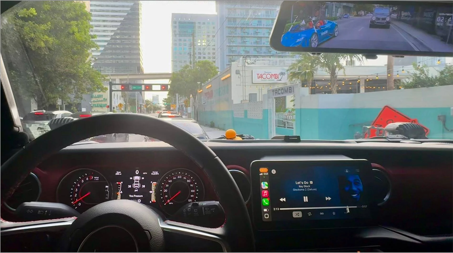

I installed the Wolfbox since with 37's my view wasn't very good. I got the hardwire kit and used fuse F52 ( Cig lighter) for the ACC and fuse F45 for the Constant power - just grounded to the bolt by the fuse box. I ran the wires to the passenger side - you just have to unbolt the pass side visor and run them down the a pillar .. wolfbox has an easy video to follow.
