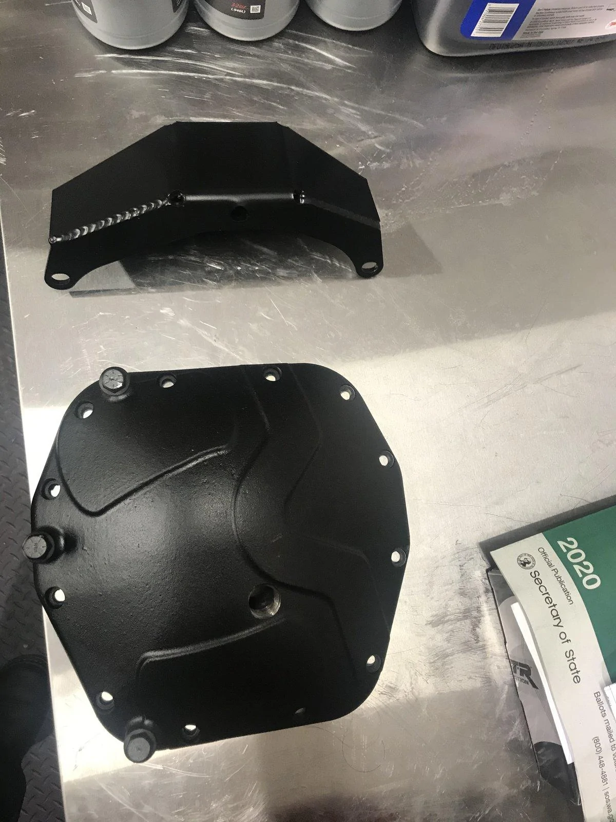

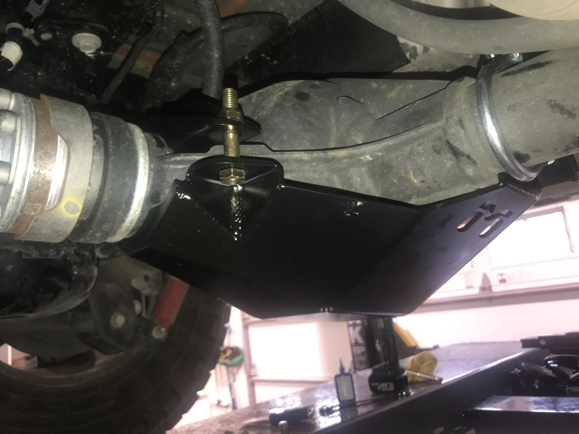

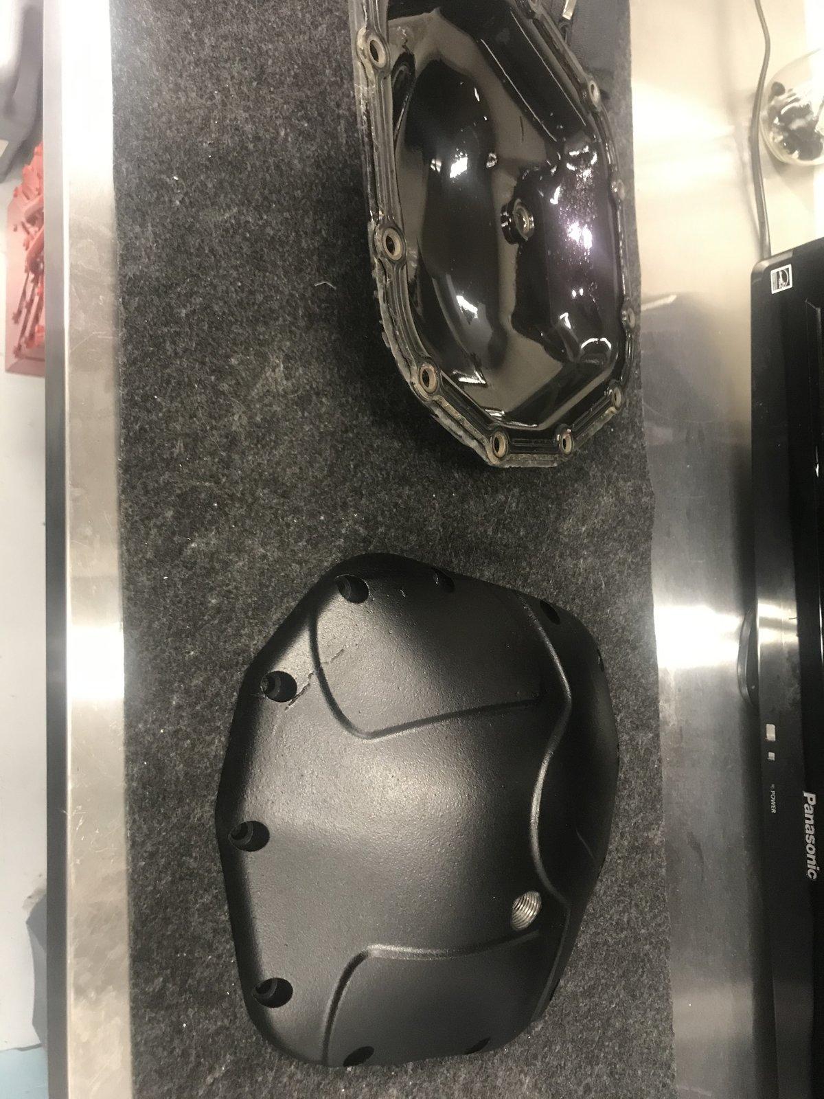

I bought the Metal Cloak. Mostly because I wanted a decent diff skid plate, front and rear. The metal cloak diff cover is cast iron, weighs a #$&@ ton. It’s like the Chuck Norris of diff covers.l If I accidentally back up into a rock, I feel sorry for the rock.
the skid plate for the rear will fit a range of diff covers but the skid plate for the front diff will only fit the Metal Cloak diff cover.
so that is what I bought. Price was 330ish for both covers and skid plates. Only bummer is I have to paint the diff cover as they come unfinished.

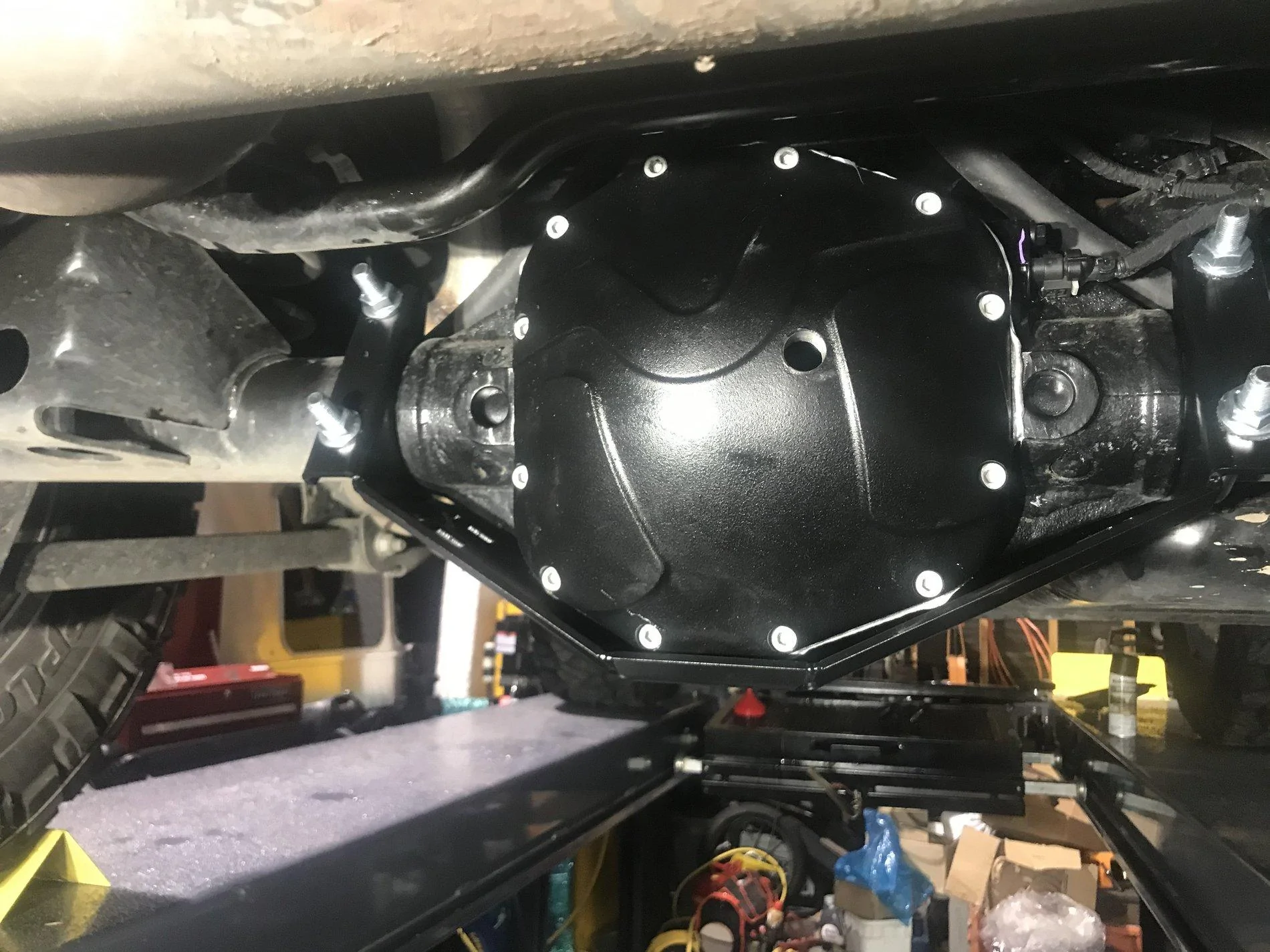

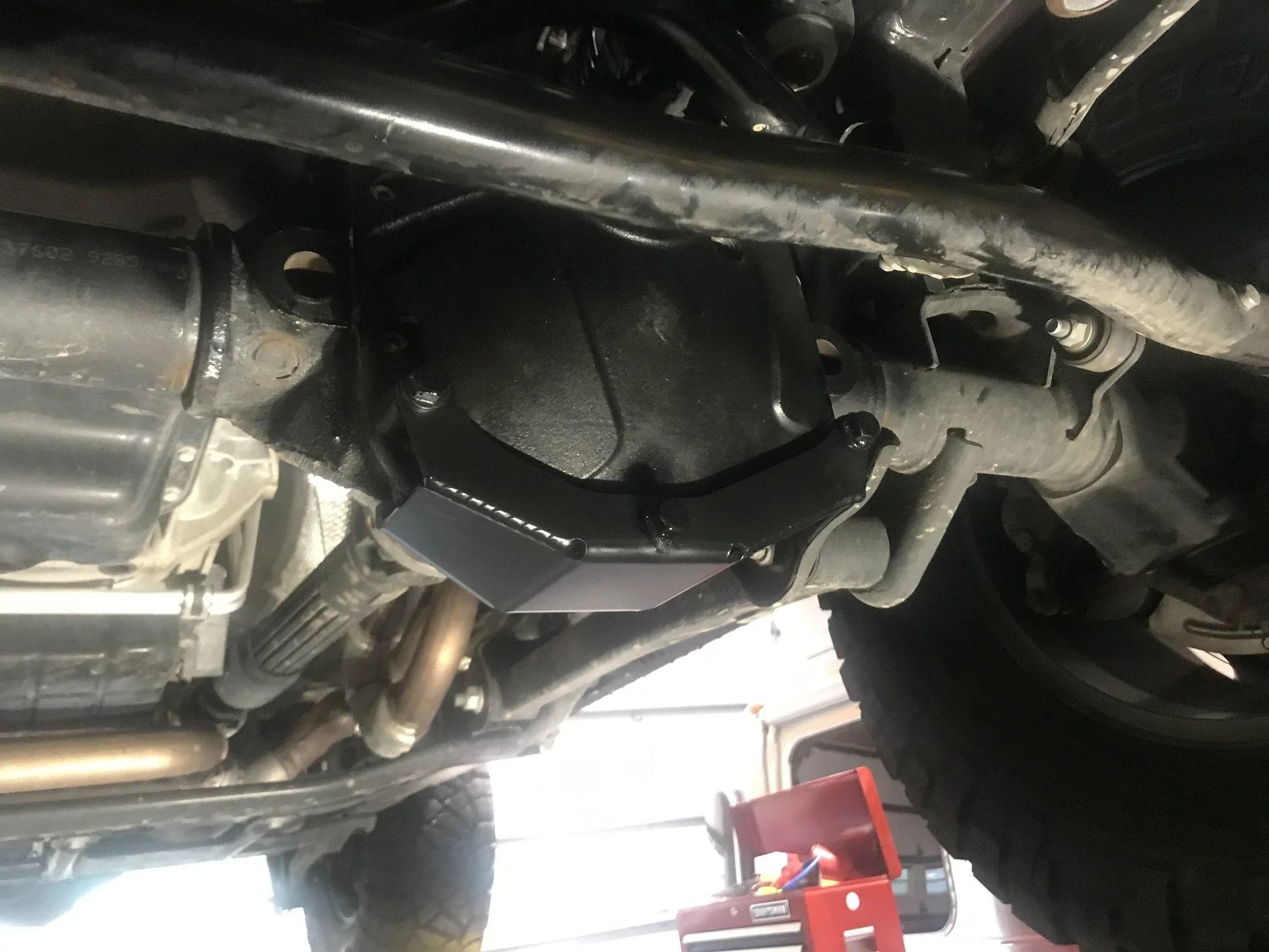

I had the Metal Cloak diff skid plates powder coated black because the zinc finish is too shiny, and I spray painted the diff covers textured black. Installed today, rear was a piece of cake and front slightly less easy as the top four bolts are somewhat harder to get to given the track bar being in the way.
I am very impressed by their quality. The diff covers are impressively thick. Again, I feel sorry for the rock that hits them.
