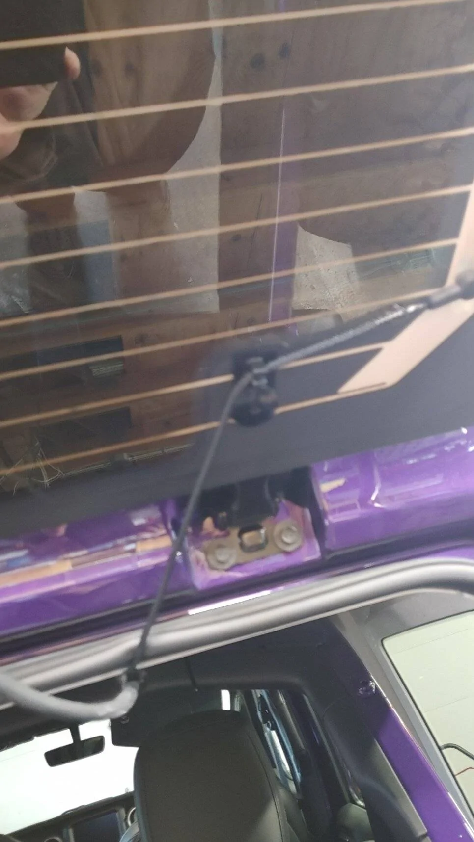

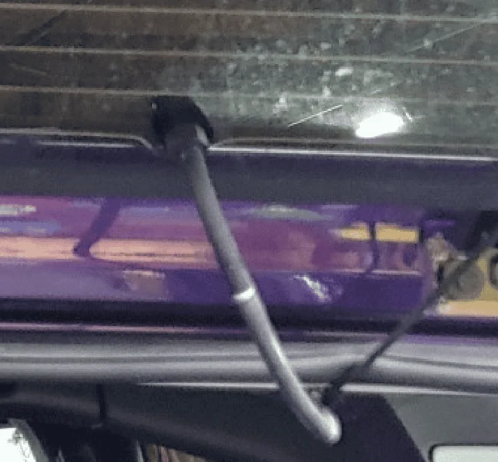

I just noticed this hanging wire on the passenger side near the rear window defroster. It looks like it broke loose from rear window defroster border. Any idea how I could reattach it?

When mine came loose like that I just popped the button out of the connector and held the button against the glass with pliers. I then pressed against the button with my soldering iron and pulled the trigger and watched for the solder to melt, when it did I released the trigger and kept the pressure on the button until it cooled. Popped the connector back on and done.

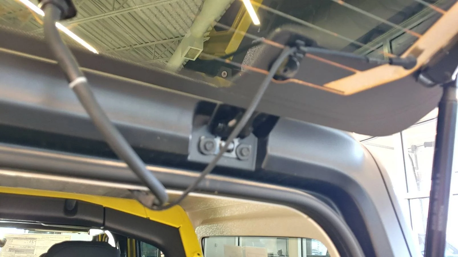

The post is soldered to the grid, then the grid applied to the glass. Nothing really special or different. It's been done that way for years. They don't apply a grid and then solder the post on.
I've found that the wires on these are greatly stressed because they are TOO TIGHT when you open the glass. I ended up working the wire out a bit on ours to give some slack, otherwise the wire was actually holding the glass from going all the way up by a good inch!!
Ours was so tight it compressed the window seal when the glass was up, so I worked and worked and got some more wire from above the headliner to at least make it so the seal wasn't compressed.
Literally, when we got it, the glass didn't go all the way up - that means the pressure of those lift cylinders was pulling on that wire!!
Before (this is what causes at least some of those to bust loose!) ->

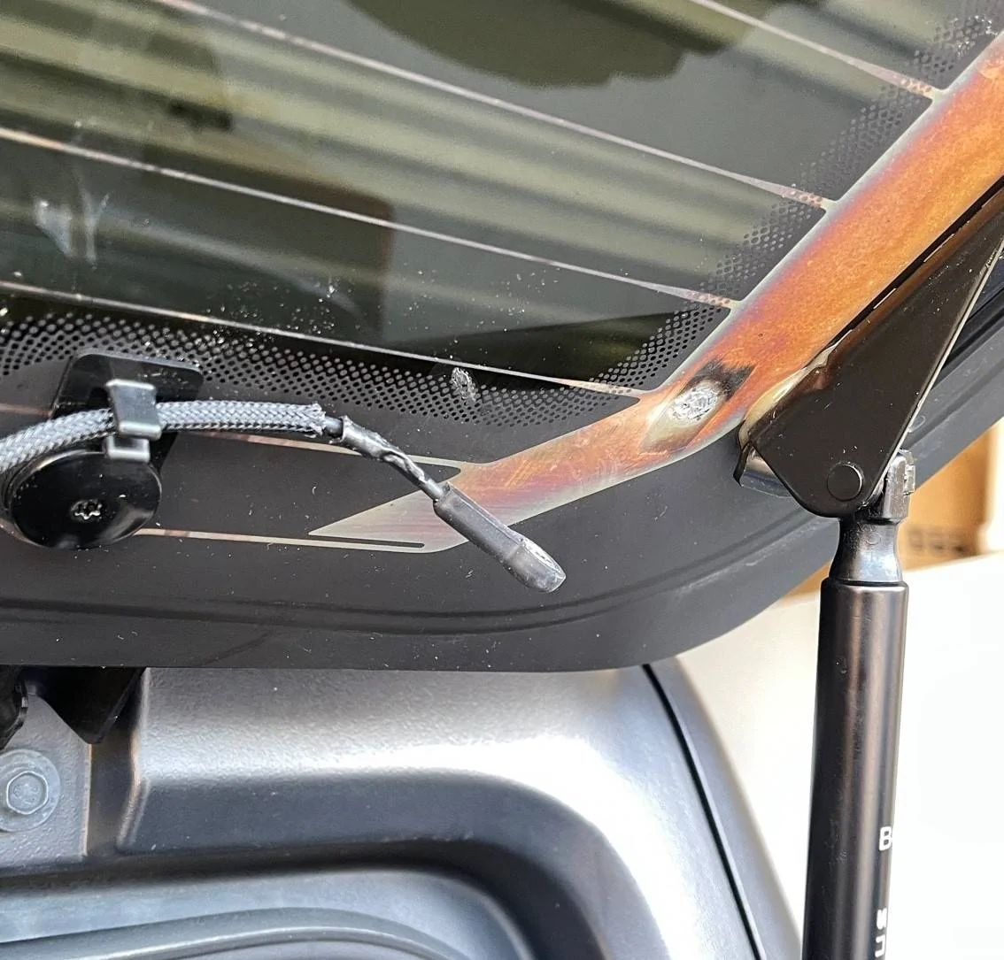

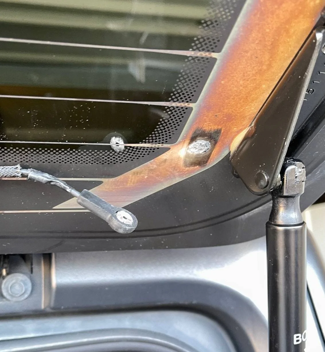

After (this example is not ours, but this is what ours looks like after I looked at this one and pulled the wire to give it some slack) ->
