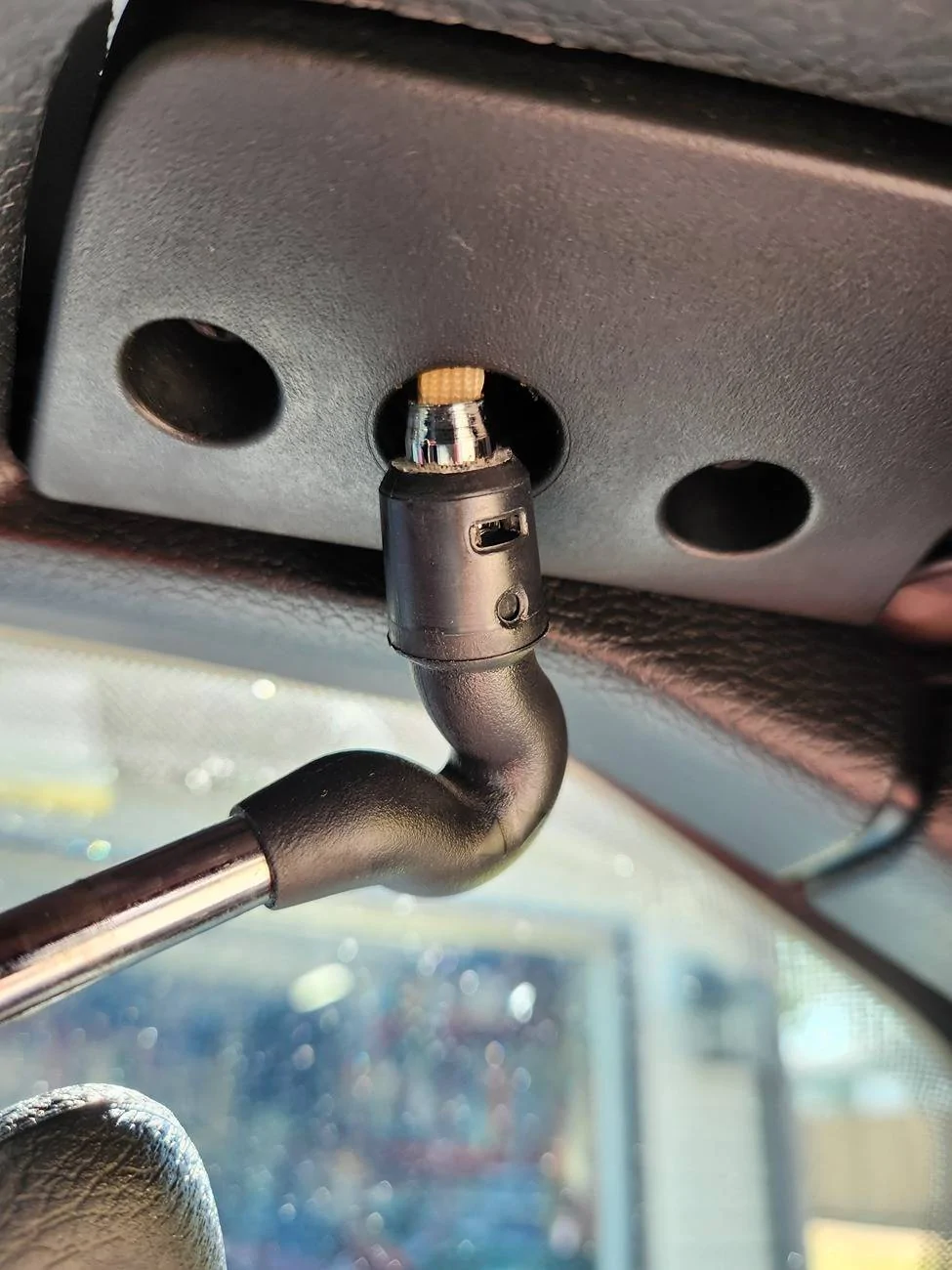

Has anyone had their visor shade break and come out of the roof frame? I had a passenger who went to swivel the shade to the side and it appears the piece that should swivel broke. I cant really see up in there to tell what I'm dealing with. Just wondering if this has happened to others so I can gage what I might be in for to repair. Thanks!

Search (an online store for) Jeep Visor Repair kit. I think more ppl have experienced this than haven't. Easy fix, just a few bucks, and lots of options. Do the driver's side, too -- they also work as a preventative measure

If you are under warranty, make them replace it. I'm still pissed off they didn't change the design when literally thousands of these have broken. Make them pay.
If it isn't under warranty still, go the bracket route or the retaining clip fix (a little more involved, but doesnt show)

I get your point. I’ll spend $20 rather than deal with the hassle of the dealership or having someone else do a repair I could do myself,
