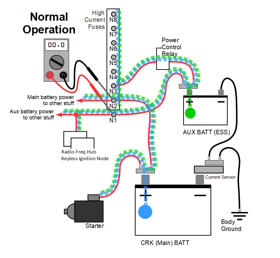

It's far easier IMHO to remove the black cable from the negative post of the Aux battery that , sight unseen, makes its way on to the negative post of the main battery and electric tape up its end in order to remove the Aux battery from powering or being charged by the vehicle.
This is the cable that doesn't at its other end, connect to the body ground.
You still must remove Fuse 42 with the JL Tazer. This is because the Tazer can be programmed to prevent ESS events, but simply because they are off in no way effects the physical connections between the batteries. Pulling Fuse 42 prevents the Power Control Relay (PCR) from ever energizing, which when it does (at cold cranks for an instant and during ESS events) separates the batteries.
With Fuse 42 removed calls for battery power always, all the time, go to all connected batteries, of which you will now only have one, and do so without the vehicle being aware of this change.

This is a great diagram

Let me approach my answer to your question this way:
Visualize the body ground under the hood. This is the pair of bolts just below the hood on the passenger's front panel. From this point a black cable will lead to the negative post of the main battery.
This cable is to be left as is, untouched and connected. It is the other factory cable that is removed from the negative post of the main battery and taped up. This cable has, sight unseen, at its other end the negative post of the Aux battery.
You need not worry about this Aux battery's deletion effecting any aspect of the vehicle but one moot one. That one moot aspect is that it's perhaps best not to run ESS events off of just the main battery, but you're preventing that with the JL Tazer.
Otherwise no power demanding component of the vehicle is denied power by this change but the very Aux battery itself.
Using Jerry's @Jebiruph's picture as a guide (there are people more knowledgeable on this than me) do note that despite the Aux battery no longer making a complete circuit with the vehicle, that the radio frequency hub you reference and express concern over getting power is still connected to the Aux battery's positive terminal and that terminal's other positive cable, which makes its way back to point N3 (on what's called the High Amp Fuse array) which is connected to N2, which is connected to your main battery. So as long as your main battery has power, the radio frequency hub is getting power and does just fine.
