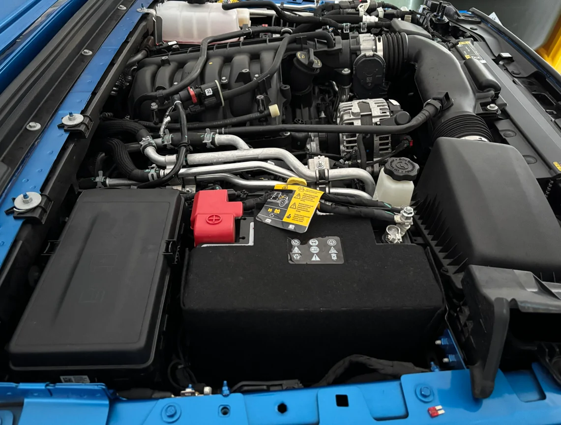

Nothing that has not been covered before, in fact I think half of this forum is related to the aux battery, but because there is so much over complication out on the internet including:
  1. dudes literally RIPPING an entire fender off the side of the Jeep
  2. people cutting rivets off
  3. guys tearing the fuse box all apart
I figured I would add my own post.

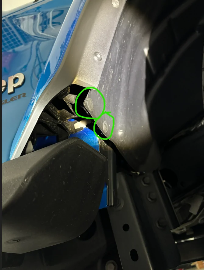

Remove two Christmas tree push pins--carefully for reuse.
Jeep Wrangler JL Deleting (Removing) the Aux Battery 1777322747878-f4

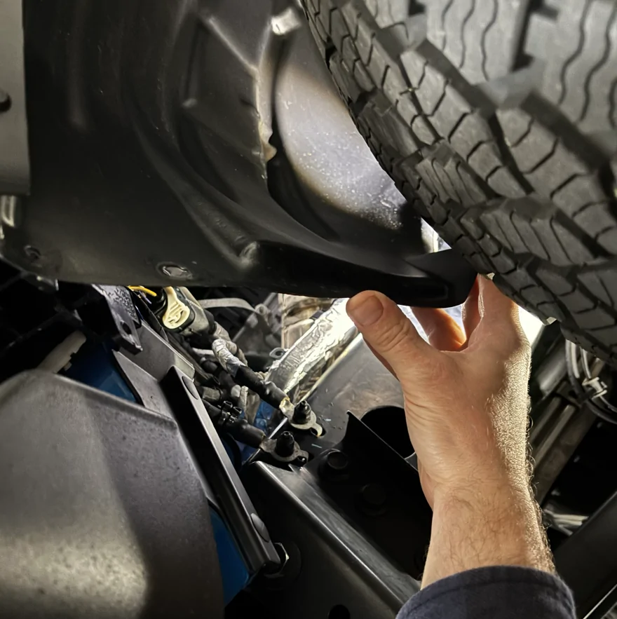

Peel back the curtain
Jeep Wrangler JL Deleting (Removing) the Aux Battery 1777322814368-uv

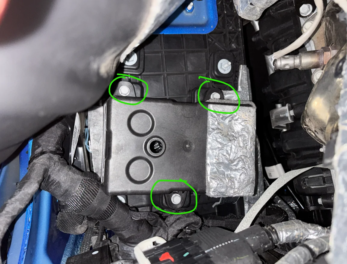

Remove the (3) 10mm bolts. I used a long extension on a small battery impact to get it over with quick without hanging too long.
Jeep Wrangler JL Deleting (Removing) the Aux Battery 1777322943921-z8

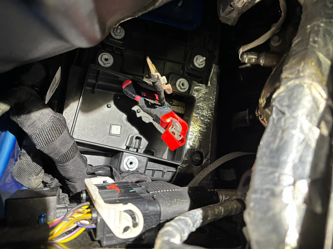

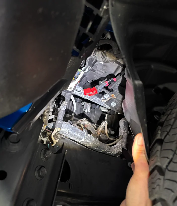

Here is where information was lacking...then what happens? will the battery be hanging by the cables? Can you reach the top to remove them while holding the battery? The answer is its easy. The cables have enough slack the battery will lower down until it rests on the wiring harness / frame rail. With the battery supported by the frame you are free to use both hands to reach up & have enough room to remove the (2) 10mm nuts that secure the cables. I used a 10mm socket on a small 1/4" ratchet, a ratcheting box end wrench would work also; just do not touch both terminals with the tool. The cables were a little "stuck" to the terminals even with the nuts removed but easy enough to wiggle free. Then remove the aux battery down & do not let the exposed cables touch each other.

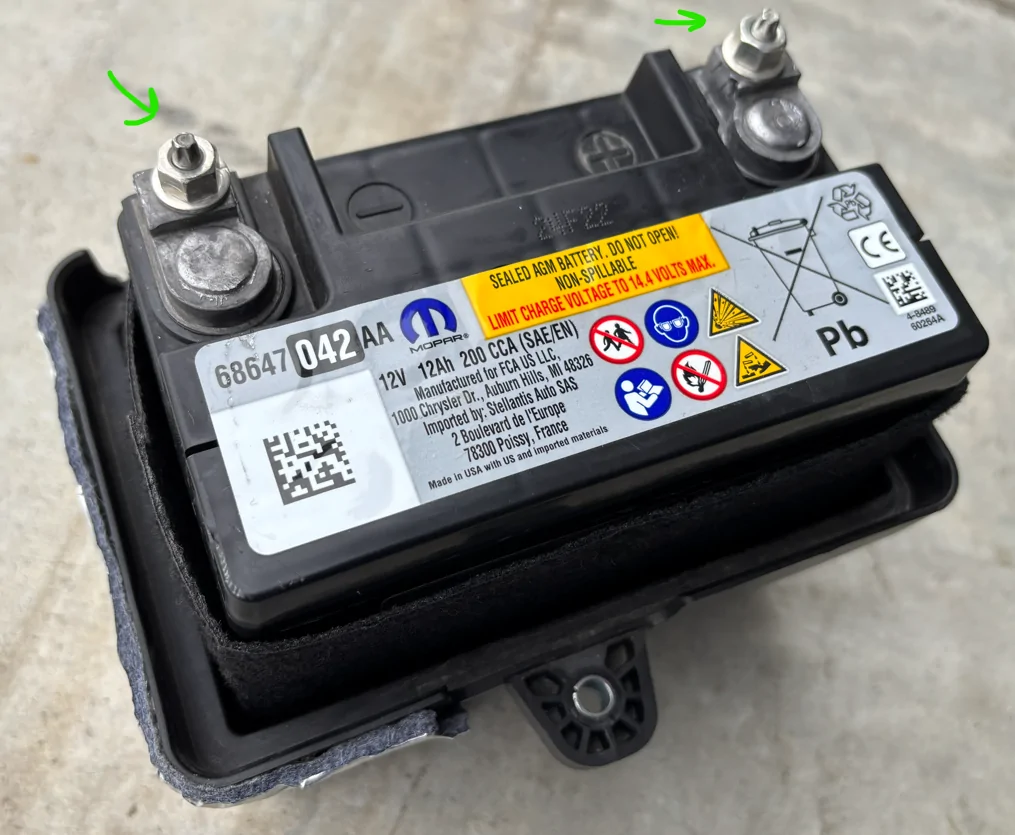

Remove & save those studs & nuts if you discard the battery. If your 6pt sockets go small enough eventually you will get to one that fits to loosen the studs with a ratchet. I assume 12pt will work also.
Jeep Wrangler JL Deleting (Removing) the Aux Battery 1777323512027-yk

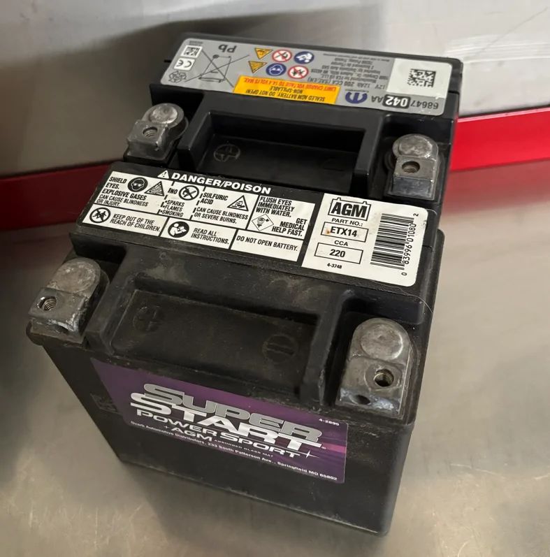

Rather than discarding it, since my aux is still good & the one for the motorcycle isn't, I suspected & was happy to find its an exact match. Saving money.
Jeep Wrangler JL Deleting (Removing) the Aux Battery 1777323631898-vs

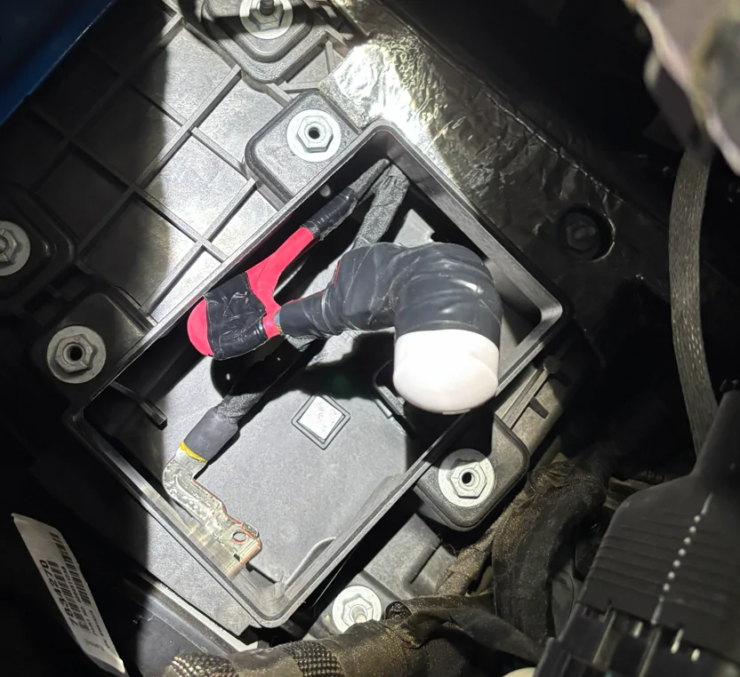

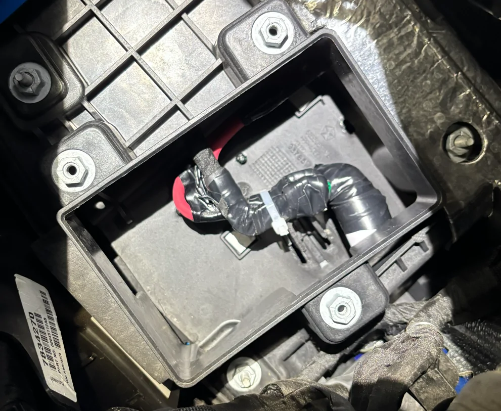

I put a cap over the exposed (+) terminal & taped it up.
Jeep Wrangler JL Deleting (Removing) the Aux Battery 1777323683215-u1
Then for good measure did the (-) & zip tied them together.
Jeep Wrangler JL Deleting (Removing) the Aux Battery 1777323716707-z

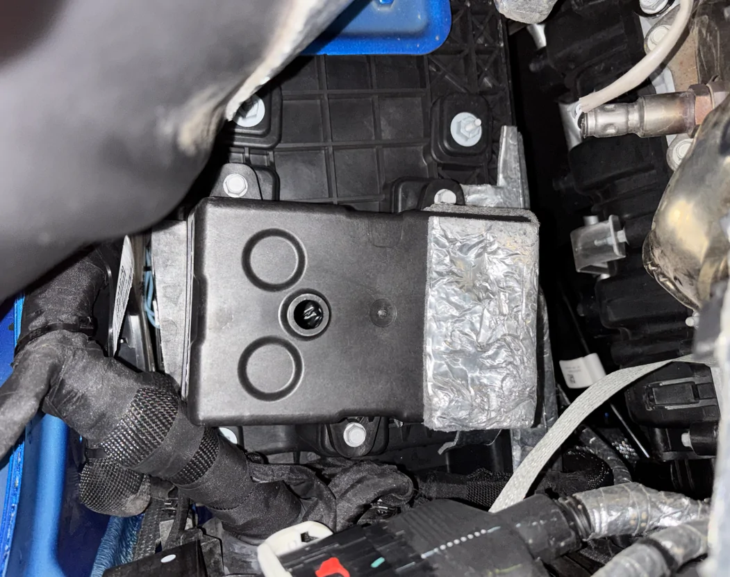

I then put the original aux battery blanket back in the lower box & bolted it back in place.

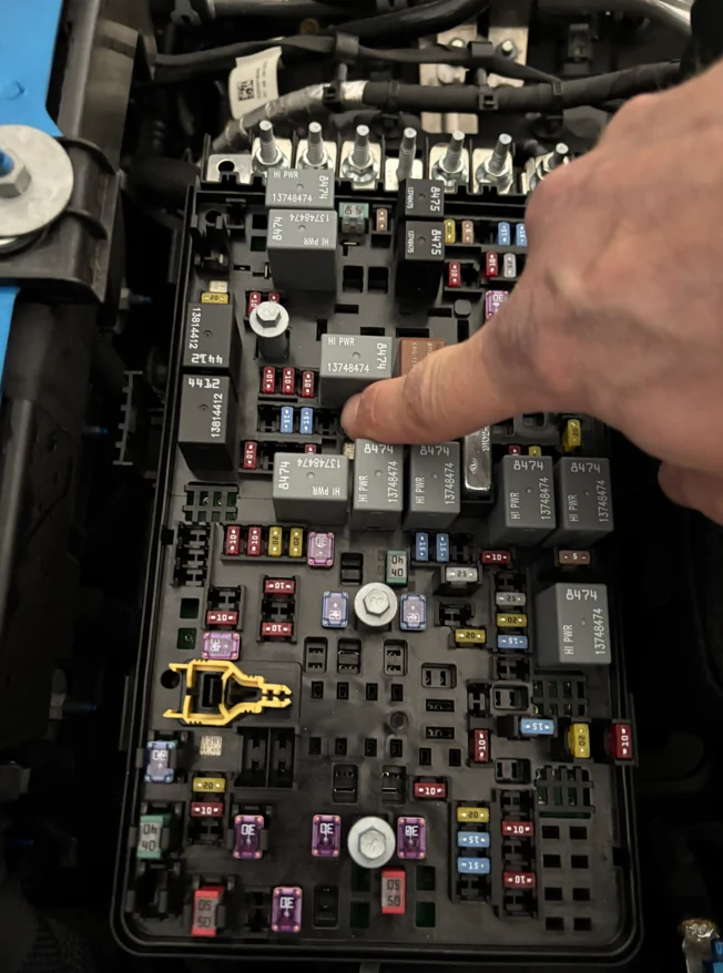

Pull fuse 42 (red 10A).
Jeep Wrangler JL Deleting (Removing) the Aux Battery 1777323818651-2j
