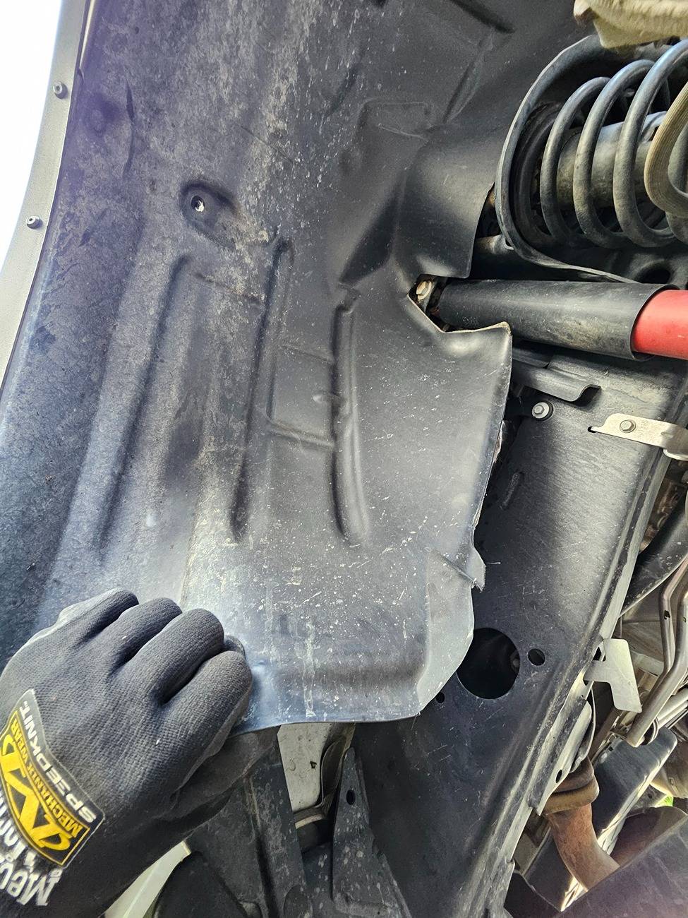

I was reluctant to do this after watching many YouTube videos. Some go through the top removing the distribution block. Others remove the entire inner fender liner. And crazy people remove the entire fender (and break all the clips in the process!). I know I could just leave it in place after removing neg cable and fuse 42 pull, but my inner OCD voice kept saying, you have a 15lb paper weight just sitting there doing nothing! So...
I decided to go through the inner fender liner and it was actually quite easy! I did remove the front passenger side wheel first for easier access. But basically you only need to remove a few 10ml bolts. Pull a few plastic clips with a trim removal tool. Then just pull back the liner and you have access to the box, that the aux battery is in, which is held in by 3x bolts. Now drop the aux battery enough to get to the terminals to disconnect. Took maybe 30min tops! You only need to remove enough clips and bolts to fold back the liner, not every single one, fyi!
A few pics...

Thanks for this post. I just removed my aux battery today using this method, and it was easy. To be specific, I only removed two 10mm bolts and the two plastic "Christmas tree" push pins that are next to each other at the very bottom of the rear of the inner fender liner. That was all it took to be able to fold back the liner and access the aux battery.
