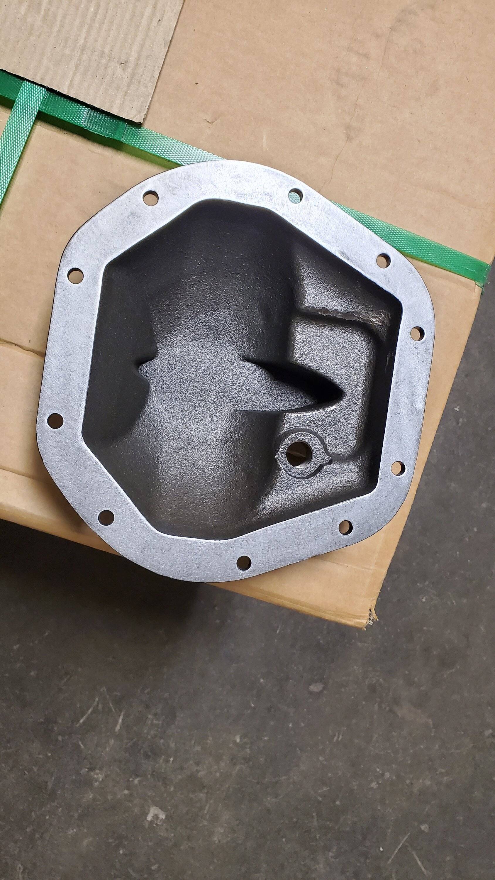

Also, follow on question since you seem well versed in differential tech. I couldn’t find any images of the inside of the Solid Cover, so I reached out and they actually provided me one. To my eye, this still looks like it matches most of the intent of the stock cover. It has some side pockets, but comparing to the commonly used ARB cover the pockets toward the side are less egregious than the ARB cover and lots of folks run those without issues. Can you see any issues with their design? I have heard some of the diff covers with horizontal cooling fins really mess with oil flow but this doesn’t seem like it would have any issues
It (more or less) has the contour shape that you see commonly used by OEMs and some aftermarket covers to help "channel" the oil over the ring gear. Truth be told, the oil has no choice but to follow the ring gear as it is the "pump" inside the housing for the oil.
It appears to be a solid piece (no pun intended) though the horizontal notch below the fill hole (above it in the photo) is a bit strange but I guess it is for the logo on the front of it.
I would run it without hesitation, just would not fill it to the bottom of the fill hole.

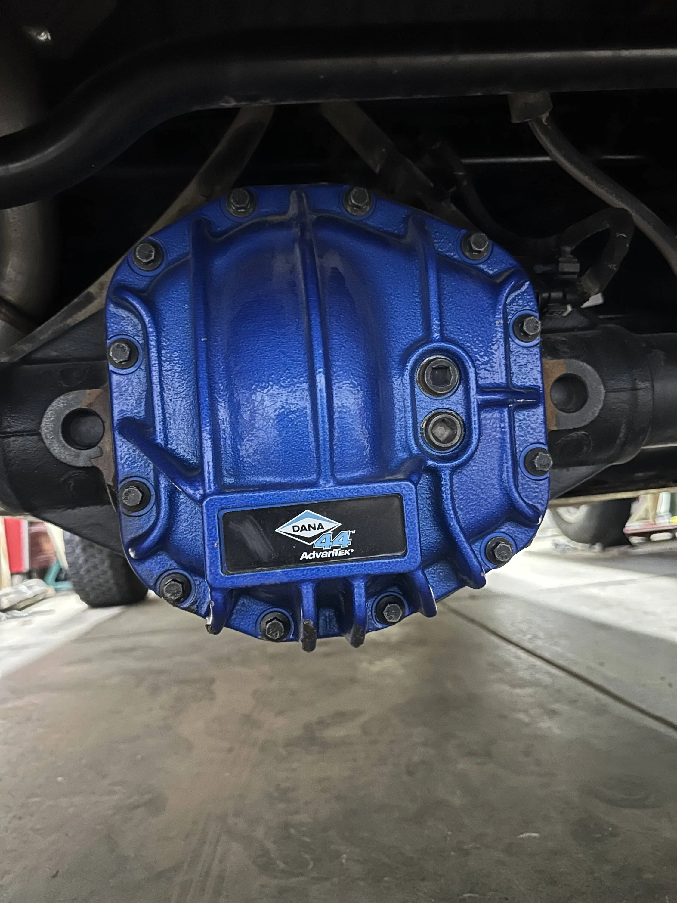

I purchased 2 Dana cast iron covers and had them powder coated to match my Jeep. The cast iron covers can take a good hit and not break or bend. The stamped steel covers can end up costing you a new set of gears and bearings. The powder coating makes the mud come off easily even after it has dried.

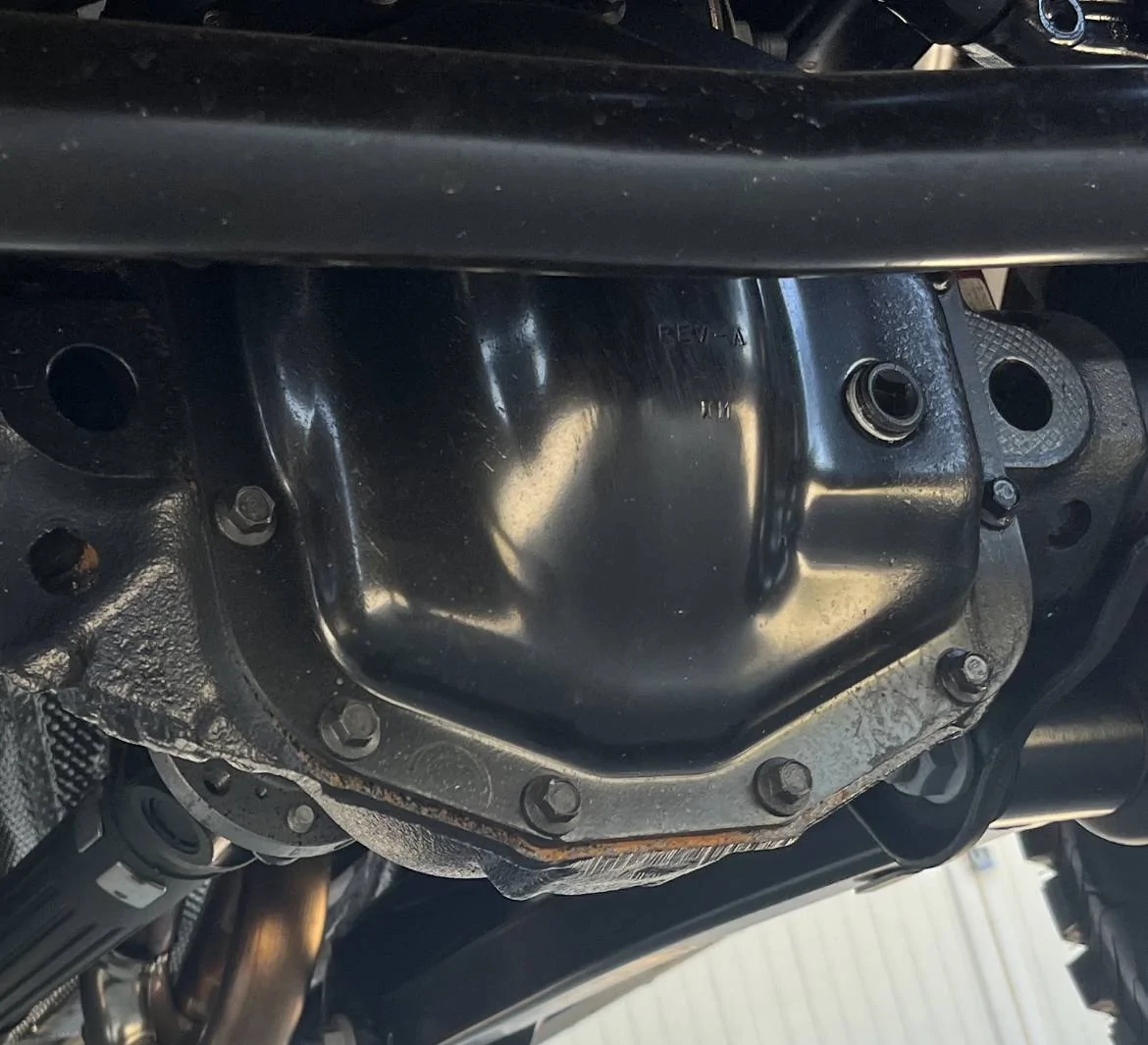

Well, after looking at the pictures the solid cover is out anyways. The bolt pattern (solid has 10 holes my diff has 12) and shape of the cover doesn’t match up..
Does the Dana spicer Dana 44 for the JL work on the M210? Correct number bolt holes, but my diff has a flat on the bottom 2 where the Dana spicer cover has a slight angle under the bottom center 2 holes
https://www.summitracing.com/parts/...7u32YG9zFMLVOSuuM8ZymPhYmVWkGgDIaAroHEALw_wcB
Here is an image I have on hand when I first picked the jeep up:
Jeep Wrangler JL D44 Solid Diff Cover 12485249-3668-494B-B407-1954BE17FF5B
CarbonSteel
Jul 21, 2019
305
5,795
8,250
You need two different ones for the front and rear:
Front (M210) = https://www.drivetrainspecialists.c...n-differential-cover-kit-gray---10044799.html
Rear (M220) = https://www.drivetrainspecialists.c...ron-differential-cover-kit-grey-10040651.html
