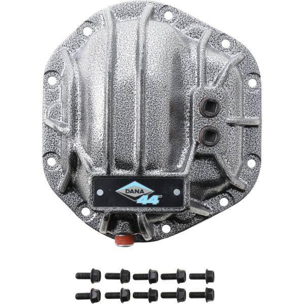

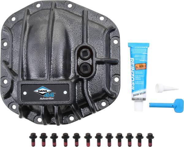

Nope. JLs have the new Advantek line from Dana.
JK:
Jeep Wrangler JL D44 rear Diff cover 1752174805960-ex
JL:
M210 Front:
Jeep Wrangler JL D44 rear Diff cover 1752174775902-i1
M220 Rear:
Jeep Wrangler JL D44 rear Diff cover 1752174826370-mt

The rear axles changed for the JL starting in 2018.
While the marketing department calls them by the old names, Dana 35 and Dana 44, they really are the Avantek M200 and M220. They share basically zero common parts between them.
Same thing applies to the front "Dana 30 and Dana 44" being the M186 and M210.

I've asked before and never got a straight answer. Which fill hole do you use?
Good question.
Upper is initial fill, lower is service fill, this is from the UD axle rebuild specs:
