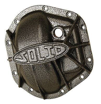

Hey all,
I was wondering if anyone has had any experience running the Solid diff cover on the M210 Dana 44 axle. I like the look of the brand, and was looking at upgrading my diff cover soon. I have not really found any traffic on the forums about this particular cover which is odd, I know a lot of the older jeep guys run them.

Looks like a decent cast iron/steel cover. Certainly better than the stamped steel OEM covers.
I use another brand on mine but I would run those if I had em.

Also, follow on question since you seem well versed in differential tech. I couldn’t find any images of the inside of the Solid Cover, so I reached out and they actually provided me one. To my eye, this still looks like it matches most of the intent of the stock cover. It has some side pockets, but comparing to the commonly used ARB cover the pockets toward the side are less egregious than the ARB cover and lots of folks run those without issues. Can you see any issues with their design? I have heard some of the diff covers with horizontal cooling fins really mess with oil flow but this doesn’t seem like it would have any issues

I ran the solids on my jk. Super good quality. Also as mentioned fill location is for extra capacity due to pinion angle but do not fill it to run out the plug. That would be way to much oil. I went with dana spicer nodular iron covers for the jl.

At a high level - the primary reason is strength. OEM covers are traditionally stamped, aftermarket are traditionally cast, and thicker. They are nice peace of mind while wheeling and accidentally slipping off line and mashing your pumpkin on a rock. If the end user does not wheel, it is basically an aesthetic thing. I think some market then with cooling fins to help keep oil temp down but I’ve read (not experienced first hand) mixed things if that actually works.
