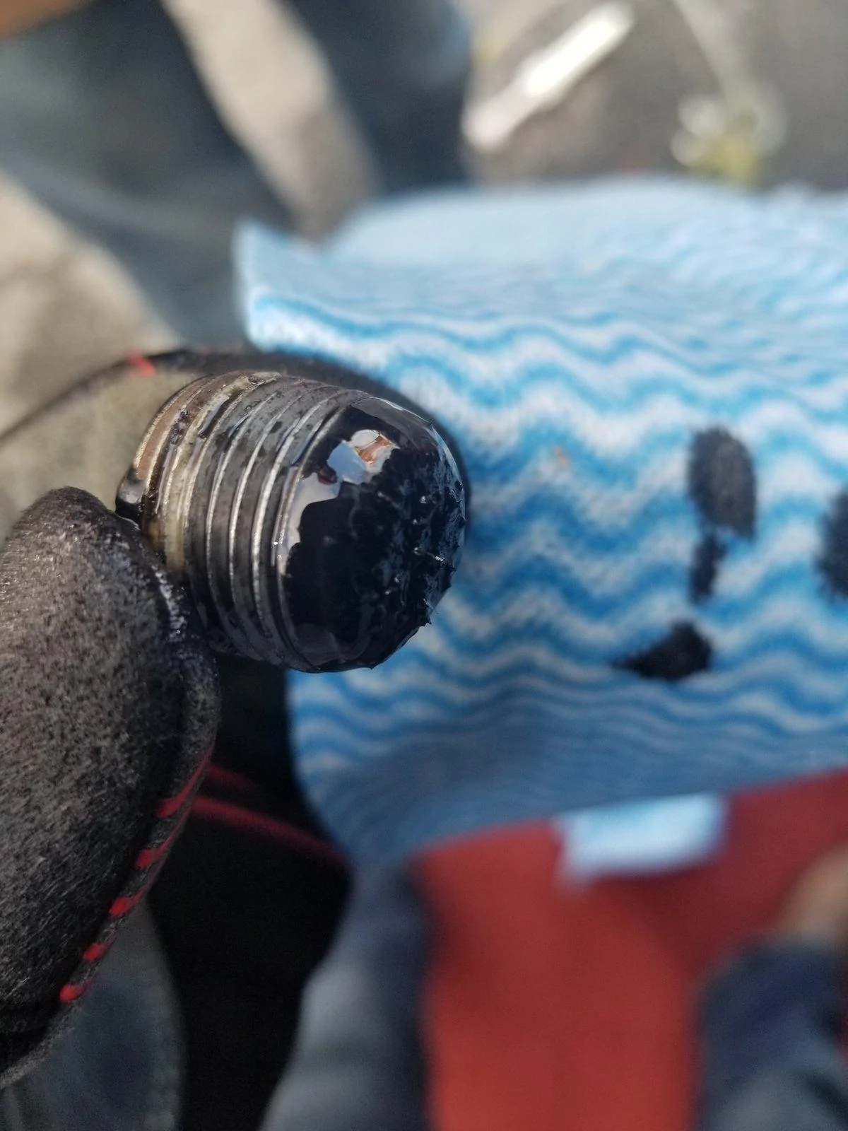

Thanks Matt! I should have provided a fuller story. I previously changed out the rear diff and got this purplish-black oil out. I checked it again ~5000 km later and same sort of thing. I'm thinking it may have some water or other crud in it from a slight misadventure I had this fall. Although no noise and no real bad feelings back there so far (knock on wood!)
Just looking to get in there and see if it's anything to be concerned about

I plan on doing my first change in the next few days at ~2700 miles if work/family duties don't get in the way. Just picked up the gear oil and MOPAR friction modifier today (M220 w/LSD).
I'll take note of what the gear oil I am dumping looks like.

Just finished my rear differential. The gear oil looked just like yours at 2830 miles.
Well that certainly eases the mind, thanks man!
