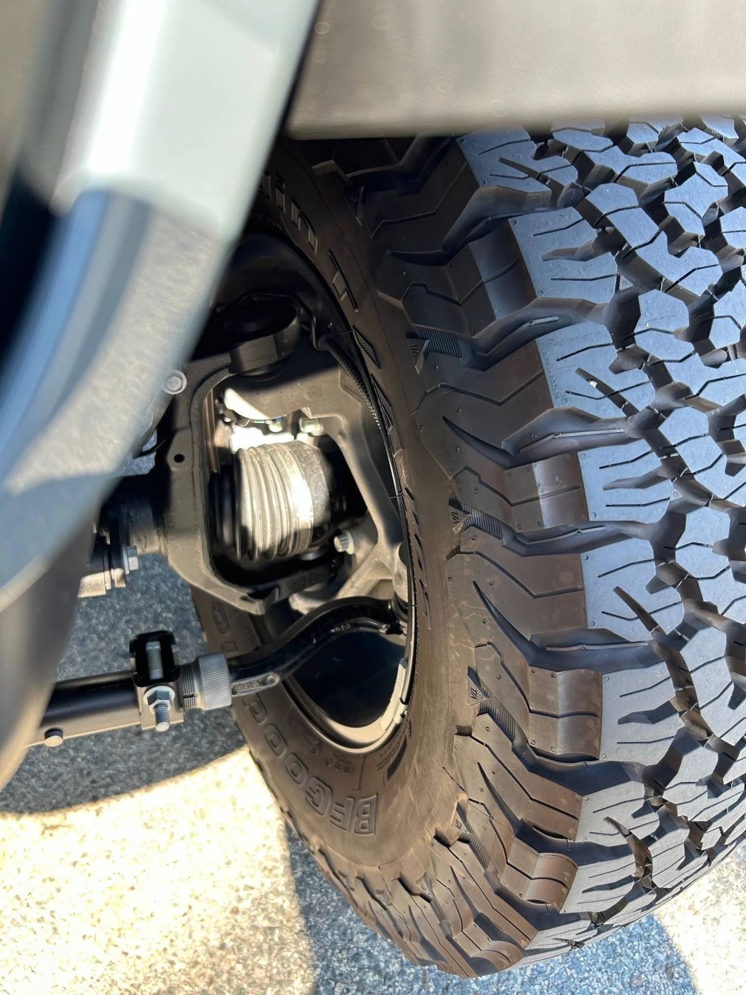

I noticed that the front axle has a CV joint. I purchased a 2024 Wyllis and discovered the CV joint. My JK had u joints.
When did Wranglers go to CV joints? IS there an advantage or disadvantage of having CV joints.
As I remember, the jeeps with 4H auto had CV Joints
My Jeep 2 Door Willys with 2.0 Automatic

CV joints maintain a constant velocity rotation of the wheel. You don't get the humpy movement that a U-joint front axle has when in 4wd and turning sharply.
This.
I put RCV shafts in mine. It's a lot smoother in tight turns in 4WD then with the stock u-joints. Not so jerky.
