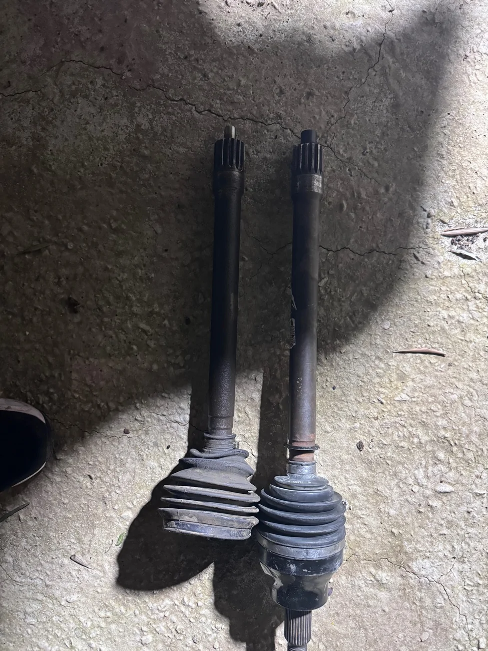

I bought a used one , what i find .
but what i bought it seems to be taller ( length) 🥲
even they has the same number of splines ,
I bought my jeep from a person that may be missed up with the jeep axles , i dont know if the broken one was the original oep part , back then when i has a full suspension open the same side ( passenger ) was making a clicking noise , i appresiate you all for replaying and trying to help 🌹
