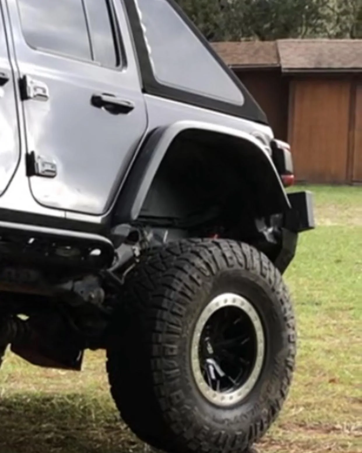

Nice build. What made you decide on 4.5" BS? I thought for the larger builds you needed to go to 3.5"

Thanks Joe.........That’s RK recommended backspace for Rubi axles, probably would need 3.5” BS on Sport/Sahara axles beings there not as wide.
I like the look of the wheel sunk in, but I didn’t want to go to -38 offset which the 3.5 backspace is, so I opted for the -12 offset/4.5 backspace. I’m about 1/2“ to 3/4”away from the lower control arm at full lock turn.

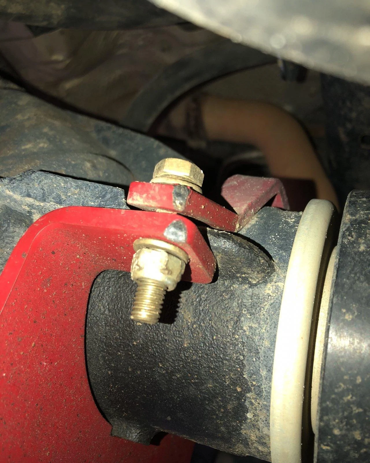

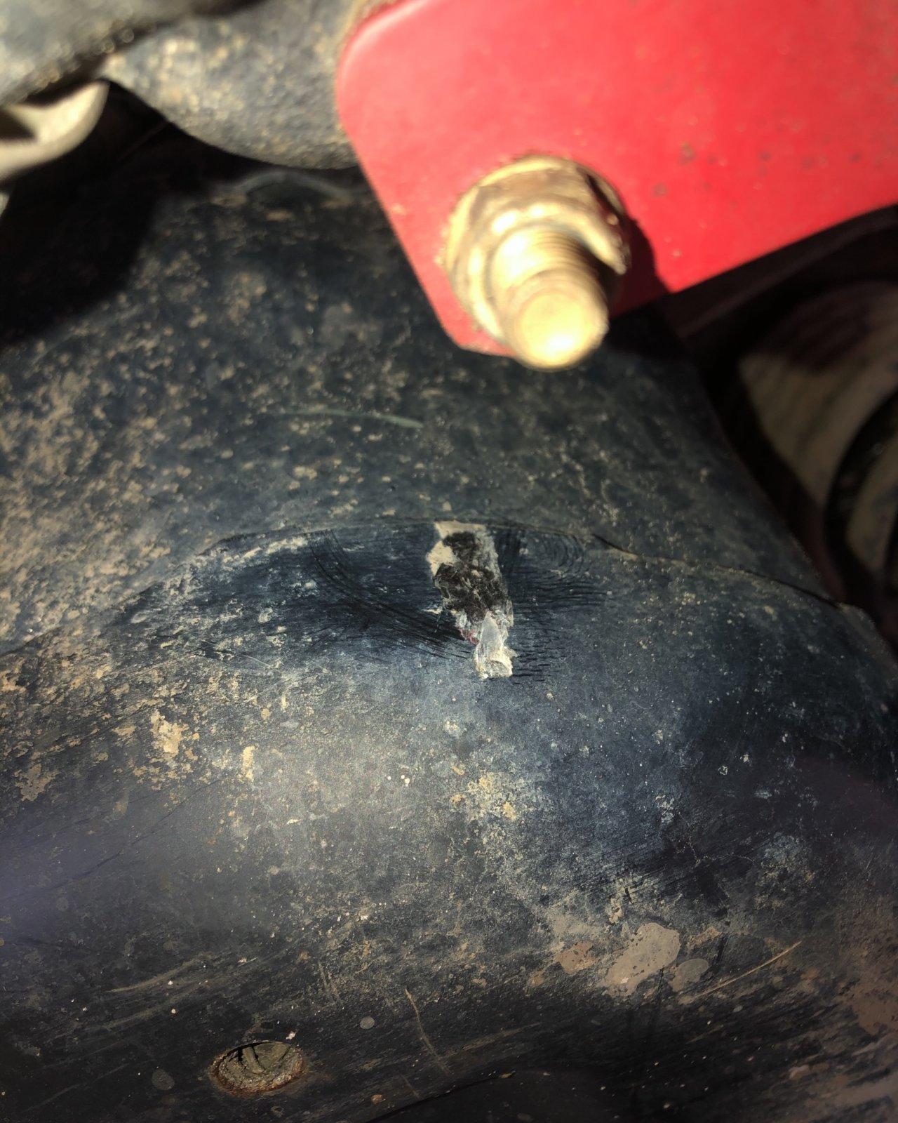

For you guys using long travel shocks or coil overs and a Rancho diff skid, and are hearing a clunk when flexing rear wheels, it’s probably this......
Jeep Wrangler JL Crystal Rubi build… 295C8B8A-DAD1-4E8F-9D13-CD8DB848BA00
Jeep Wrangler JL Crystal Rubi build… 9D437CA1-92CC-4F8B-90B5-7BCAFEF5BDDF
Diff skid is hitting gas tank skid, when drooping drivers rear wheel......just a heads up.....:)
