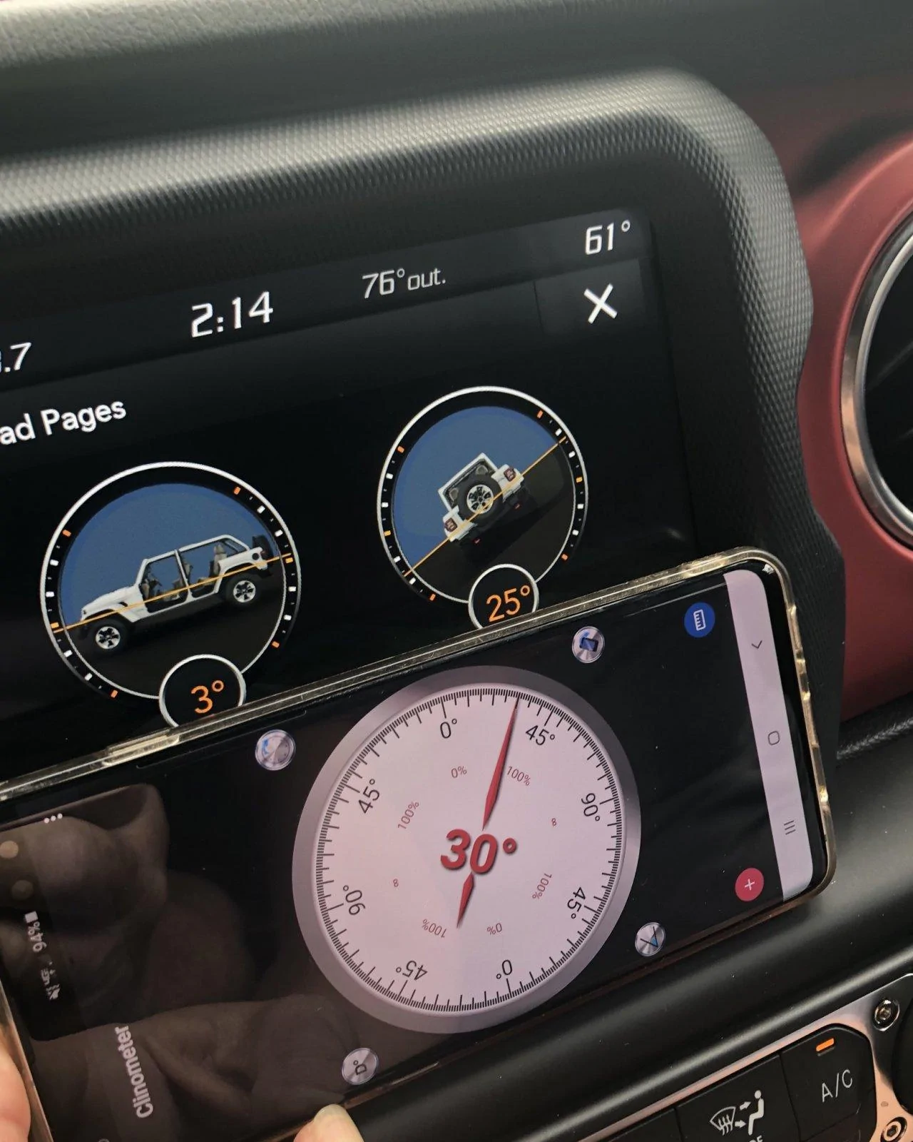

We were off camber and it felt like we were on a wall, but the off-road pages said 25 degrees roll. So the wife downloaded a clinometer app on her phone and put it parallel with the screen. and it showed 30 degrees. I wonder if this is the limit of all Jeeps clinometers or if mine is broken..?

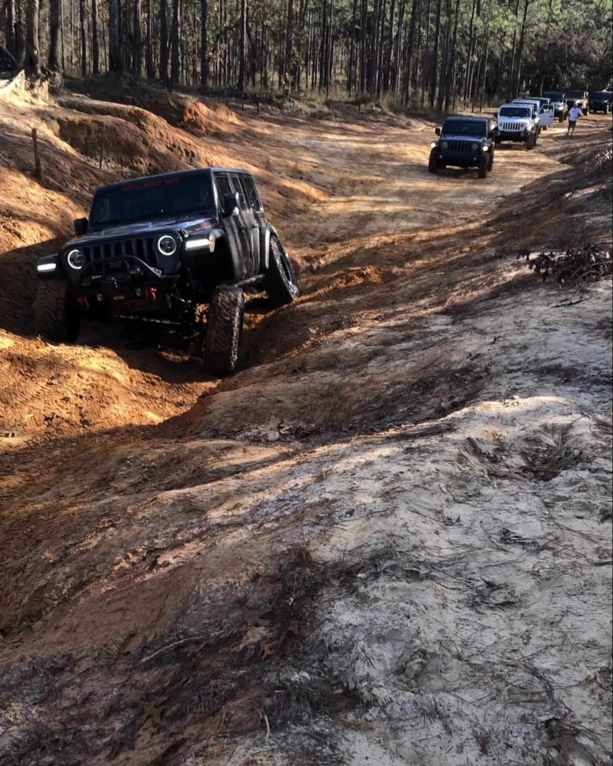

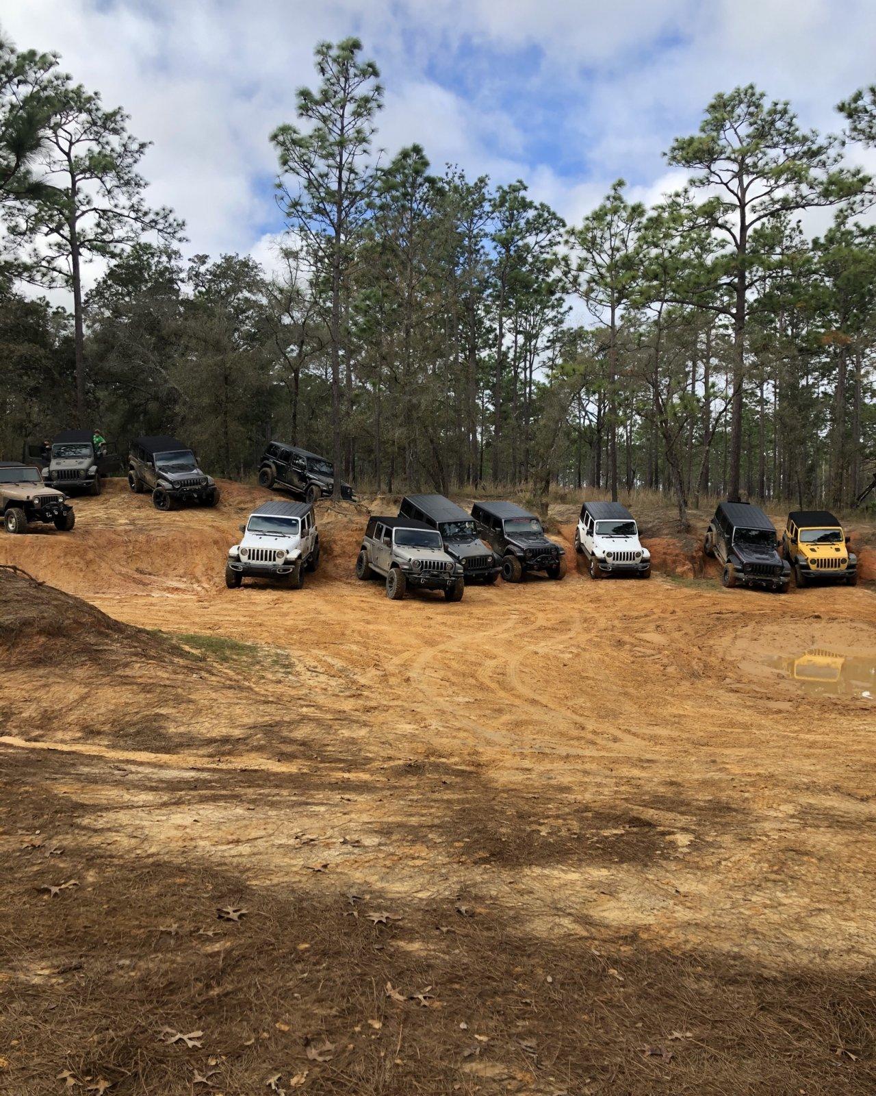

Some pics for the journal part of this thread.
December 2019 we had 10 forum members come over to wheel with us, we had a blast.
Group photo:
Jeep Wrangler JL Crystal Rubi build… 0C64DA38-35B3-442E-BE04-B3CECBBD71EB
Here’s the wife showing off, leading the pack, I got to be the photo monkey, lol.

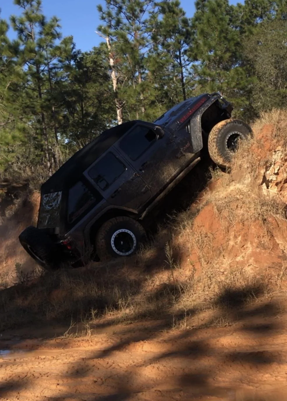

Some more random shots....
Jeep Wrangler JL Crystal Rubi build… 83573C7B-8F19-4EE7-BF9D-252CD6FF39CF
Jeep Wrangler JL Crystal Rubi build… 3BB7F1A4-37E7-44CC-B8ED-4880DFD52AEF
Jeep Wrangler JL Crystal Rubi build… 7FD2122E-93BE-4BCC-9DDC-FFAAE5CAB46C
Jeep Wrangler JL Crystal Rubi build… A694C3E5-A1FA-4C77-BC6F-C465D9A11C2C
Jeep Wrangler JL Crystal Rubi build… 5337ED40-3D8E-4EB5-92D6-0A6F5DB51FC4

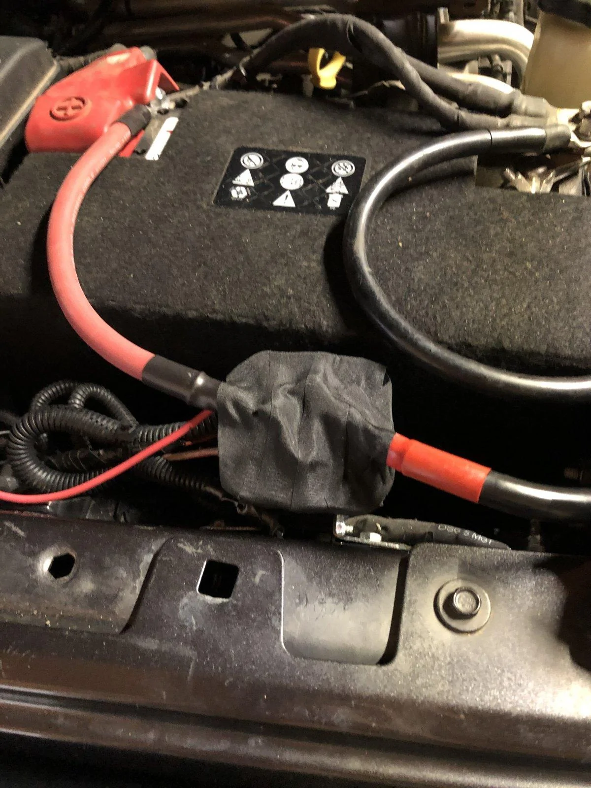

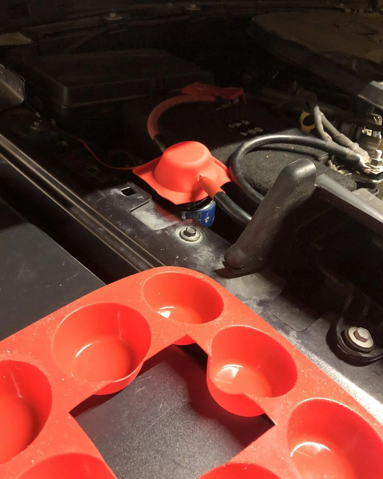

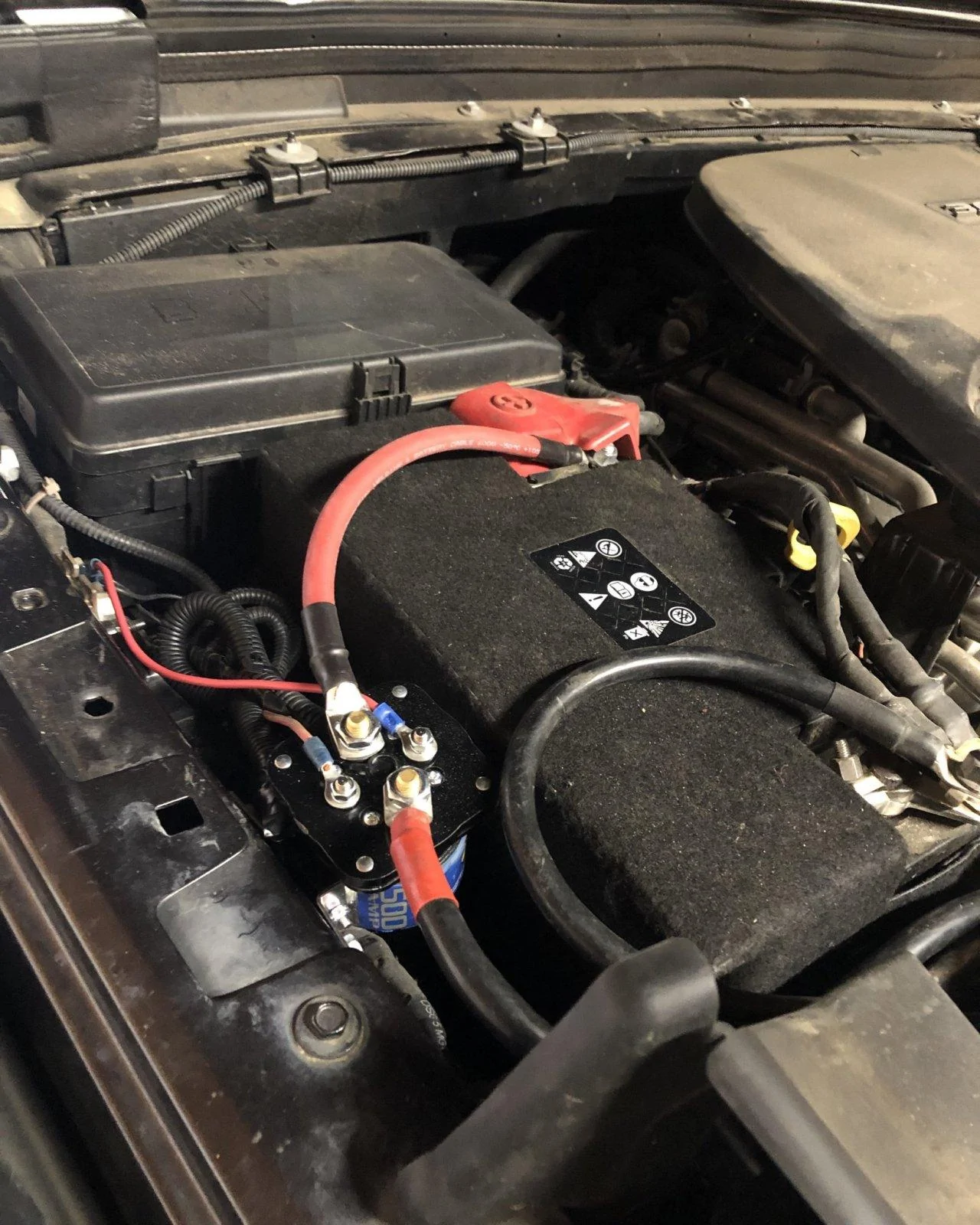

I decided to ditch mama’s silicone baking pan and use tesa tape to cover the top of my relay switch.
I liked the idea of the muffin pan cover but couldn’t get it stay on while wheeling. A few drops of silicone caulking on the corners would probably work, but I think the tape looks cleaner and it’s definitely not coming off.
Small thing, but I’m not crazy about leaving the top of that relay exposed because I’m always under there piddling with something, and it’s inevitable I’ll short it out.....:facepalm:

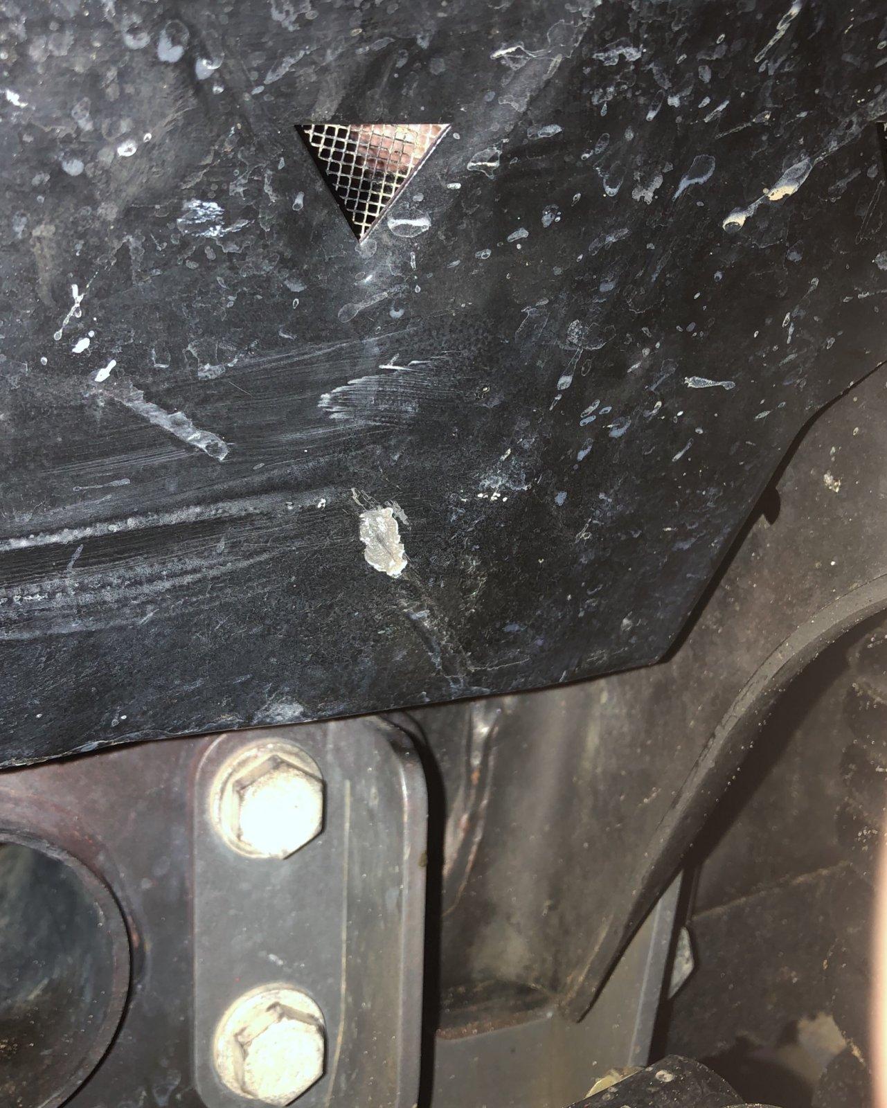

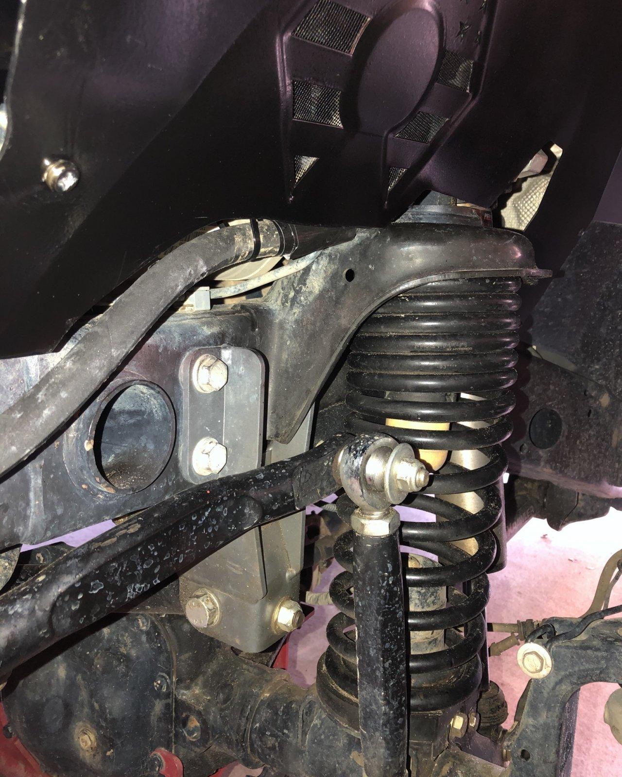

Also... while out today I noticed the sway bar end links are rubbing the inner liners. I had to put a spacer behind the liners so they wouldn’t rub against my resi hose.
Jeep Wrangler JL Crystal Rubi build… EB8C5D90-39B0-4CC1-A728-C2B7BEE33B46
I
So I decided to just cut a section out, this gave me the clearance for the sway bar end links and I don’t have to worry about any rubbing of the resi hose.
