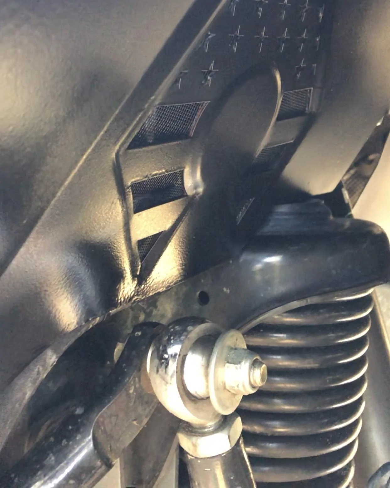

Took it up on ramp to check my inner liner modification.... end link has plenty of room now and I can stop worrying about my resi hose being rubbed by fender as well.

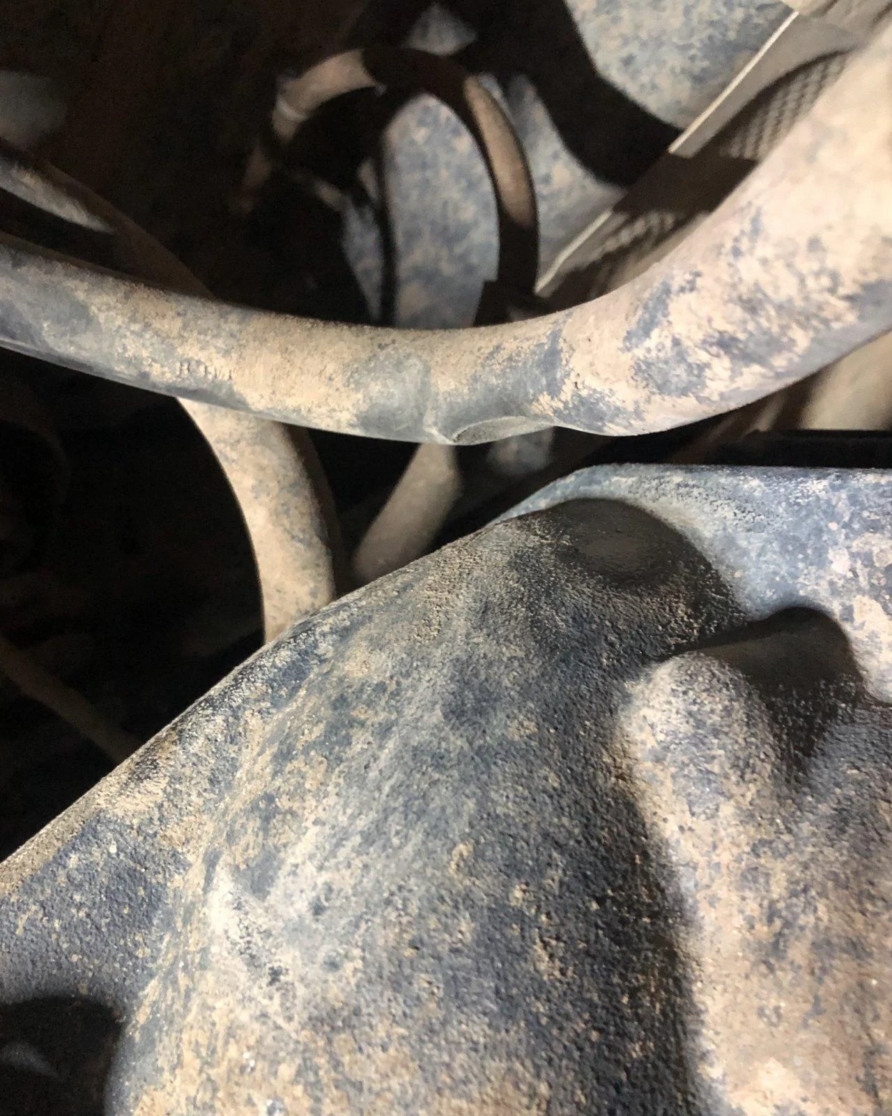

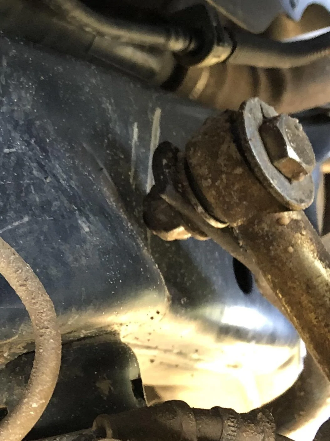

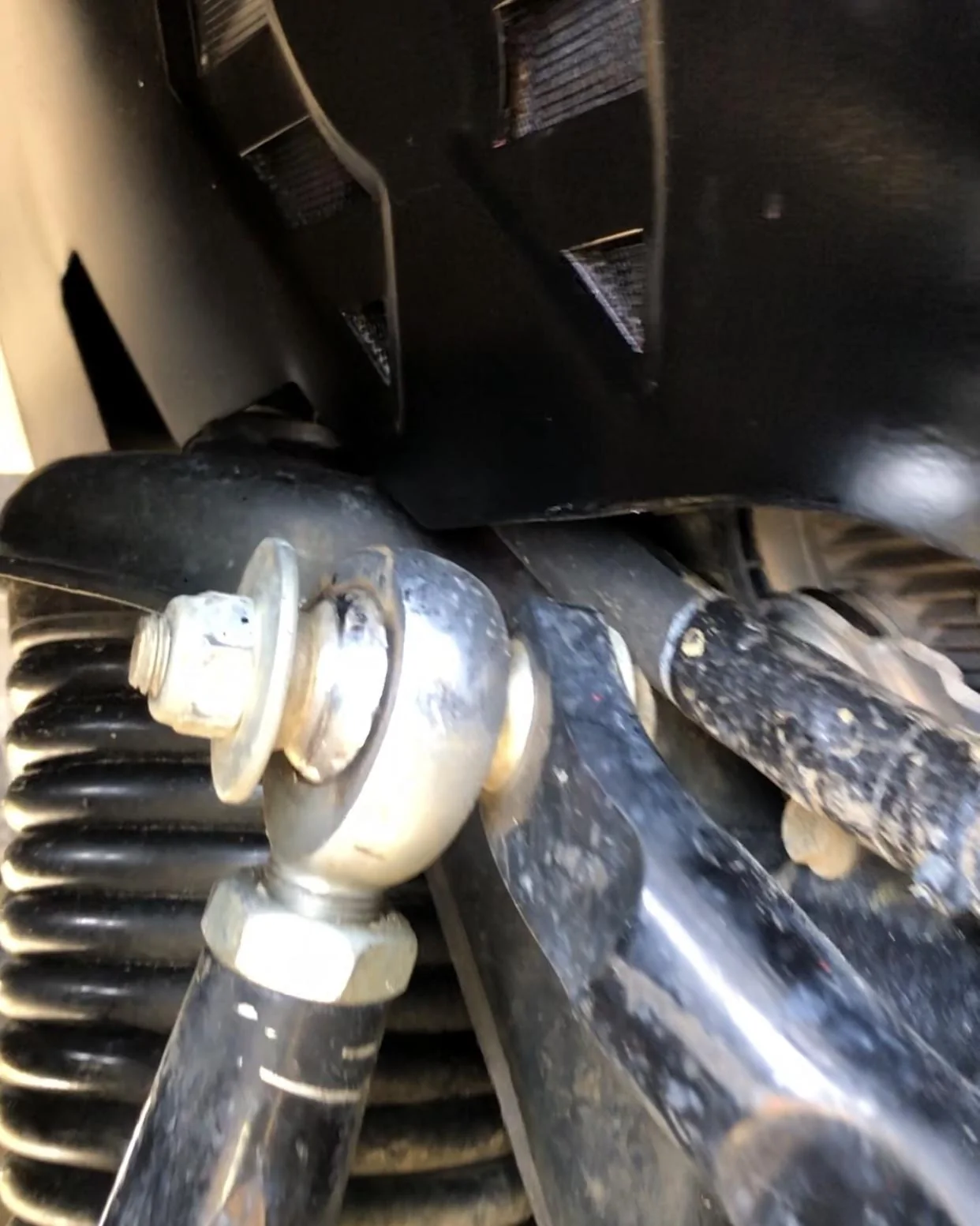

While up there I heard a clunk, and after looking it over, I found this......
Jeep Wrangler JL Crystal Rubi build… 540F3C22-C0DB-49F2-A24D-AC3A08F6C3D7
Ole..... the trials and tribulations of long travel shocks.....:facepalm:.......but it’s worth it......:)
I’m gonna try turning the bolt around first, (easiest) that should give me a 1/4”to 3/8” extra room, then go from there. If that is the right direction but I need a little more then I’ll try and find one of these....

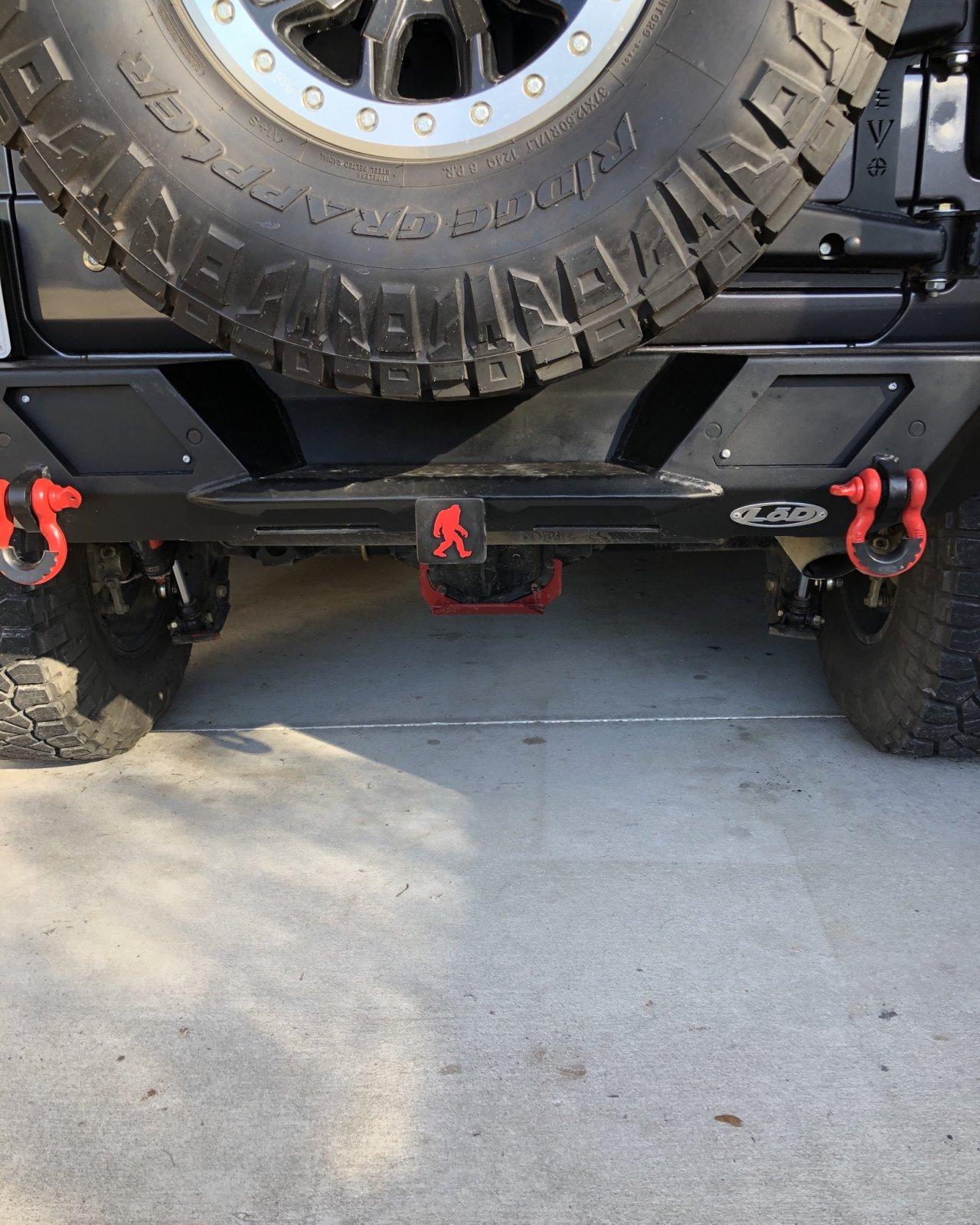

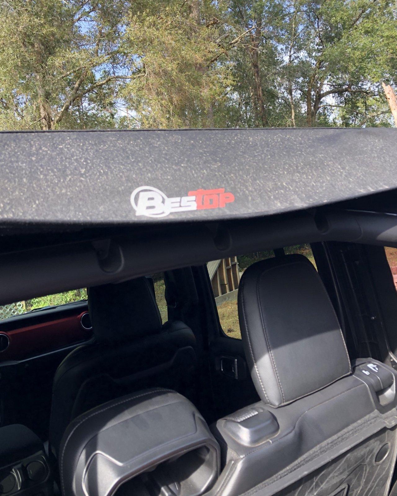

Couple of small things.......

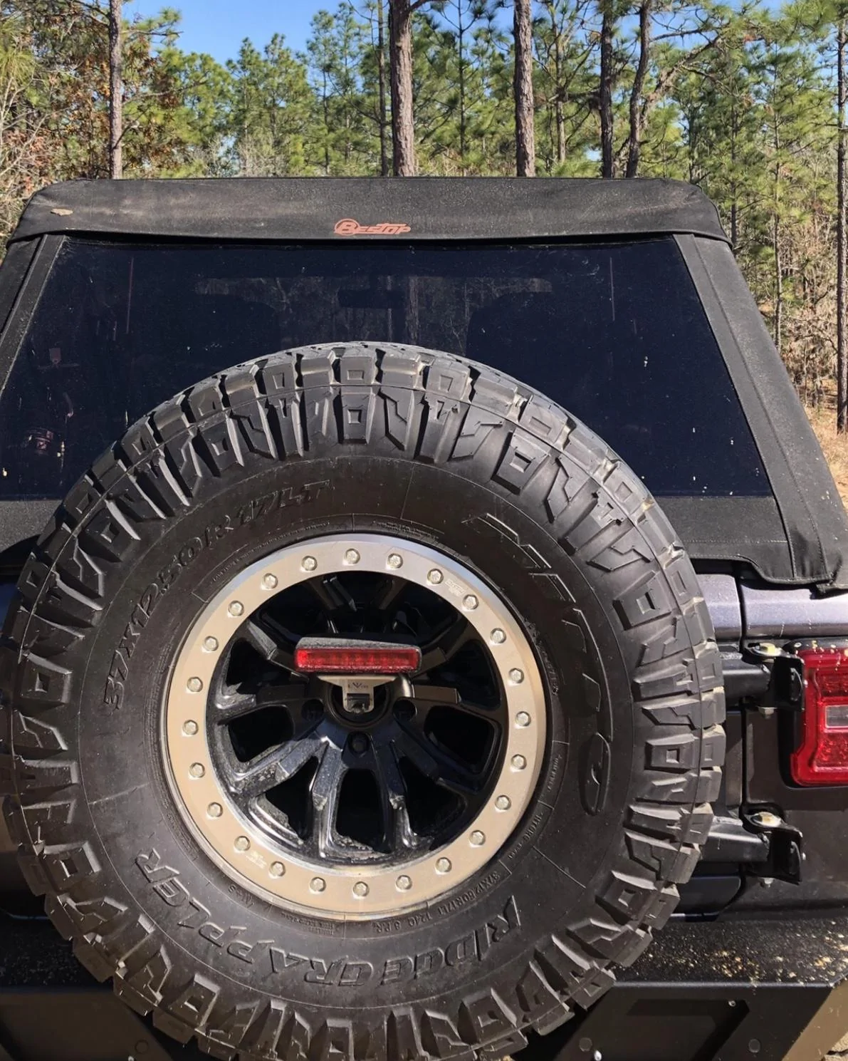

The wife couldn’t get past the bright white Bestop logo on the back of the soft top. I said your in charge of cosmetics I’m just the mechanic, fix it if you want, so she did.
Jeep Wrangler JL Crystal Rubi build… 3991B3FA-B23A-4C8D-ADE4-40B7EC0DEEC3
Jeep Wrangler JL Crystal Rubi build… E14101C1-E4FB-4A7F-8257-E4A508E2014B
I have to admit , it does look a 100 percent better. She also said she found a hitch cover with my likeness on it, so she just had to get it..........:facepalm:

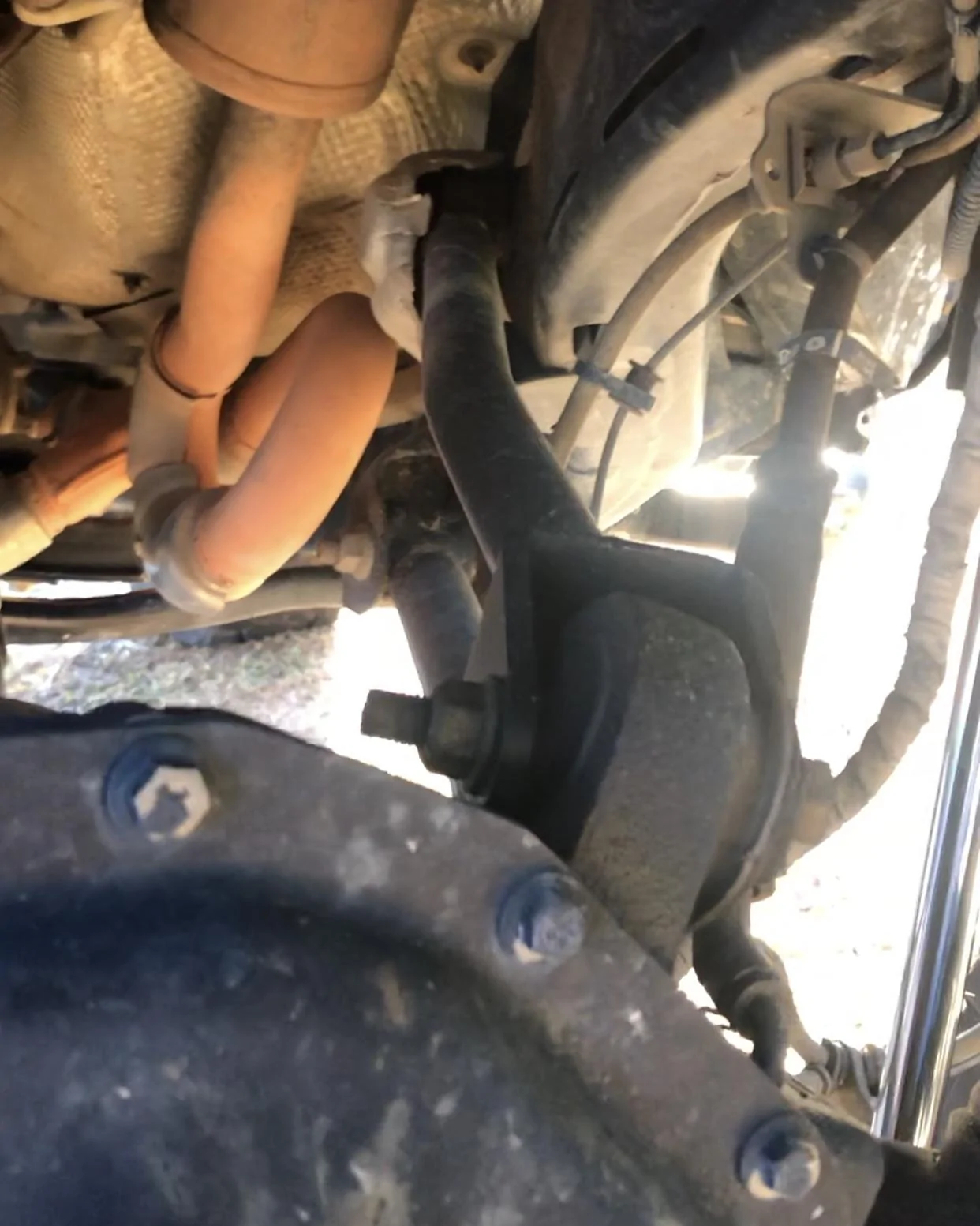

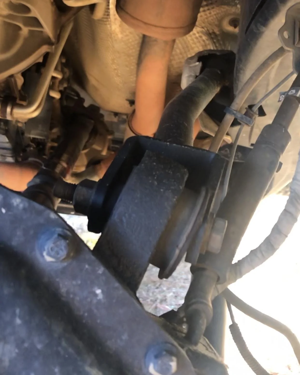

This is why , when @limeade told us about rock jock upper control arm joints coming out, I knew I wanted them. This bushing is not liking this angle at all. I was looking at other options, but the rock jocks are exactly what I need......
Jeep Wrangler JL Crystal Rubi build… 4631699B-0E79-4F96-841D-EDCA707DD05F
Jeep Wrangler JL Crystal Rubi build… 965B4C2D-3B6D-4461-AA4E-1E27EAE76391
I haven’t installed mine yet , because I’m curious how long the oem will hold up. They’re sitting comfortably on the shelf next to my dynatrac ball joints, also in a holding pattern......:)

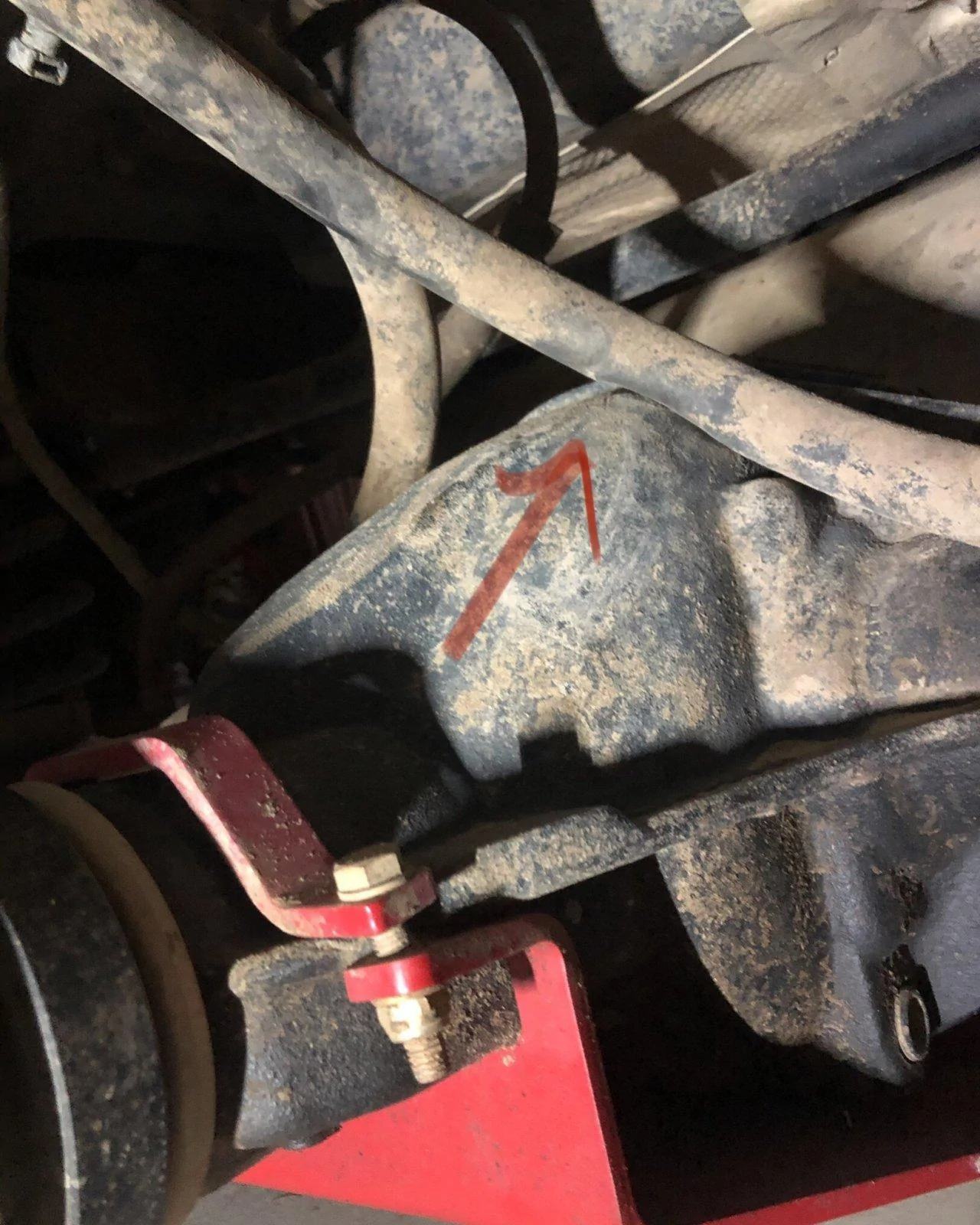

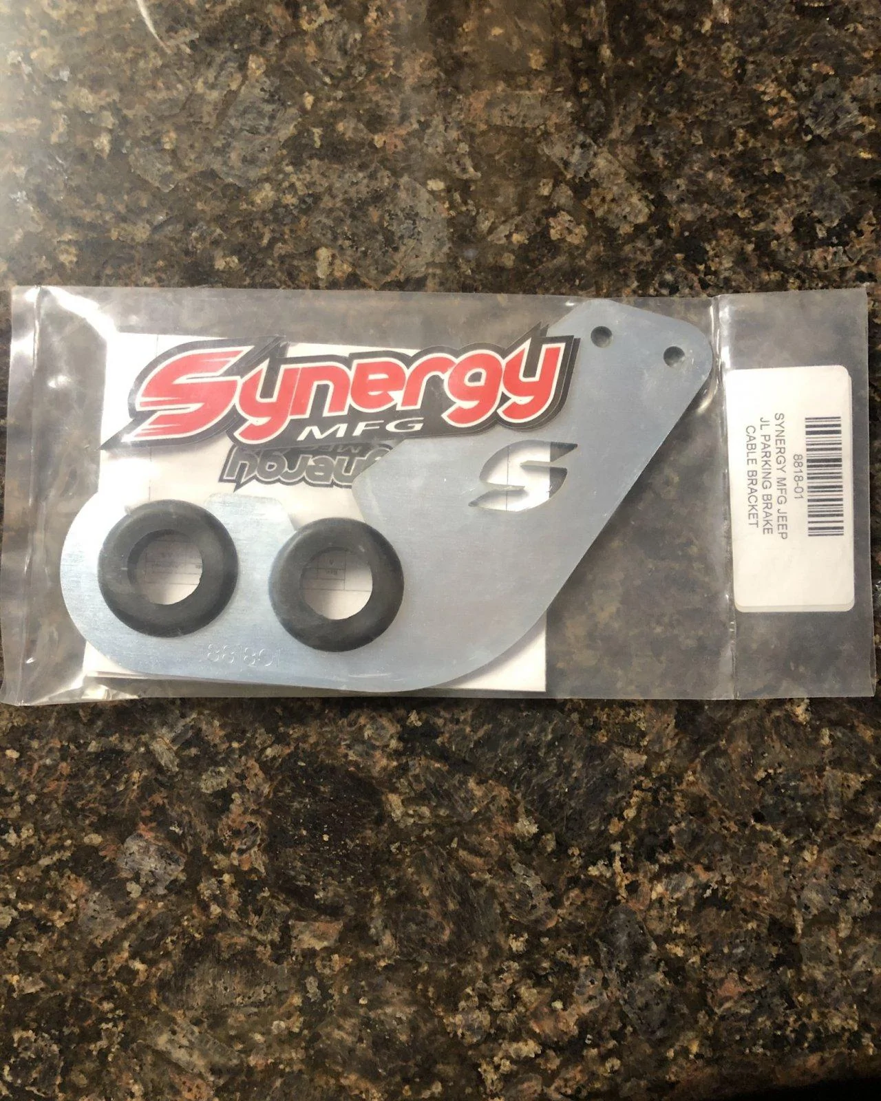

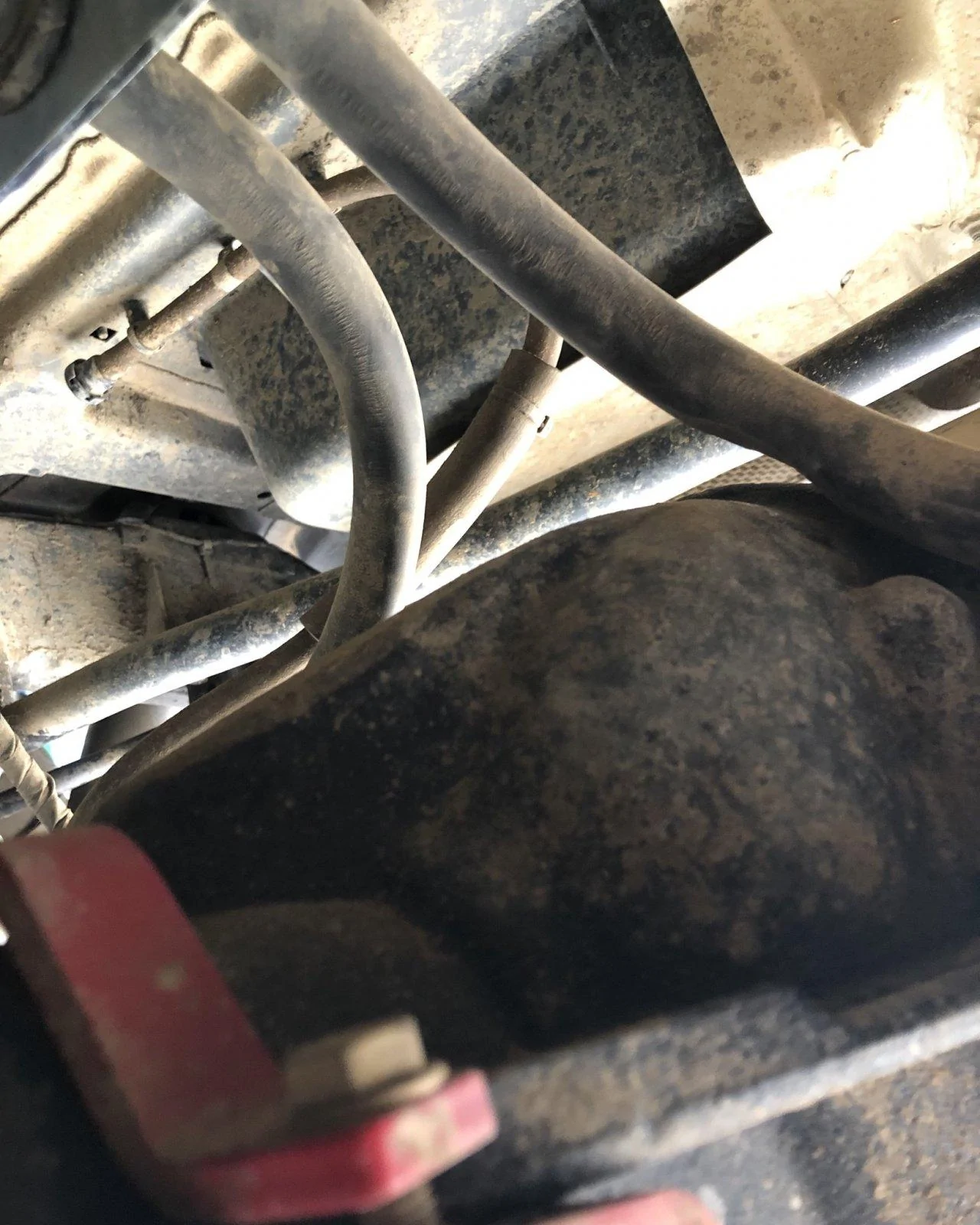

Got this yesterday.......
Jeep Wrangler JL Crystal Rubi build… 42F1C722-2886-464A-B8B9-28D2CDD501CE

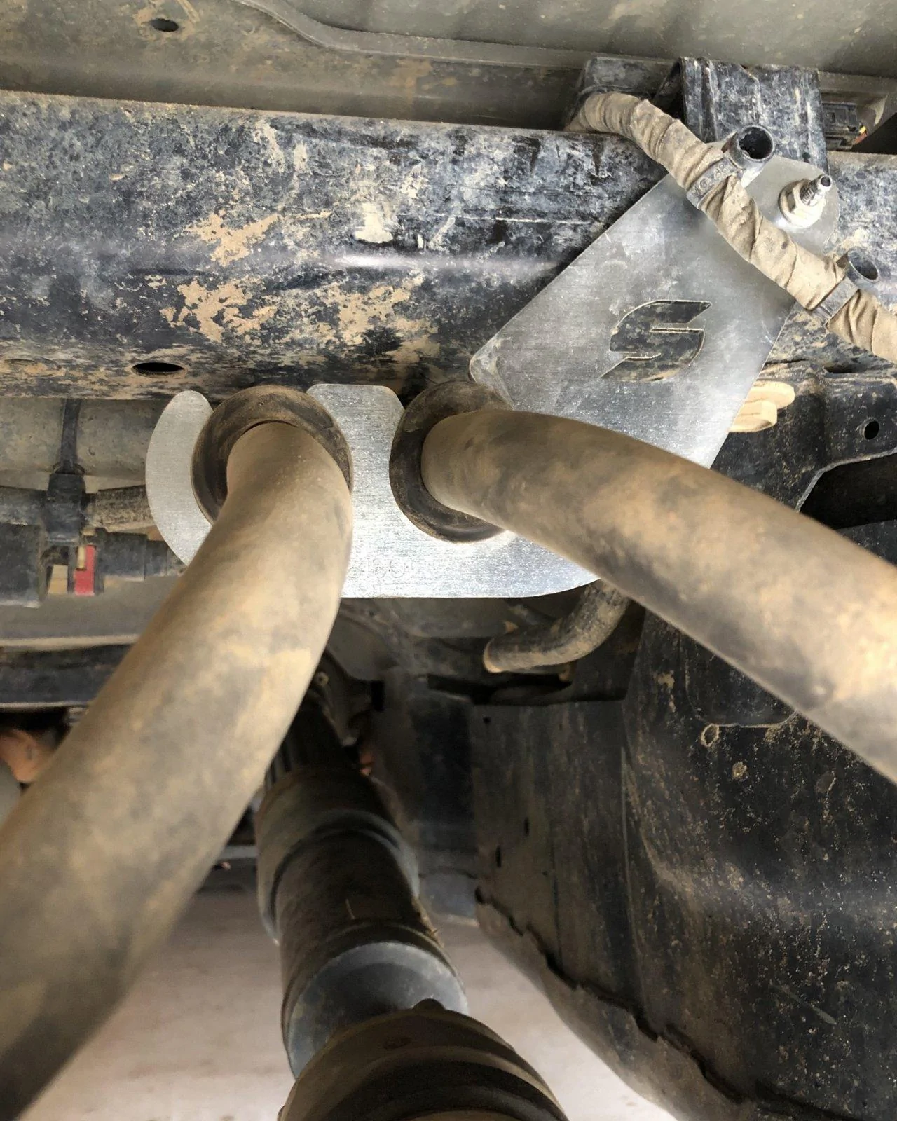

Been meaning to put it on since July....... :facepalm: .. to be honest, I just flat forgot about it. My foam rubber that covers the brake cable is getting a little to comfortable laying on the diff. Lol..... there’s no damage to cable, everything’s working fine, but it’s time to address it.
Jeep Wrangler JL Crystal Rubi build… 190BF21F-EA77-44E7-8272-CEE814EFA720
Jeep Wrangler JL Crystal Rubi build… 29DFEC56-5C5D-4006-BD6F-977281D7961D
Edit.......
I got it installed, and it holds the cables up off the diff nicely..........
