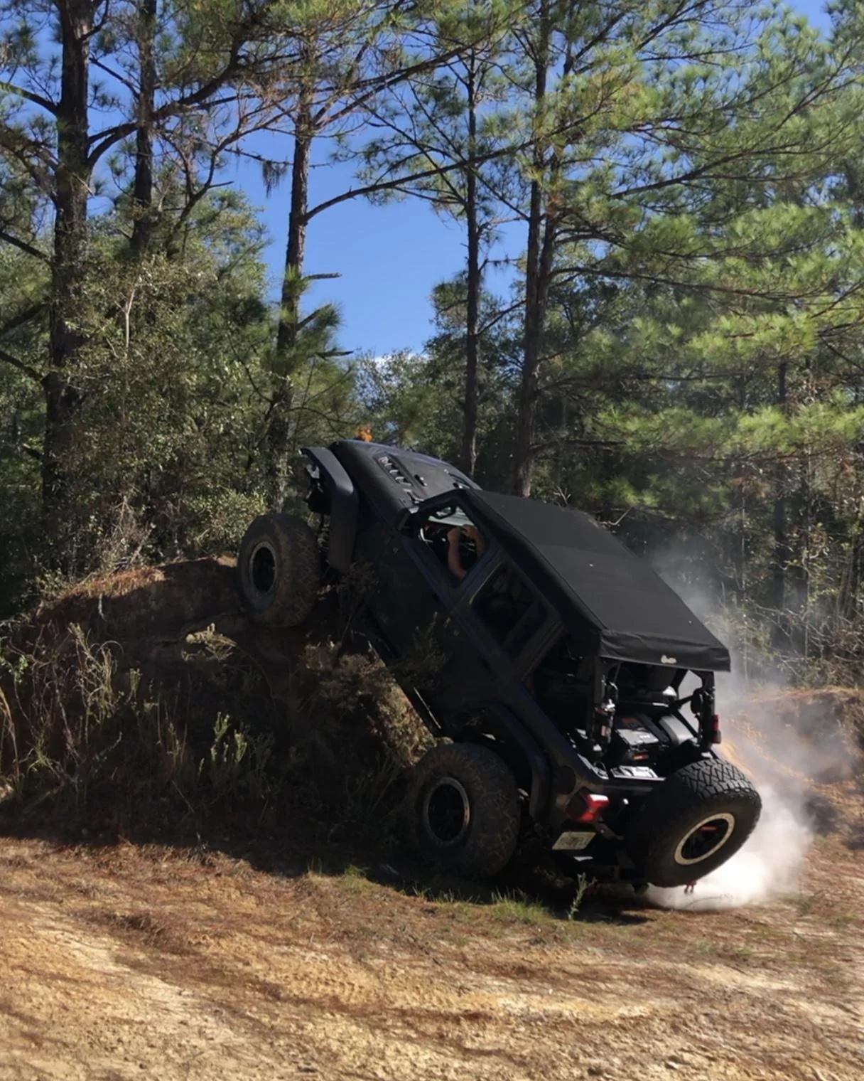

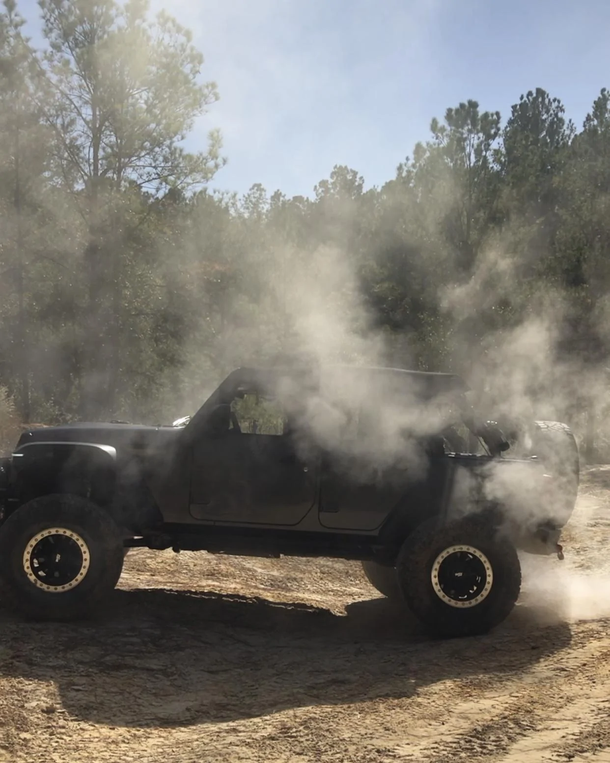

We had her up on her hind legs to much this weekend.....and some blow back got burned off......:facepalm:......So got a Mishimoto catch can coming. Hopefully this will help, providing I remember to empty it, lol.

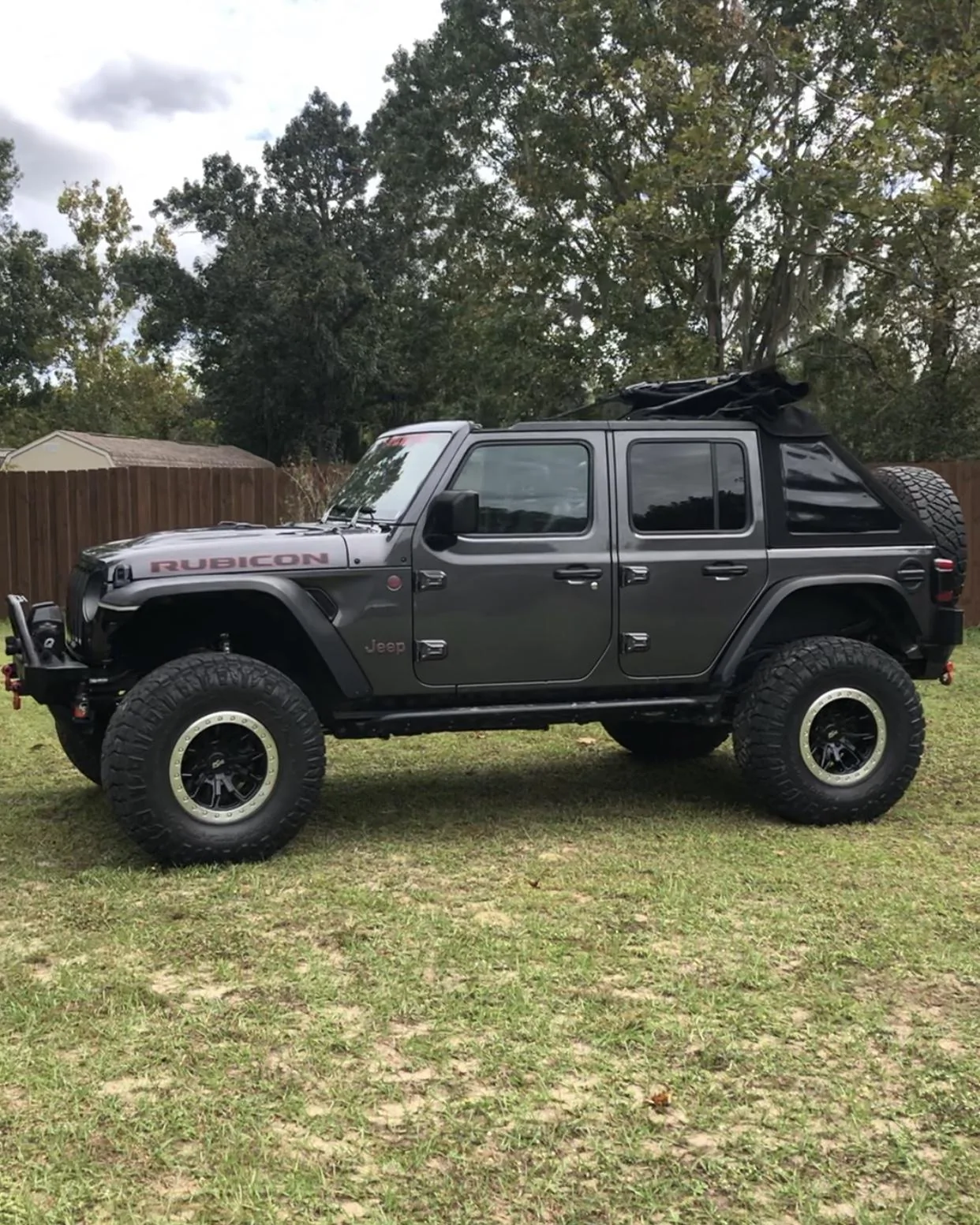

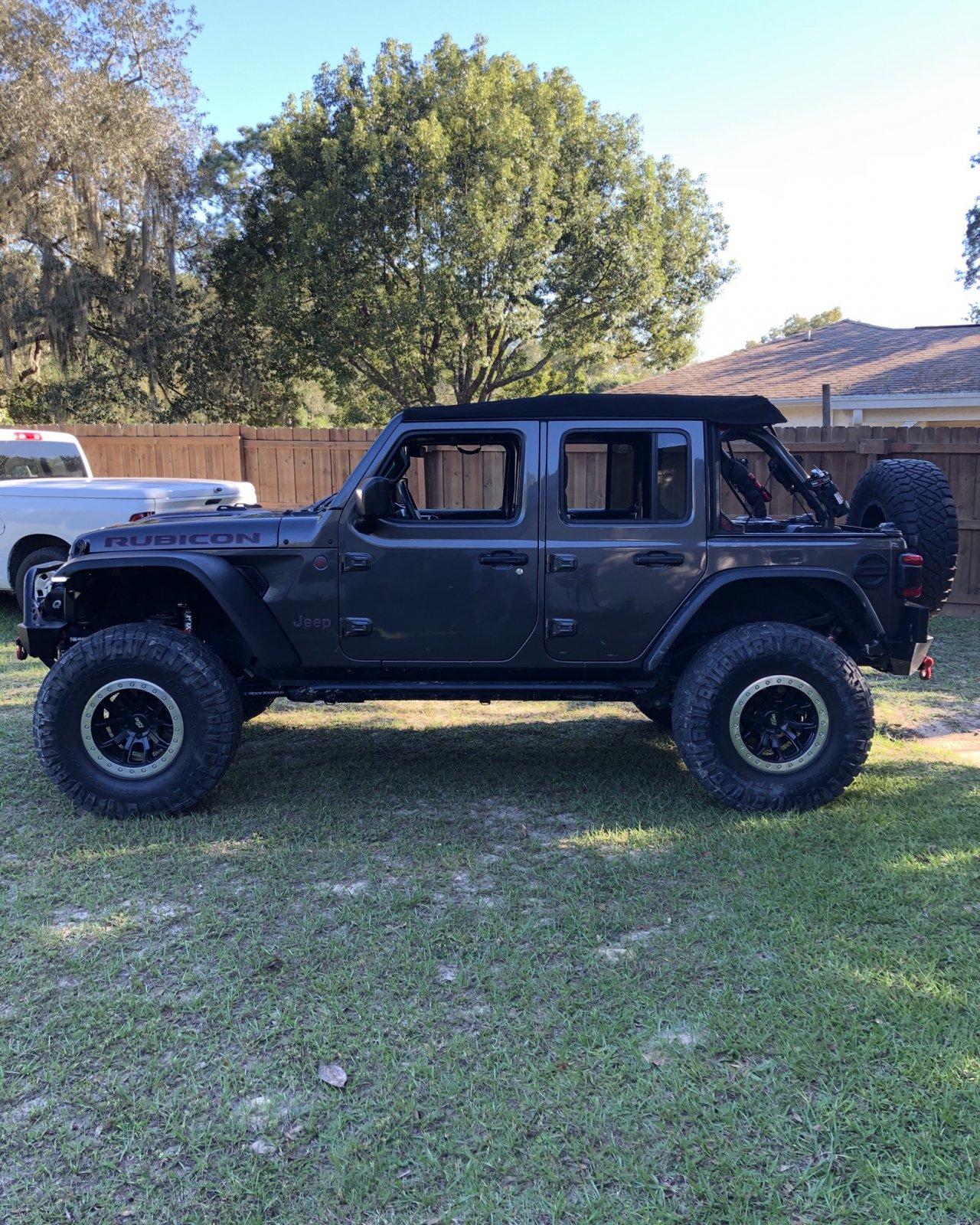

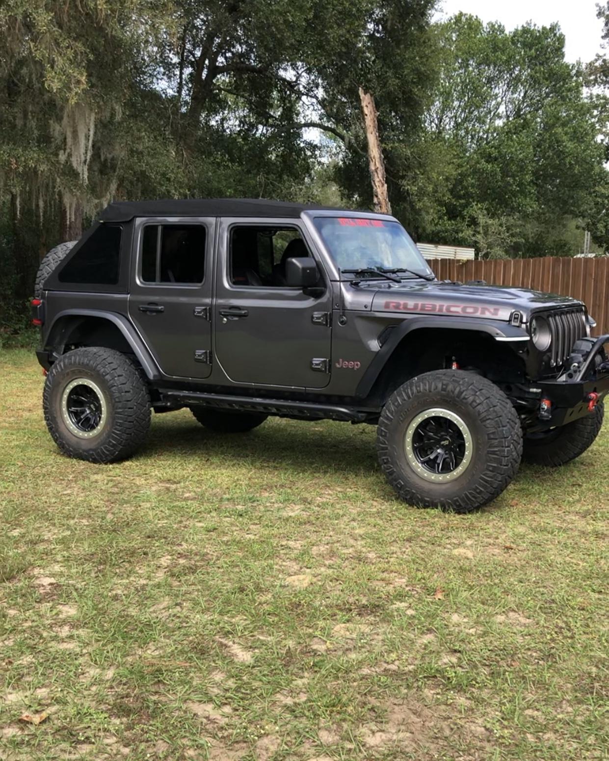

We’ve only had our Trektop Ultra on for a few weeks, but we are really loving it so far. We went with the ultra because it folds all the way down like the factory soft top does. I think the safari mode is my favorite......:)

Awesome build!
Is that the Besttop is different configurations?
I had the factory premium on my last JL but I like the look of the Besttop better. Safe to assume you would recommend it?

Awesome build!
Thanks man!...... yes it is the Bestop Trektop Ultra. And yes the pics are the sunrider position, all the way open and safari positions. I really like that there’s no zippers, uses a plastic retainer, channel system. I would definitely recommend this top. This guy helped me install it........

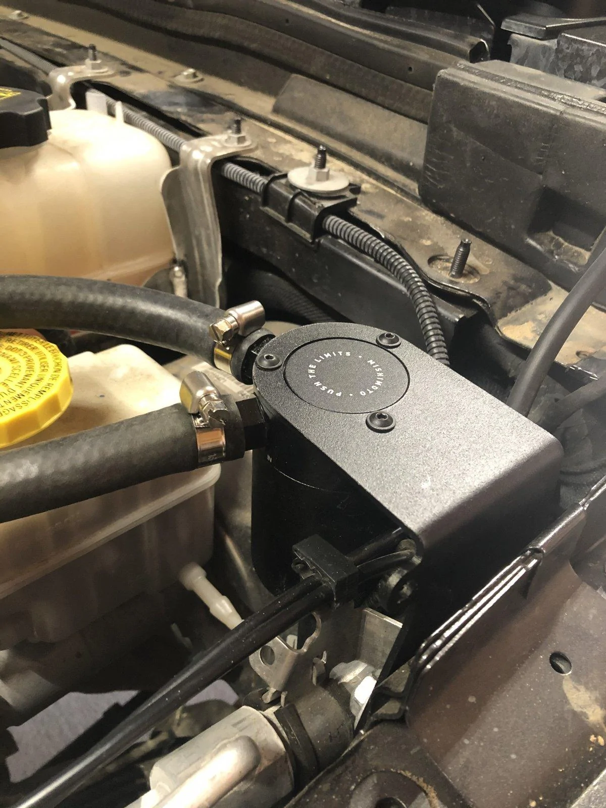

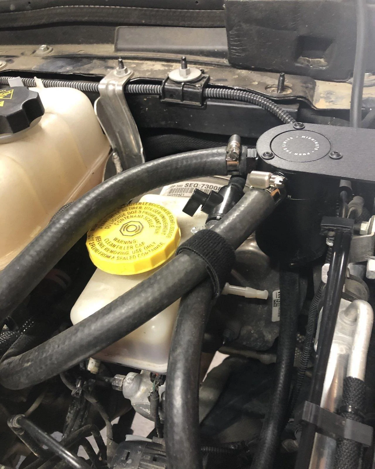

Installed my Mishimoto oil catch can today. It’s a pretty easy install. This one appealed to me because of the drain hose with shutoff valve. I didn’t want unscrew the canister, I’m way to clumsy, I could see the handwriting on the wall with that scenario, oil spilled everywhere.....:facepalm:.......
My Artec inner fender wouldn’t let me attach the drain hose where they wanted it. So I decided to just leave it loose and I tied it up with a Velcro strap for now, and I can just unhook it drop it down when I need to empty it........:).

I didn’t install it for the increased horsepower and improved gas mileage.....:giggle:....... more for when we’re on an inclined obstacle to long and avoid this.......

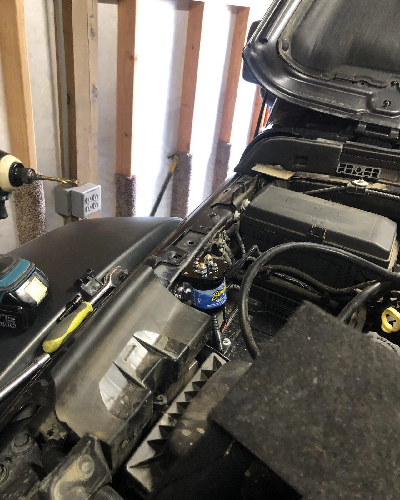

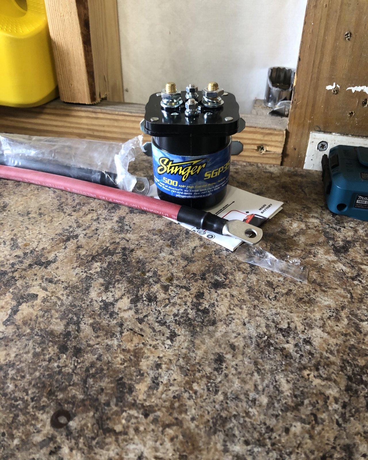

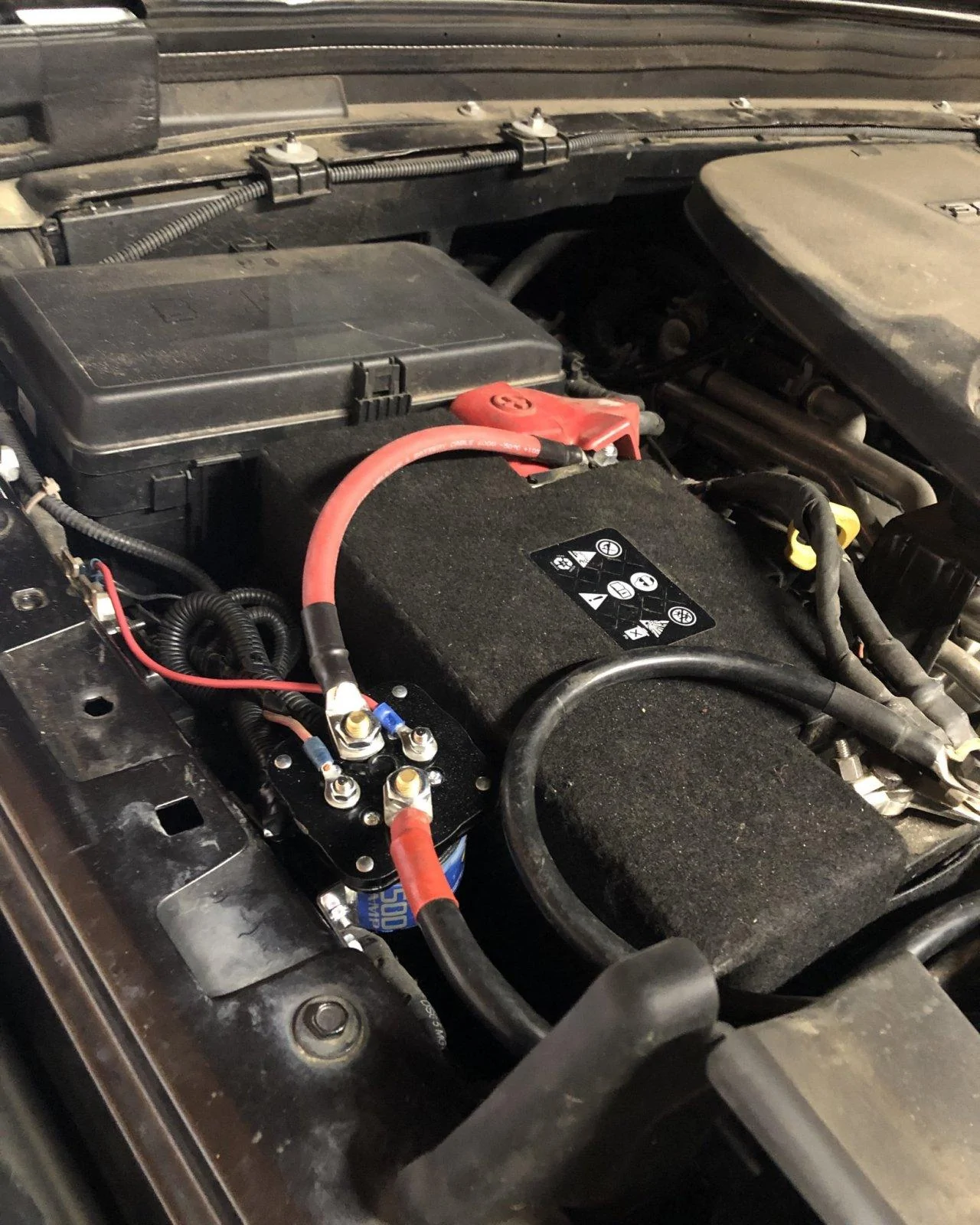

Just finished my relay/isolator so my winch can’t be turned on without first pushing aux switch #1 .
Nice upgrade!
-Steven

Nice upgrade!
-Steven
Thanks man..... it’s a preemptive measure for me, my quadratec winch has a recall for some of them can turn on out of the blue. Mine hasn’t give me any trouble, but I just wanted to be safe.
