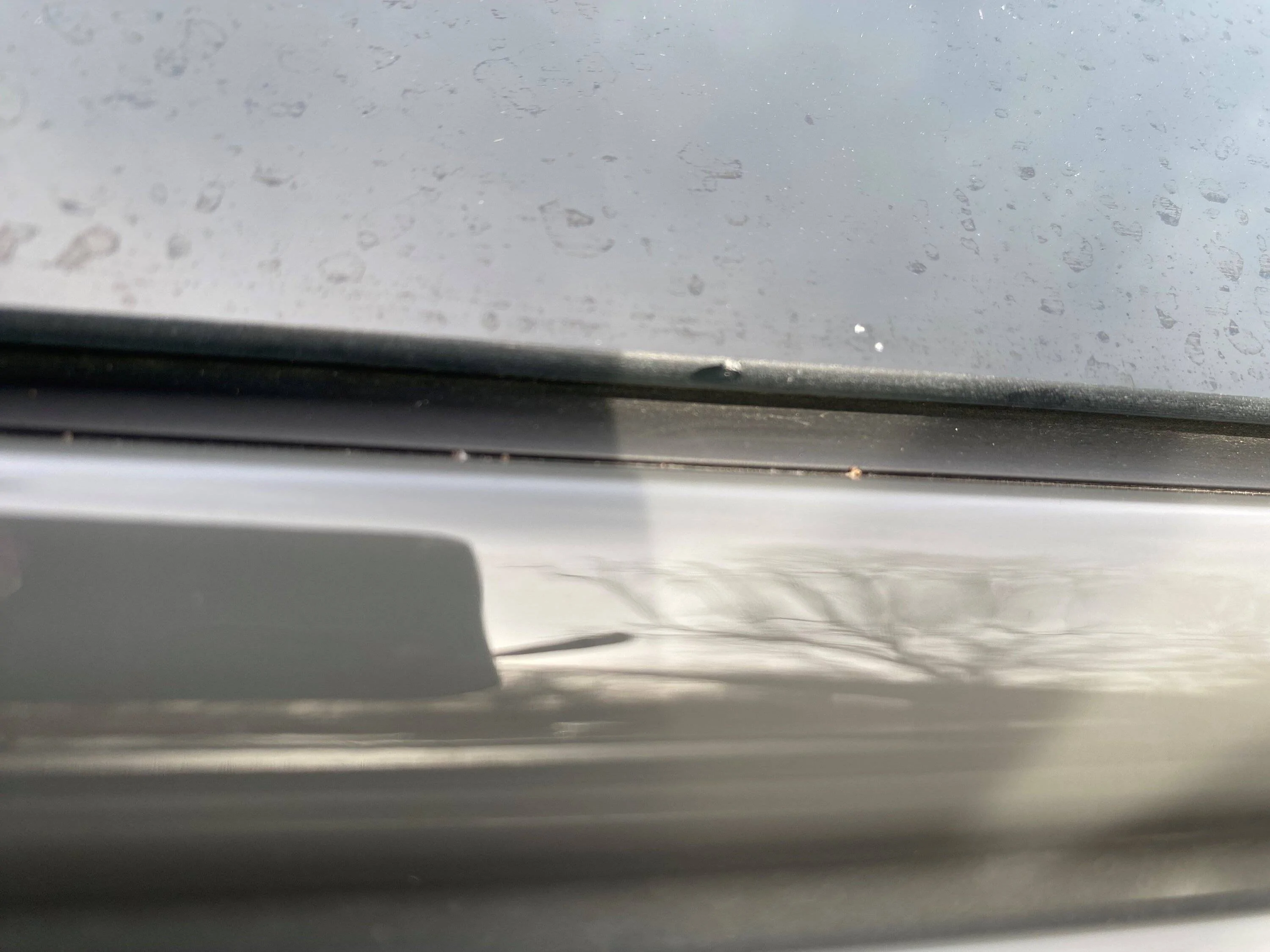

You probably had a chip right on the edge of your windshield. I have one that I'm just waiting to finally crack. Pic below. With the glass being tilted back even further from the JK and previous generations it's exposing the bottom of the glass to more chips where it is most sensitive.
