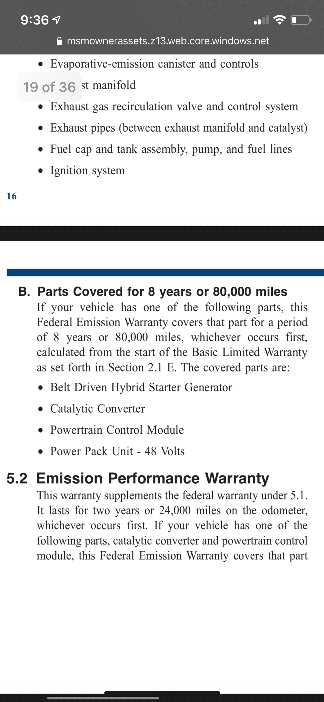

The warranty stuff is very weird - my warranty expired ages ago, but the California emissions warranty is covering my ECU replacement(not sure if this is unique to CA registered vehicles?), and chrysler is covering my steering gear replacement - all despite it only having a powertrain warranty (which only covers lubricated parts)
It’s not weird so much as it is just explicitly listed.
