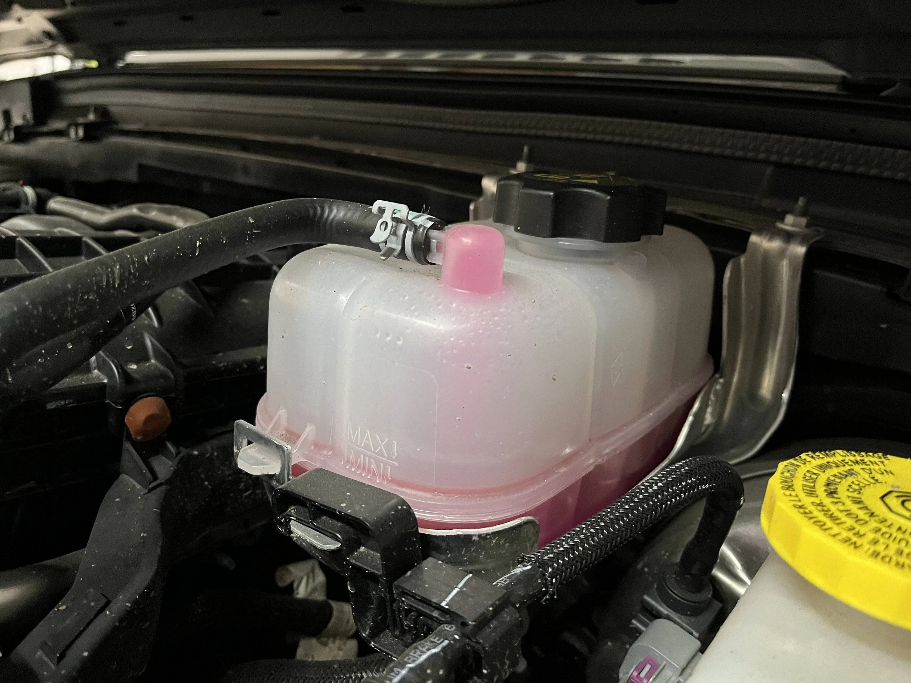

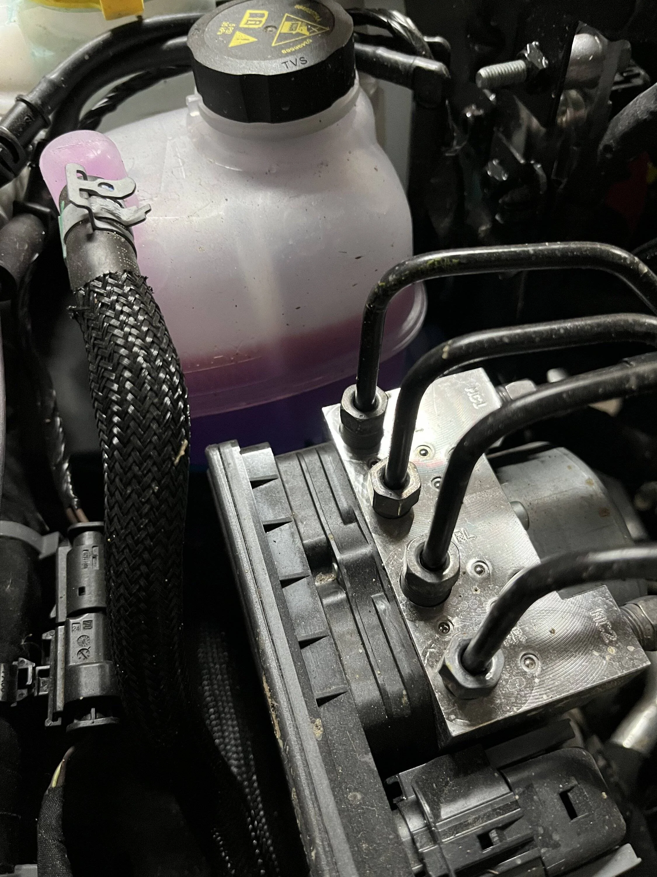

Why would the main one read near Min and the others over Max? Engine is cold.
This is normal. The MAX line is a service line for cold. As long as it's above the MIN and close to the MAX line, you'll be fine. With the fluid so close to the MAX line, you have nothing to worry about. It's not that sensitive where you're going to hurt anything. Service everything to the MAX line cold and you'll be fine. (You're perfectly fine as it sits right now, as well.)
