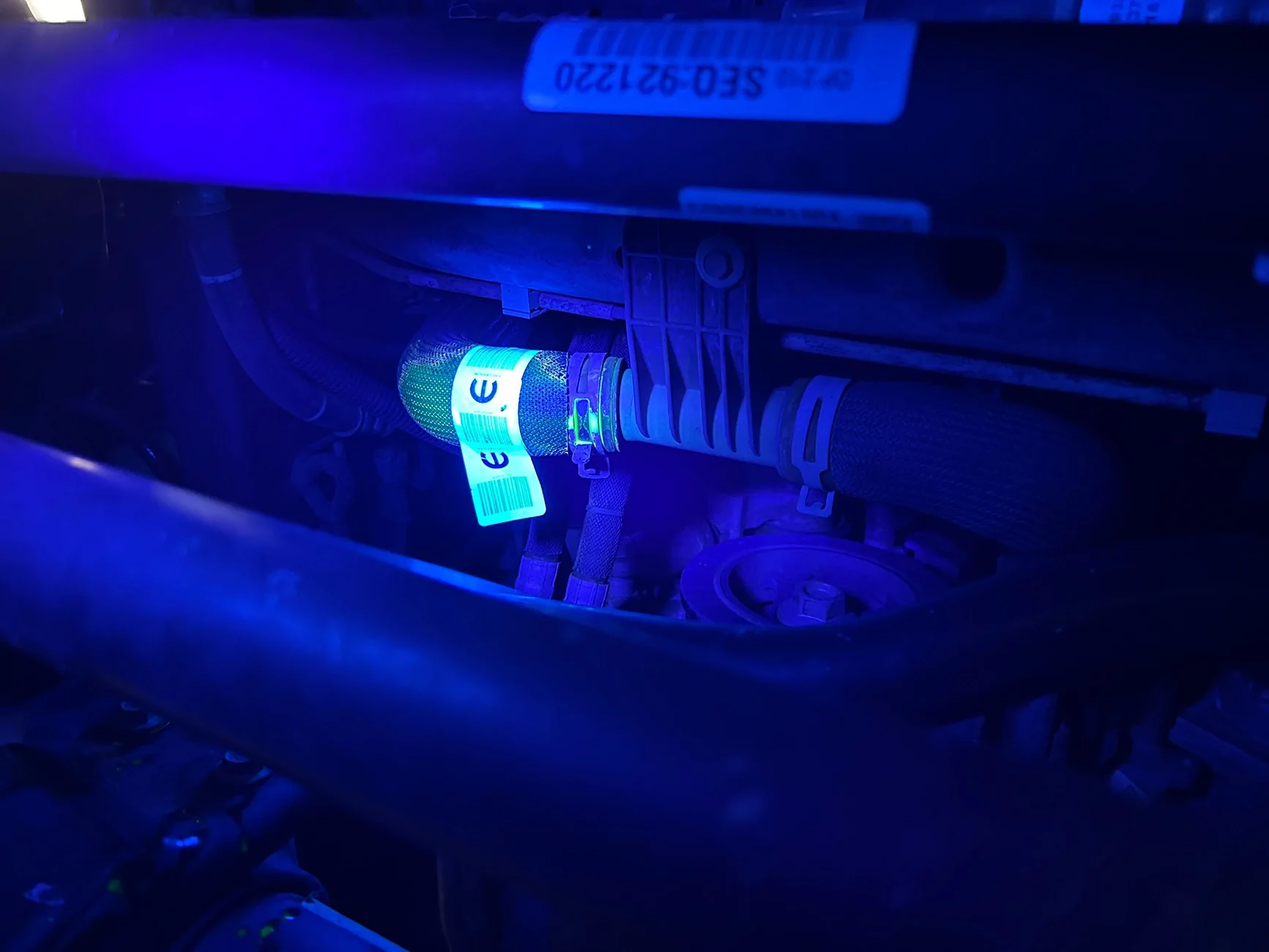

I had the engine oil cooler replaced and then developed a couple of coolant hose leaks: one near the EGR cooler and one below the radiator. I found those by using the coolant dye.

Here’s some picks of the leak I found with the dye:

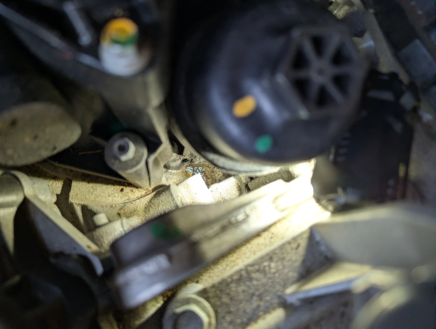

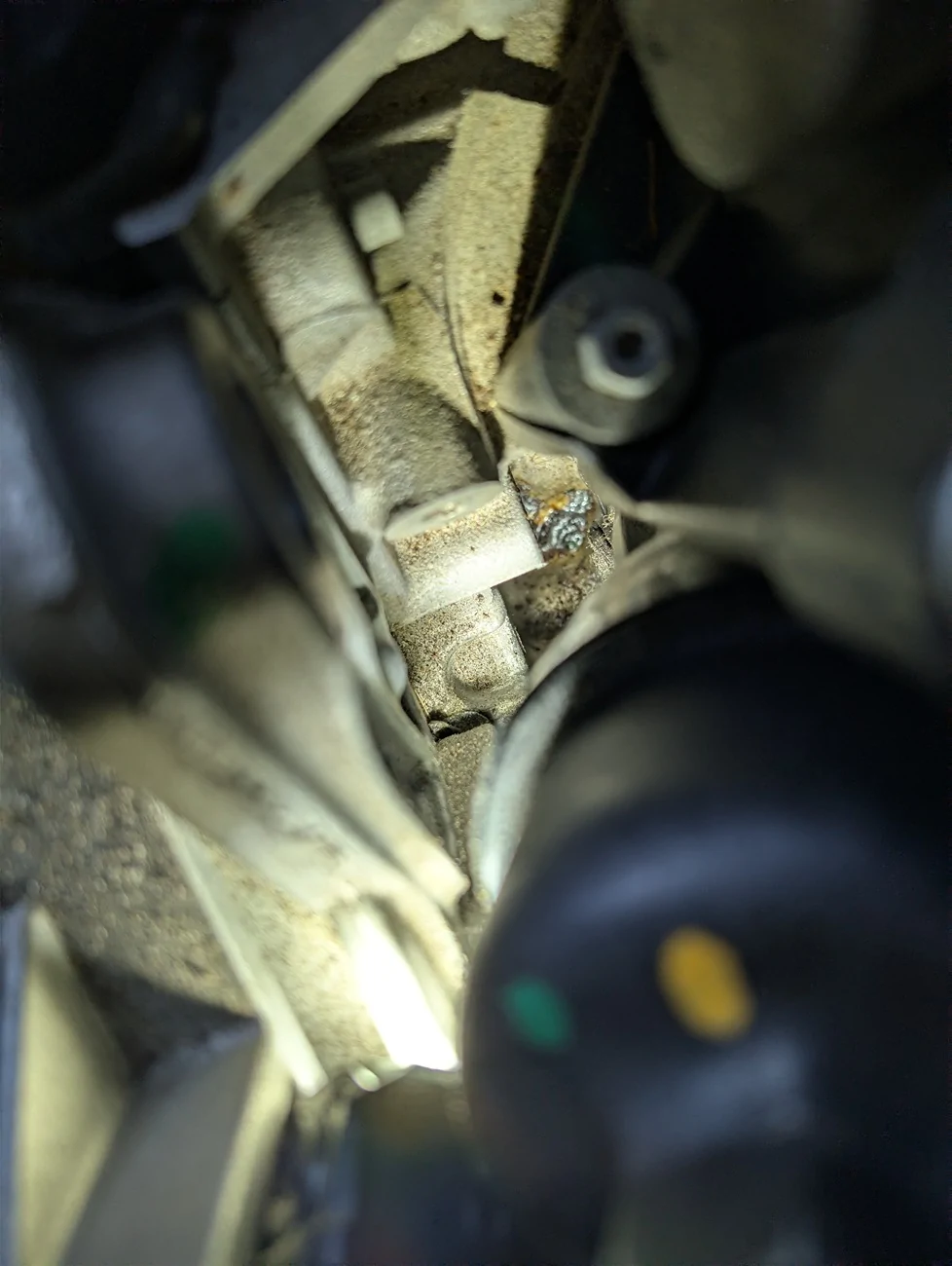

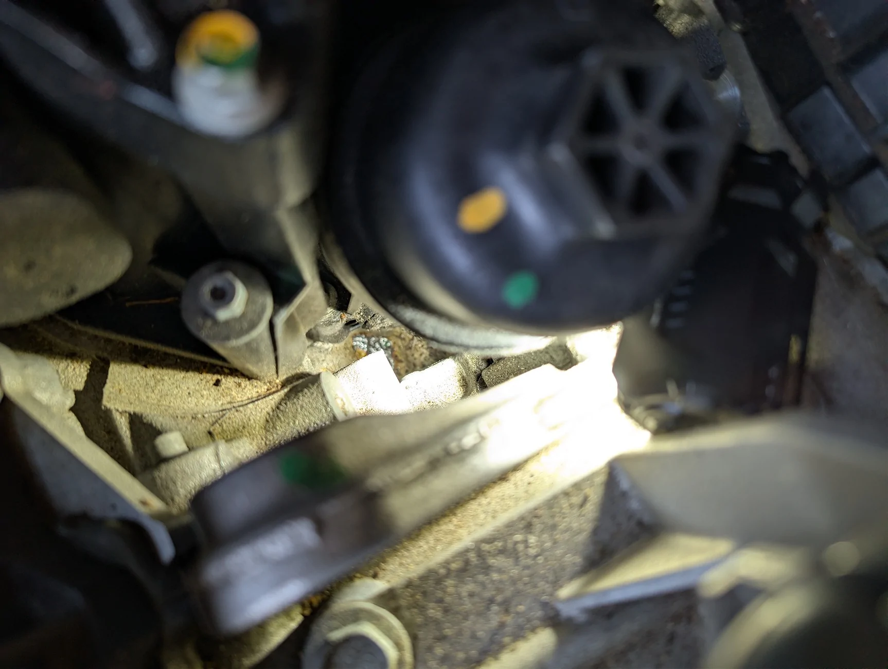

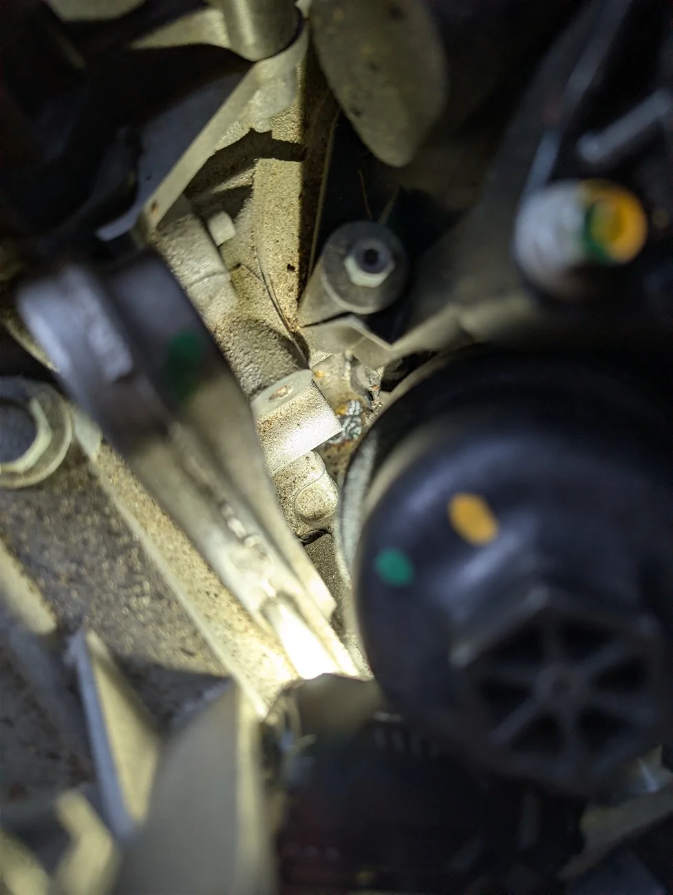

Meanwhile since I was already in there I did try and check around the oil filter housing in the engine valley and I didn't really see anything pooling. I did see a bit of old oil buildup, which I imagine is from dripping when taking out the filter? I tried taking some photos but can't say they're really great LOL

Looks good to me. I don't see any evidence of an oil leak there at all. Let us know if you see a wild swing in coolant level.
