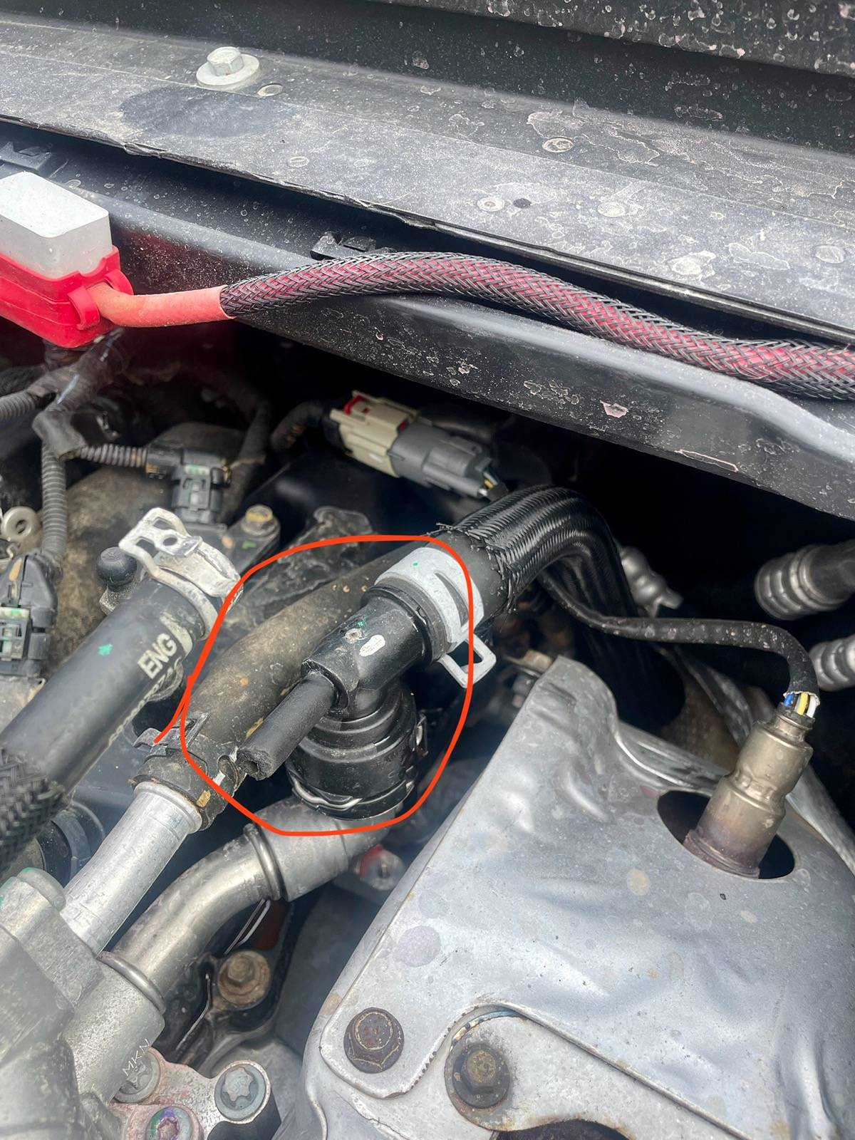

Assuming this plastic part is supposed to have some sort of nipple or etc at the end ? Anyone know the part number for this piece. Been having a loss of coolant/coolant leak lately and after being serviced at the dealer and driving home, hose either blew off or wasn’t reconnected and out went all the coolant. ?

Looks like it's been chewed on by a mouse...and the hose is missing....
On my 2.0 that is a hose that T's into the black coolant reservoir...

Think the T and two hoses are part of a single assembly.

I pulled the hose off to show pictures of the damaged piece.

Looks like the heater tube with the valve on the end. 68280784AB HOSE/TUBE-Heater Supply

looks like a rodent chewed it off

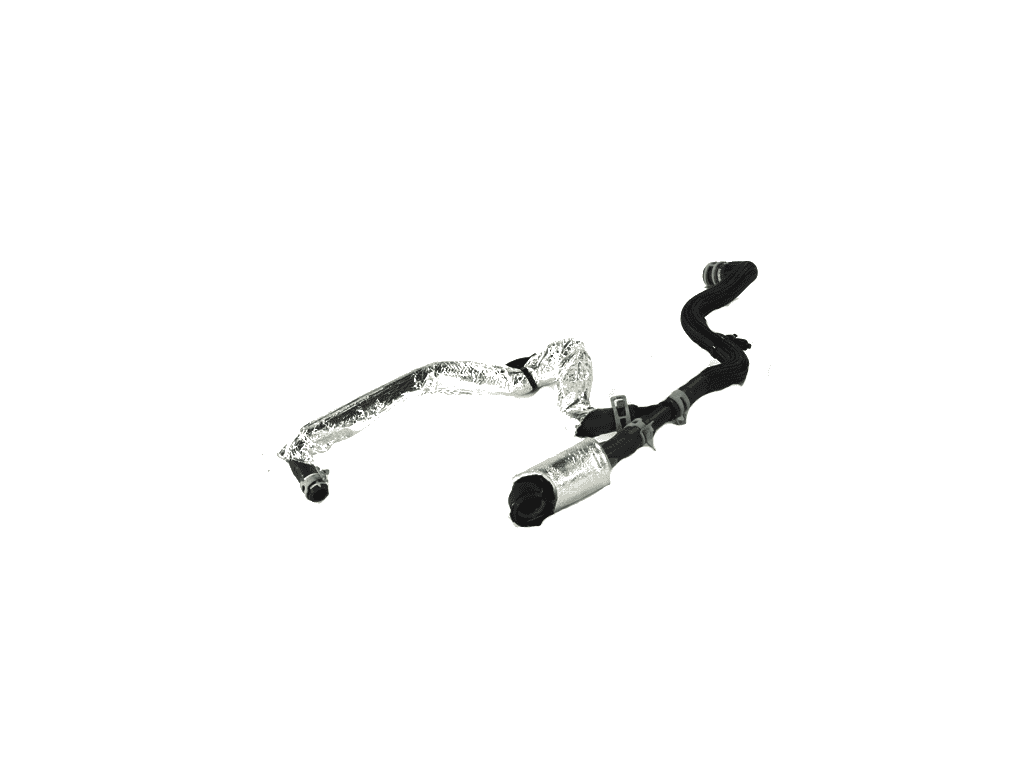

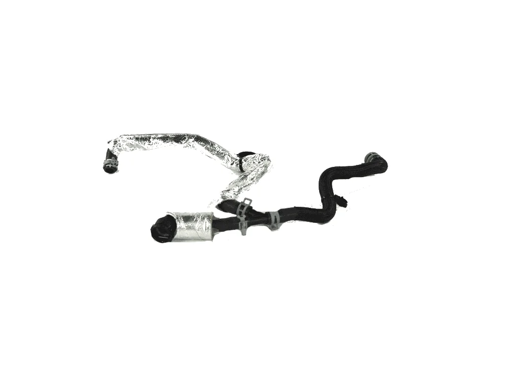

Do you possibly know the part number for the piece that also feeds the other side of the T piece ?
The hose that connects to the nipple? It appears to be 68280800AE but my schematics are lacking a bit in this area. Here are photos of said part
