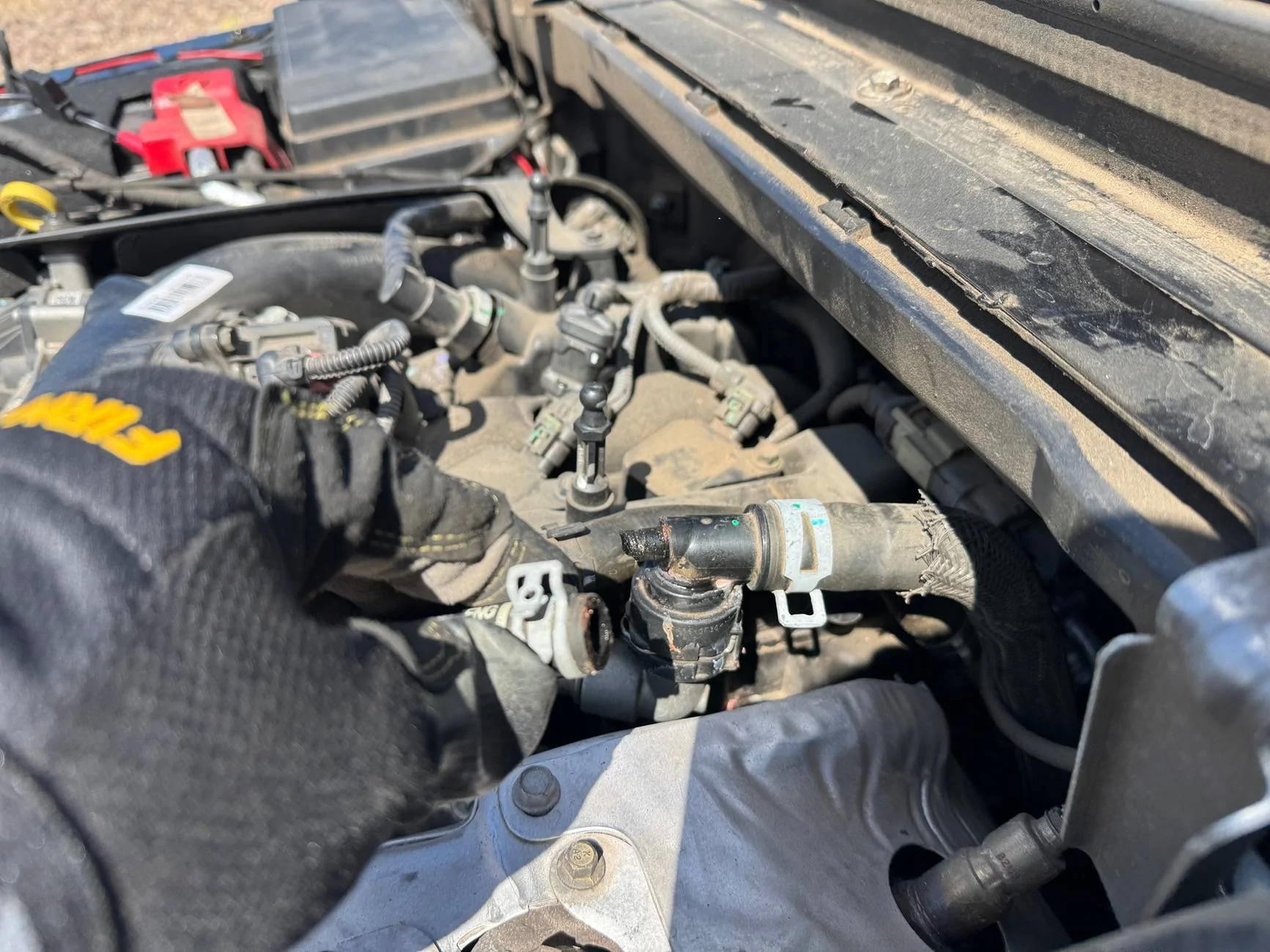

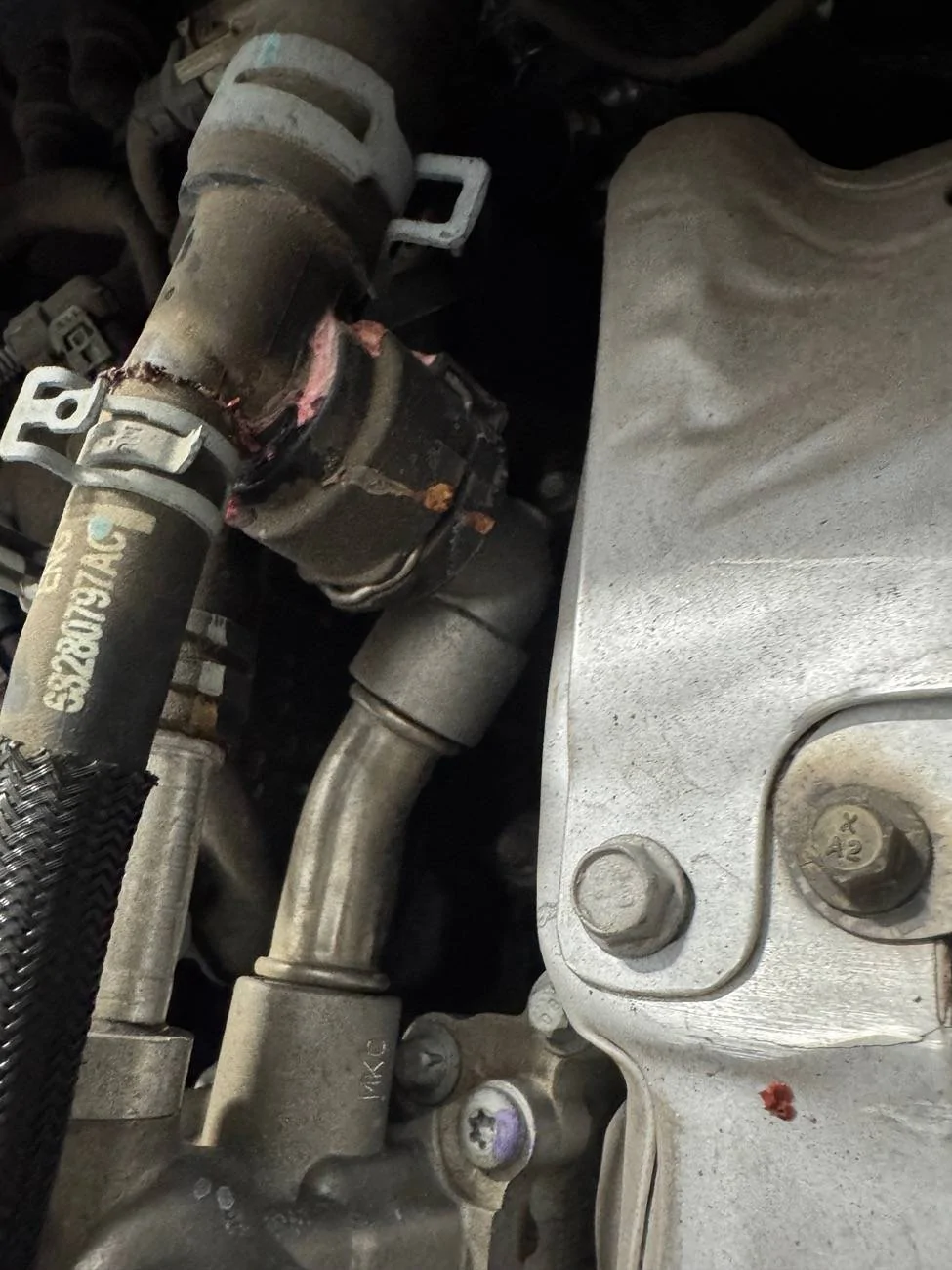

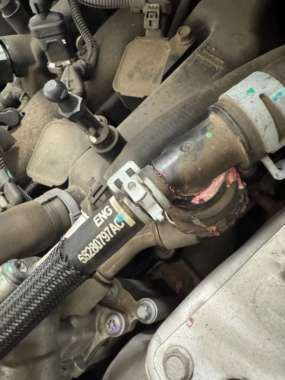

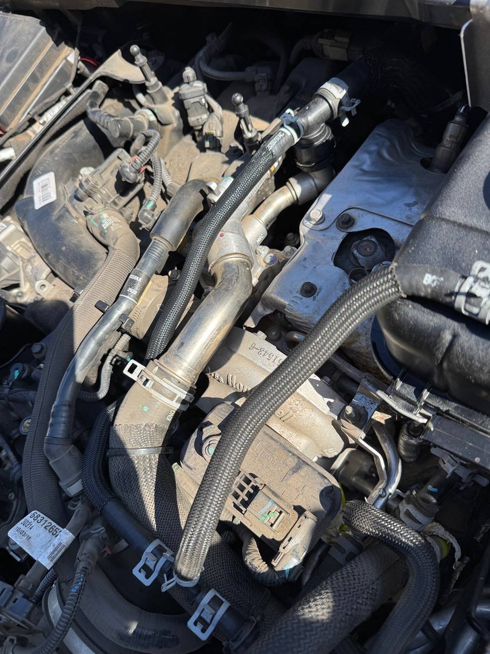

Mine is extremely loose. The Jeep seems to be losing coolant from there.
Might want to pull the clamp
Off and hose and see if the piece below it still has the plastic nipple around it. I’ve heard several people saying those degraded on them
Didn’t take it all the way off but there’s a good 2” under the hose

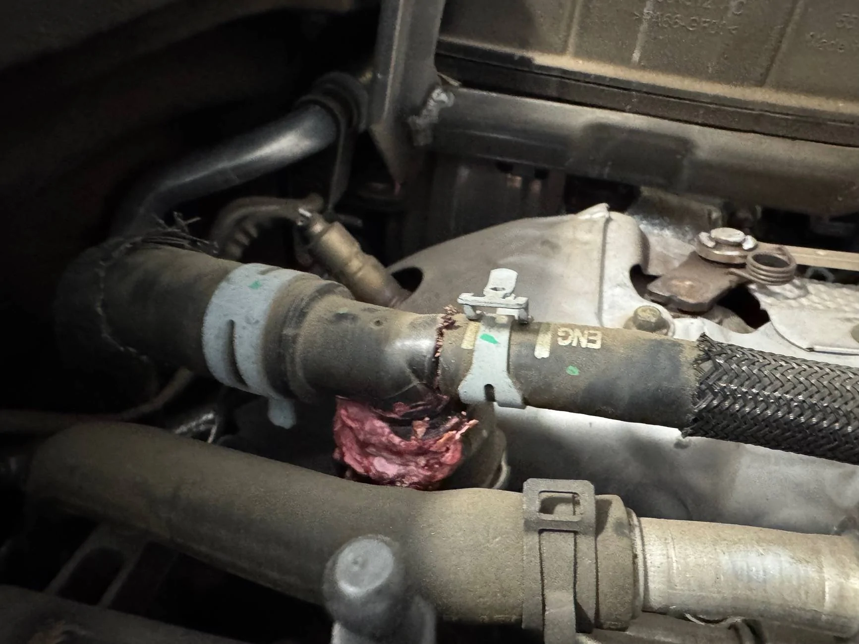

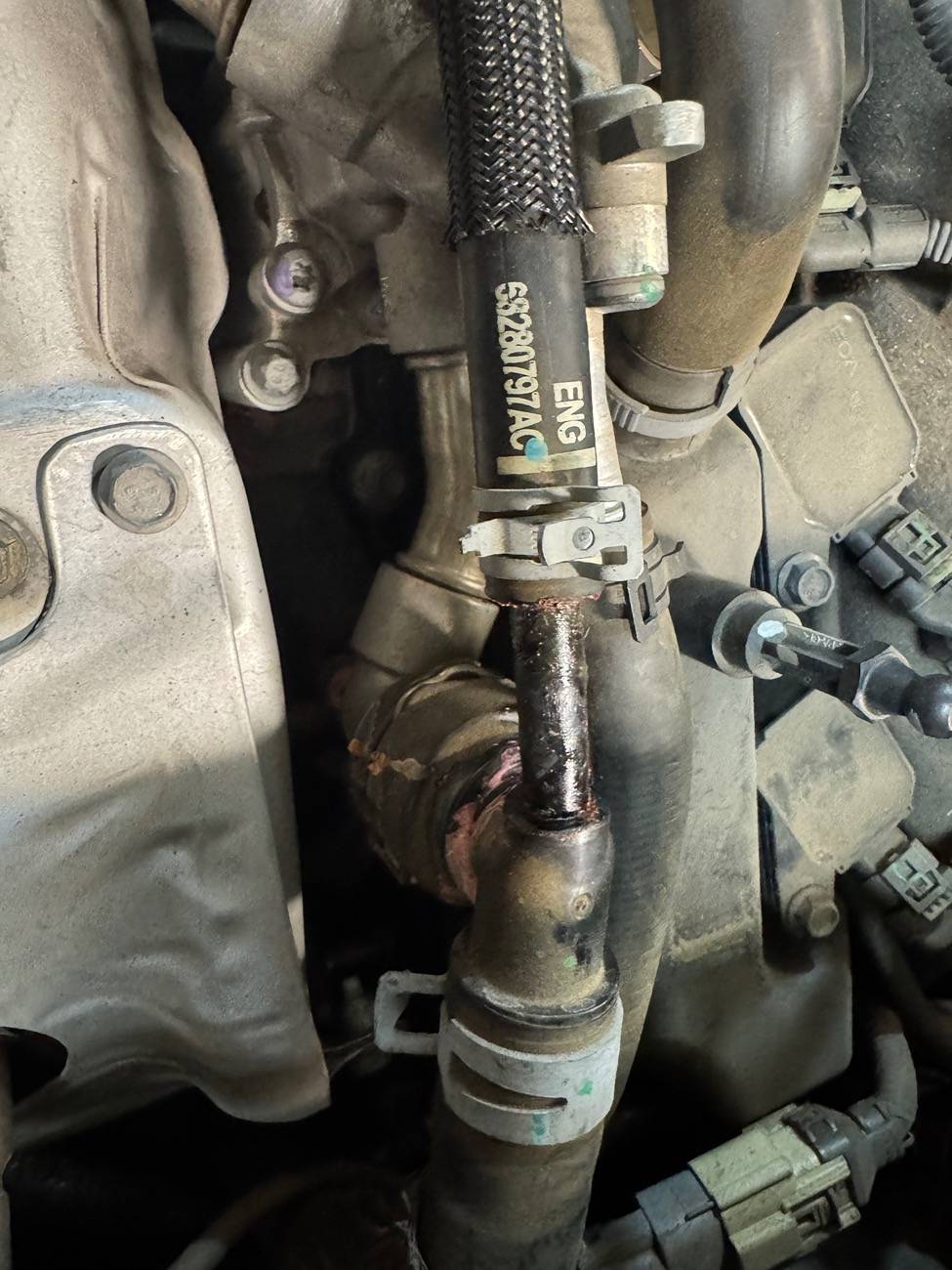

Actually, it was it. I don’t know if it was just me testing it out and checking on it or not but after the wife came home I checked it again and sure enough it broke right off.

Wondering if it’ll be ok to drive until the part is delivered

You can drive it, for a short distance before it pukes out a significant amount of coolant! Pay attention to the temperature gauge!

These plastic coolant parts SMH. It’s biting Stellantis in the rear on the Hurricane too.
Anyone have a pic of the metal line with the plastic off? What kind of connection is that. Seems someone might be able to fabricate an aluminum replacement.

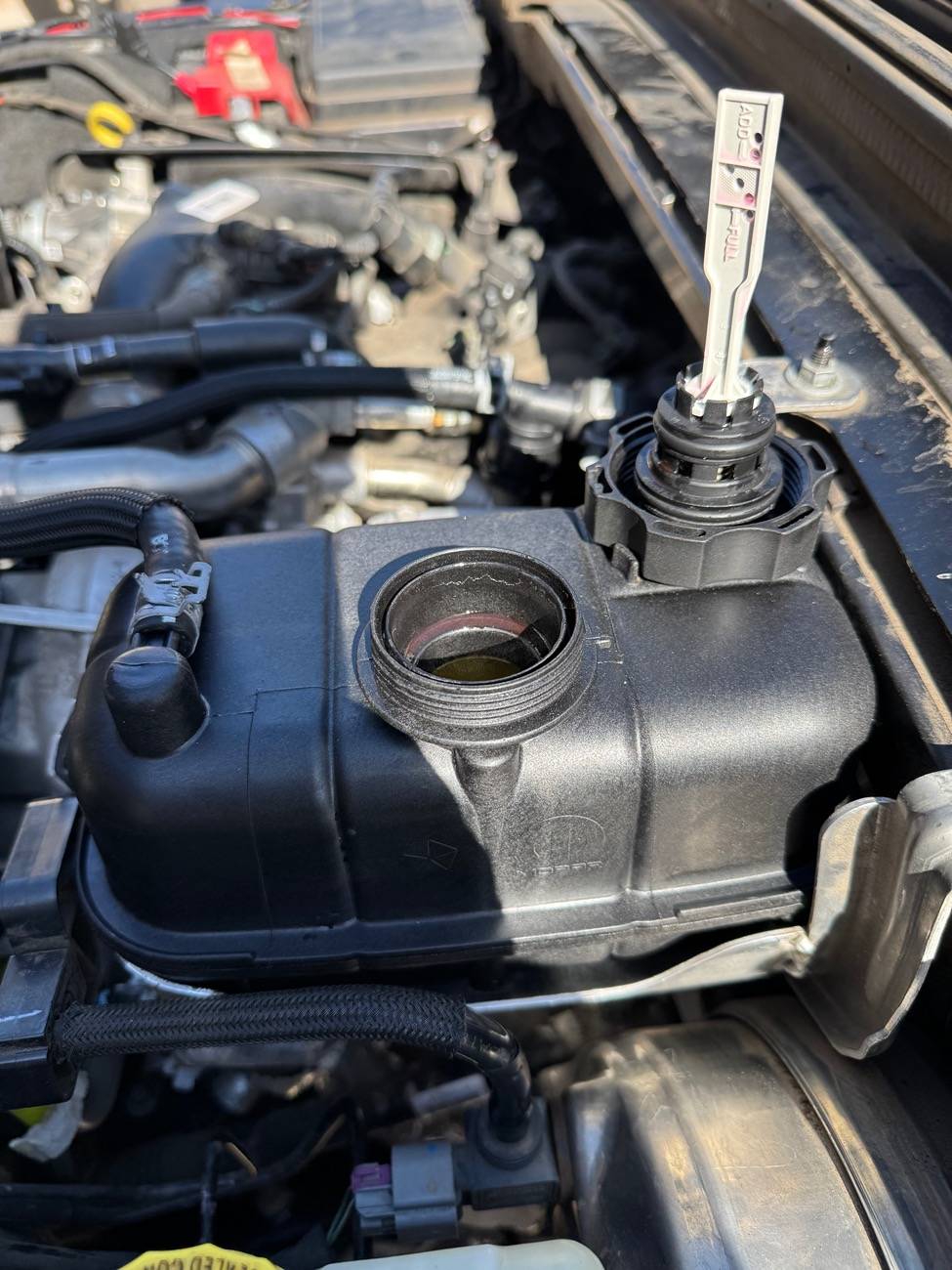

Replaced the heater hose/fitting and while doing so the coolant reservoir cracked. That will be delivered today.
