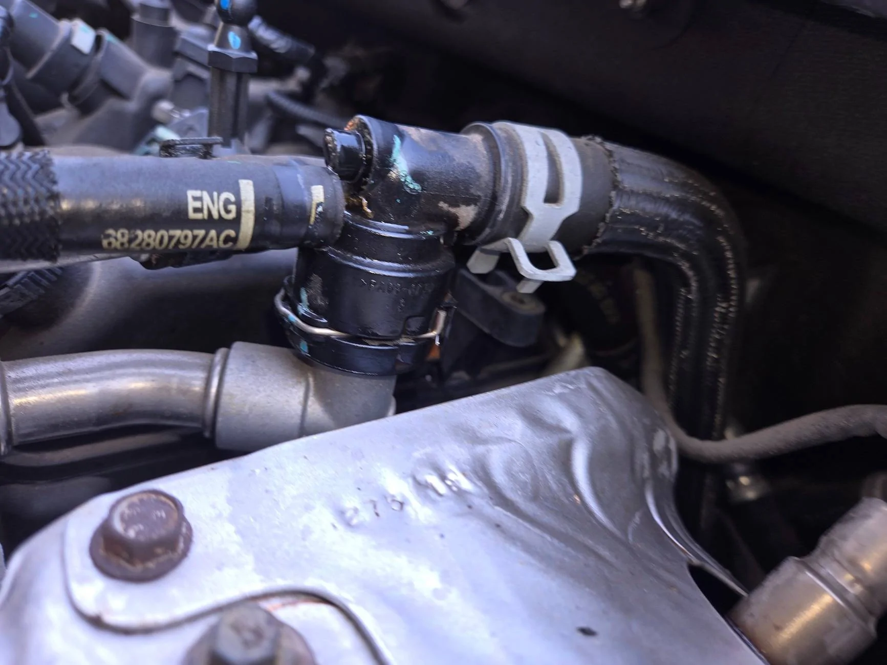

The plastic part of this part of the coolant line that runs to the overflow snapped and I have a new one coming. Just curious how this T is removed. Looks like there's some sort of retaining clip around the base.

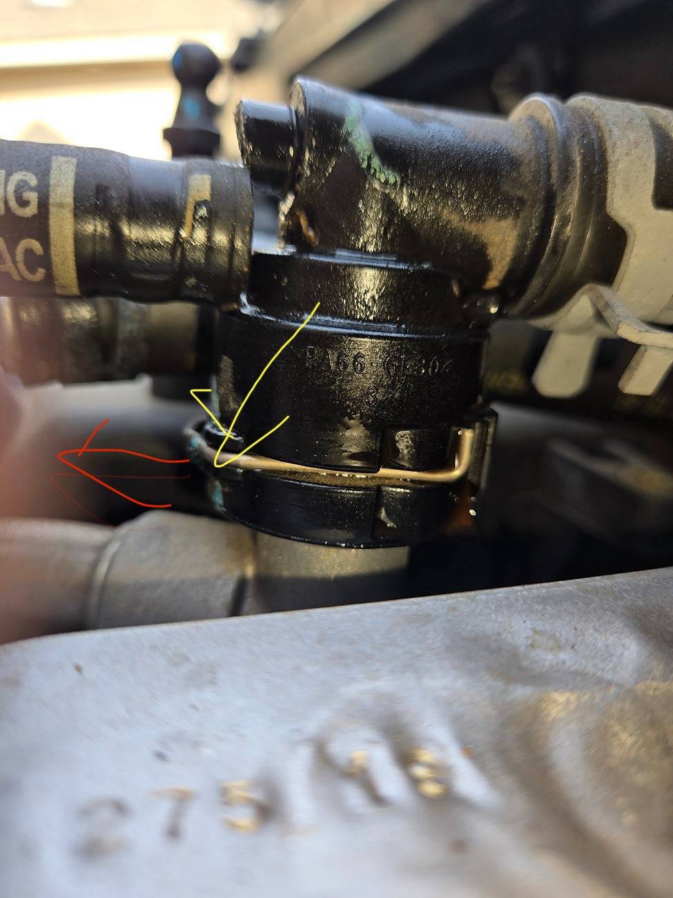

Put a hook behind the wire at the yellow arrow and pull in the direction of the red arrow.
Jeep Wrangler JL Remove coolant line fitting IMG_8770
Then the fitting just pulls up.

It's the bigger version of the trans cooler lines. As Gregj showed, just pull the clip out and then lift the fitting off.

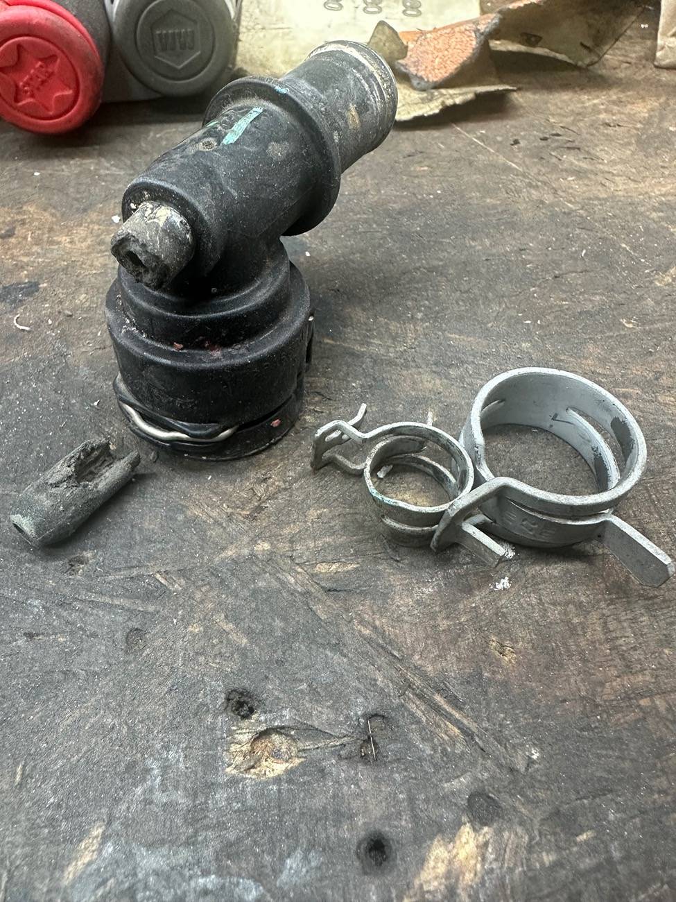

Pull the retaining clip back then lift up on the plastic fitting. I replaced mine last week and it was pretty tough to get to come up and to reseat, especially trying to be careful not to lean on any other plastic parts while doing so.
