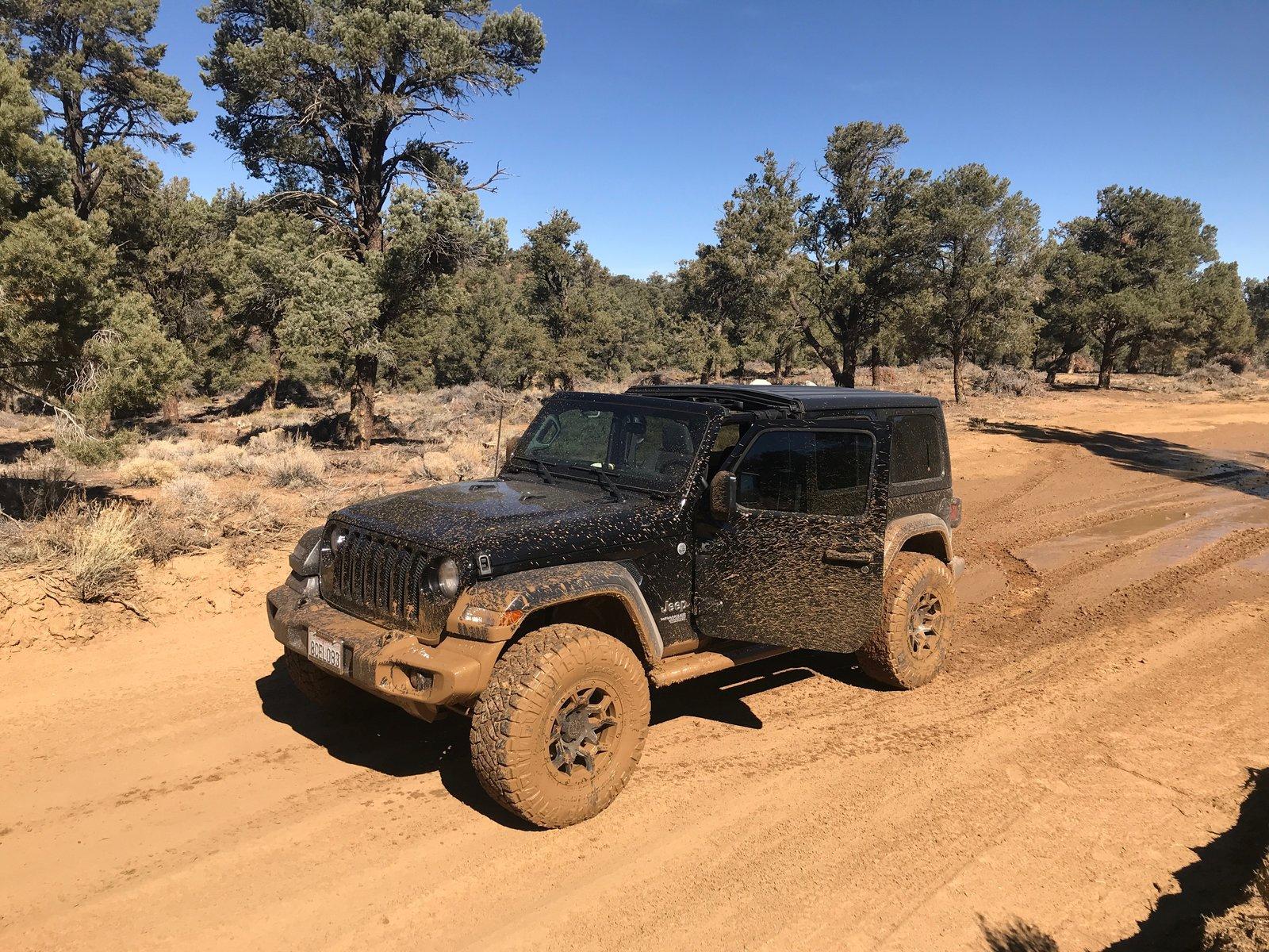

Hi,
I went off roading yesterday at Big Bear, CA (had some much fun) at the end of the trail there was mud in it and i went through it and it was awesome. The only thing is that when i opened the hood, it was full of mud. Do you guys know if i can just get a hose and spray some water in it try to get that mud out the engine? Any recommendations? If i can spray water, do i need to cover some sensitive electric stuff? Should i be careful with certain components? Thanks in advance..
I use a foam cannon and spray the shit outta my engine weekly. Then again, I'm pretty much a 90% mall crawler and have a habit of being military-trained anal retentive on washing vehicles.
But If I were you, I'd do two things: 1) get a foam cannon , 2) foam the living crap outta it, 3) maybe close that sunrider the next time you hammer into that mud? Kidding on that last one....holy crap that looked pretty cringe-worthy to me...mainly because I would be so dejected if a fountain of mud cascaded in through my roof. I'd probably cry. Just being honest.
I do run my Jeep through the local brushless car wash (basic wash, no wax or extra crap as the soft-top gets foam that I have to spray off at home) before foam-cannon'ing at home after being on the trail. Helps alot. Guy hates me. Probably should stop doing that out of consideration for others....but it works great at getting rid of alot of crap on the rock-rails, inside wheel wells, etc.
There is nothing that will die or wither on the vine if you foam the crap outta your engine and spray it off. I'm talking power-washer spray. But not the "strip paint from the house exterior" power-washer pressure....like the diffused nozzle instead. Do the same underneath too.
