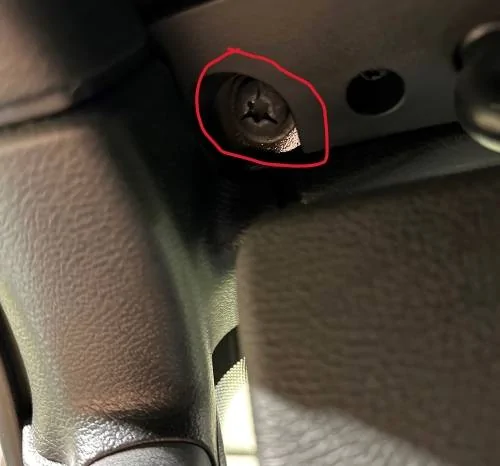

After reading your post, I checked mine. Both outside bolts were loose. Thanks for the heads up!
40 Torx. On both sides for outer bolts.
Just checked mine and same thing two outside loose, the inside ones were tight.

I just went back and put Permatex Threadlocker Blue Gel on my windshield bolts and torqued them to the proper torque specs.
168 inch pounds or
18.98 newton meters or
14 foot pounds.
This torque spec snugs them up very tight and they should not loosen up.

OP here: A reminder, I started getting a vibration from the front (of the cabin) of my Jeep and I remembered these fours bolts. Sure enough, the two on the right-side were very loose. Haven't test driven it, but I'm sure it was the problem - just like last time. The Torx wrench in your Jeep tool kit fits them. My previous tightening lasted eleven months.

Had not looked at mine anytime recently, but started monitoring and sure enough, in my 2018 I was getting a rattle. Turns out the outer bolts had backed out again (I really do need to apply Loctite). After tightening all is good to go again. Will have to keep up with it in both our 2018 and 2024.

The bolts on the left side of the windshield have been loose multiple times, the bolt near the driver door was extremely loose. I put a drop of blue loctite on each one and they have not loosened up in over 2 years. You don’t need much loctite to do the job.

There are four recessed T40 bolts, two on either side of the upper windshield (inside the cabin). They tend to work loose and cause mysterious rattles. The wrench in the green canvas Jeep tool kit will fit. Take a moment and tighten yours.
