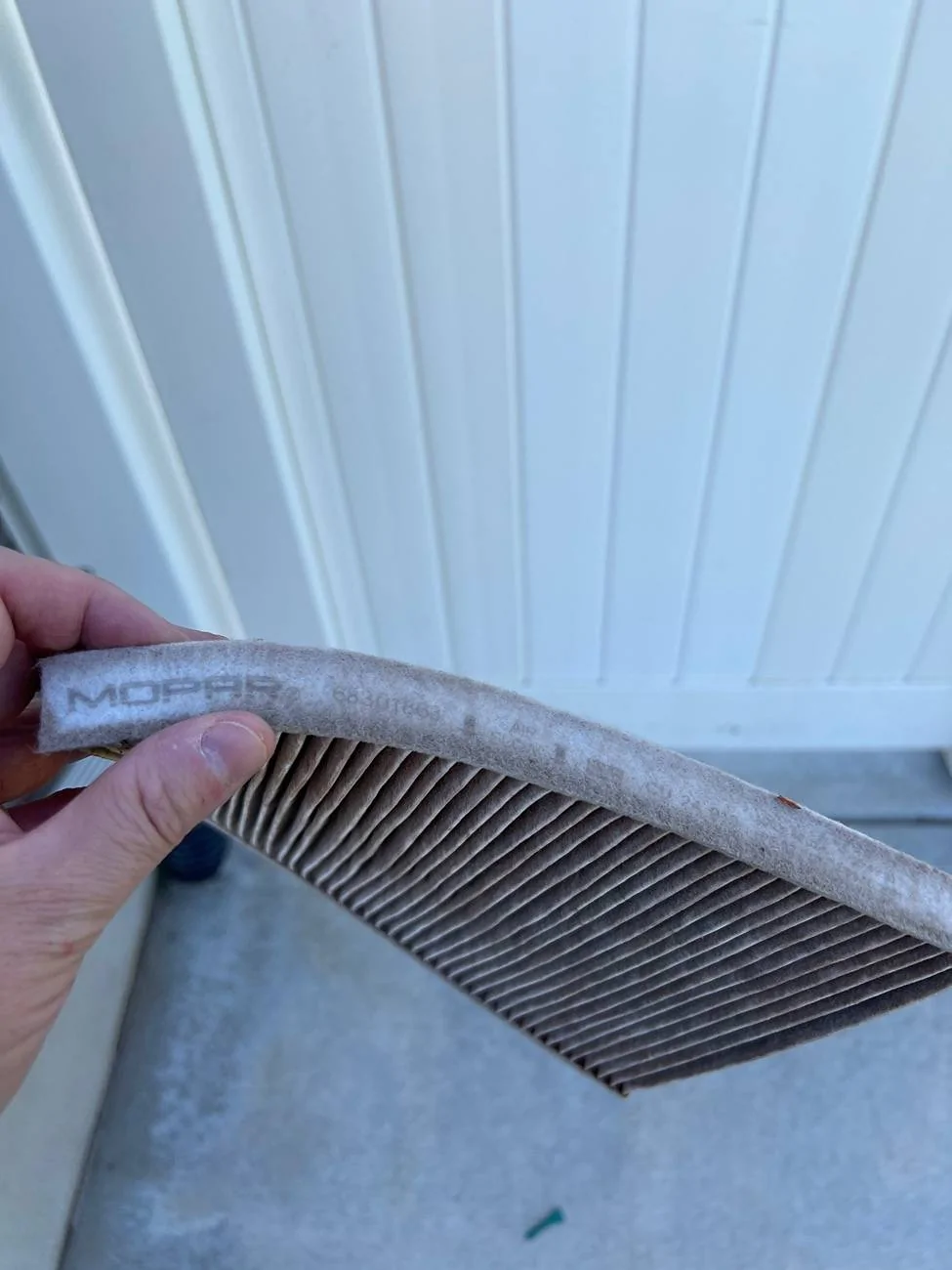

My 2024 Rubicon X was not cooling the cabin very well over the holiday weekend.
My compressor kept shutting off and interior temperatures were in the low 90s.
Air for from vents was very poor.
My Jeep has 12000 miles on it. It's not even a year old.
I checked the cabin Air filter and this is what I found:
Jeep Wrangler JL Check your cabin Air filter PXL_20240707_155602998~2
The amount of dirt in there was impressive.
Replaced filter and all is back to new operation, cold and plenty of air flow.
Anyways, just a friendly reminder, change your filter and your AC will work much better.
Jeep says every 10000 miles if in severe conditions, otherwise 15k to 30k. I think I'm going to change it every oil change after seeing this.

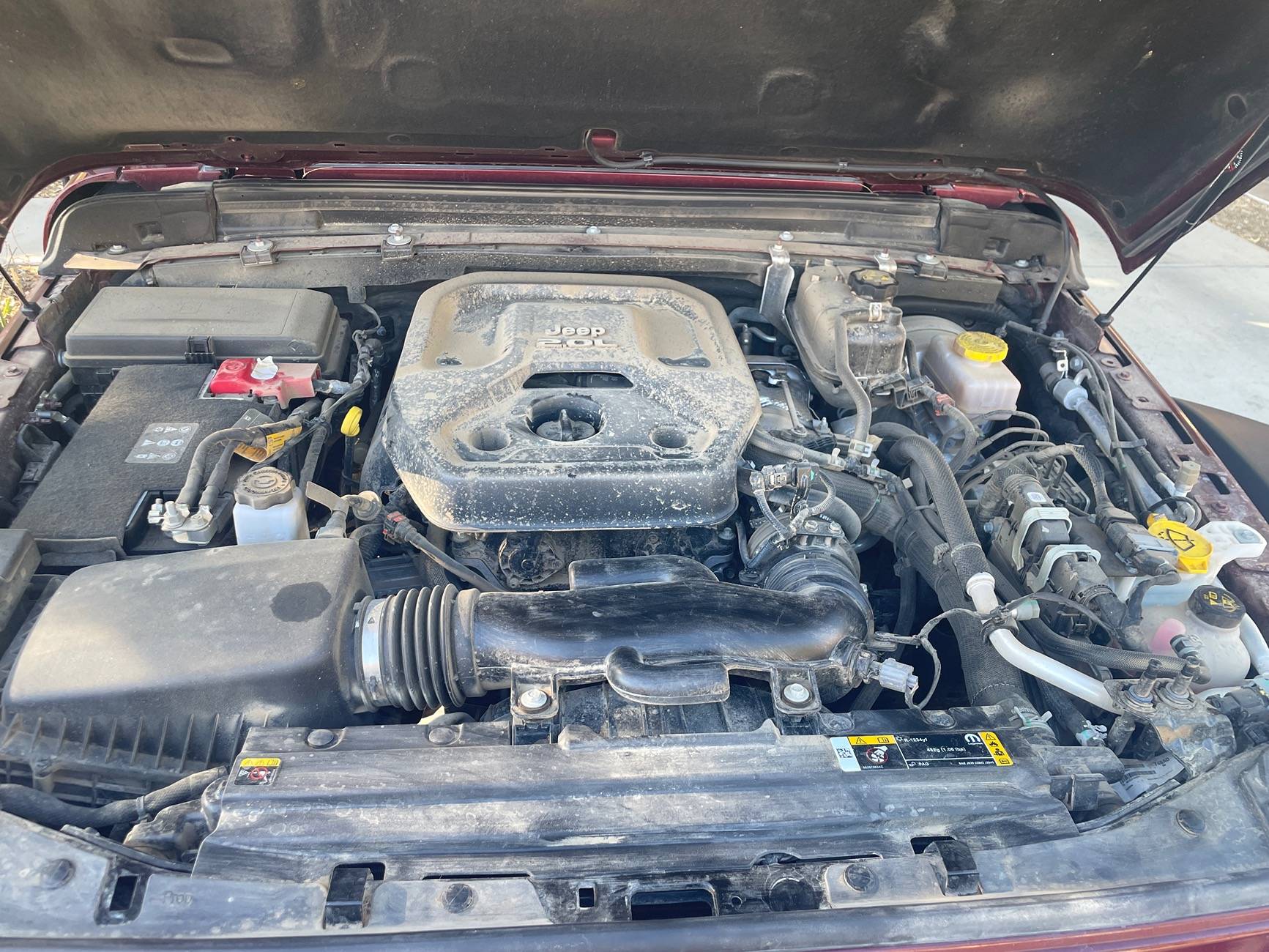

Super fine granite dust dirt roads here, I pull mine and blow it out with the air compressor after about every other trip. Thanks for the reminder.
Update. It was dirty as shit!
