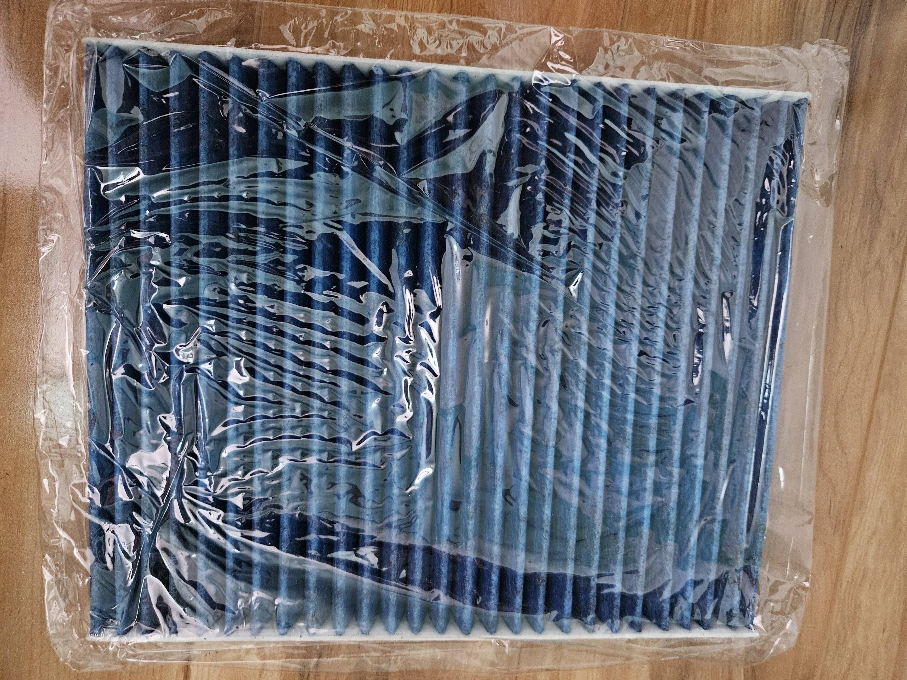

After reading posts from a forum member @Mastergmac in regard to this very inexpensive, Made in China, HEPA Cabin Air Filter Fits for Jeep Wrangler(2018-22 23) Gladiator(2020-22 23) Activated Carbon Cabin Filter, I ordered the offering, it was delivered and I installed it today.
This cabin air filter seems very well made and the fit is aok.
The filter, because it has 5 layers is a tad more rigid then the OEM cabin air filter... but it slides into the cradle without problem.
I should also mention this activated carbon filter has no odor to it.
Note: The Cabin filter on Amazon, I linked to has no up or down arrow on it.
DO install this cabin air filter so that the Blue Side is facing UP when it's in the cabin air filter cradle.
Yes, as the filter is 5 layers and has activated carbon in it, I do know I will be changing it a bit more frequently then I would if using a 2 layer, no activated carbon, cabin air filter.
I just placed an order for more... for future use. Terrific price at about $8.00+- each.
