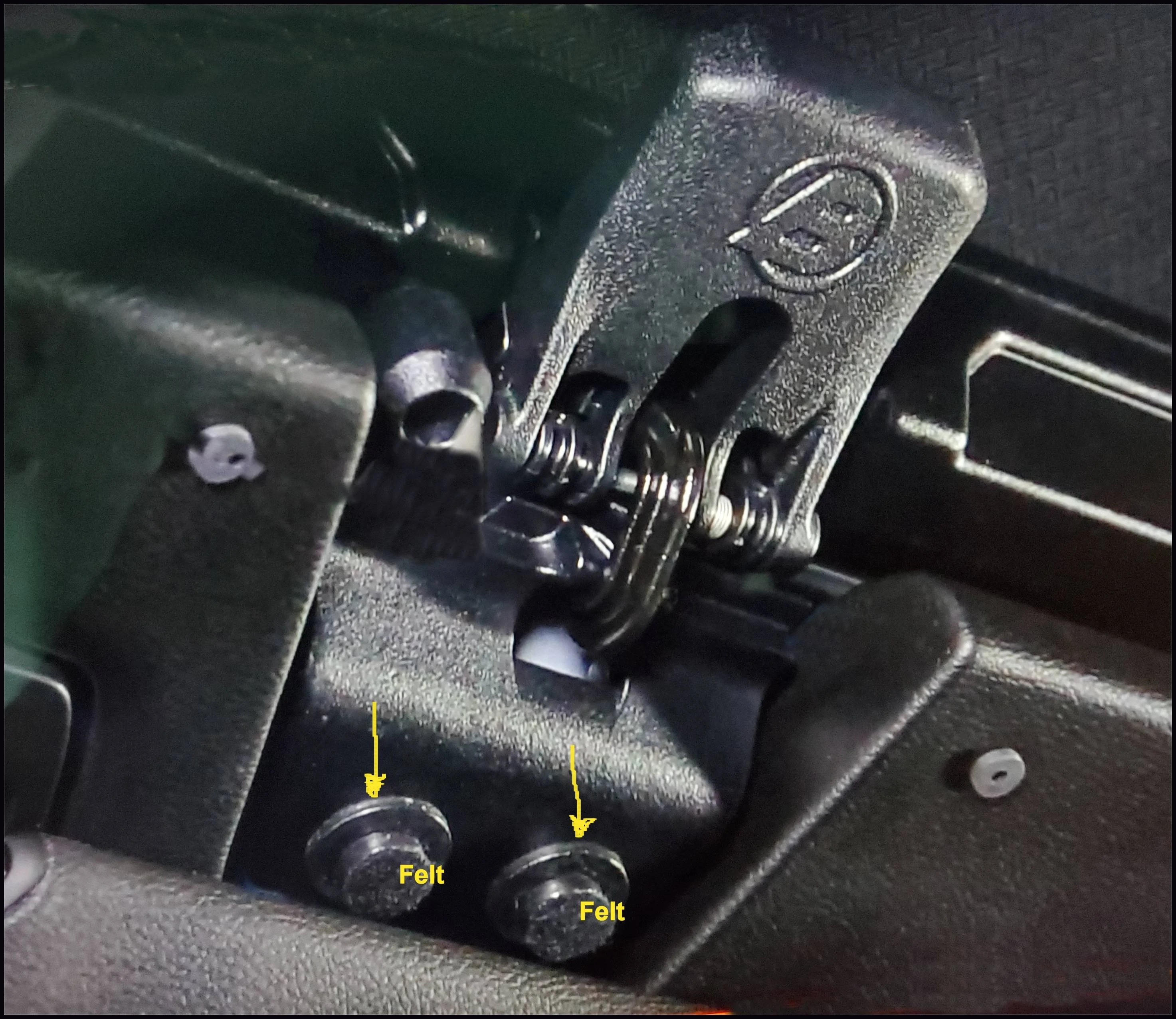

@Upnarms
In regard to the latches for the Freedom Panels, you can adjust them a bit and the adjustment does lets say firm up the latch handle a bit.
Go to the latch and look for a small circular felt pad. Gently peel the felt pad off and place the felt pad where he sticky backside of the felt pad will remain clean.
Now, with a Torx bit you can loosen slightly and move the latch catch and then re-tighten. The adjustment is minimal that you can do, but the adjustment often helps. When done adjusting, place the circular felt pad back in place.

@Upnarms
Appreciate the suggestion, but here is the rattle and it's not related to the tension on the panel to body. It's the latch itself. I'm open to suggestions!
Hmmmm... perhaps if you took a small rectangular piece of thick felt or a rectangular piece of thin rubber you could adhere that piece on to the inner side of the handle real close to the pivot point... Now, when the handle closes it would lay on the rectangular piece and be lifted a tad .... and the piece putting a bit of pressure on the handle so it does not/cannot rattle. Yes, jury rig but....
Felt pad like this...

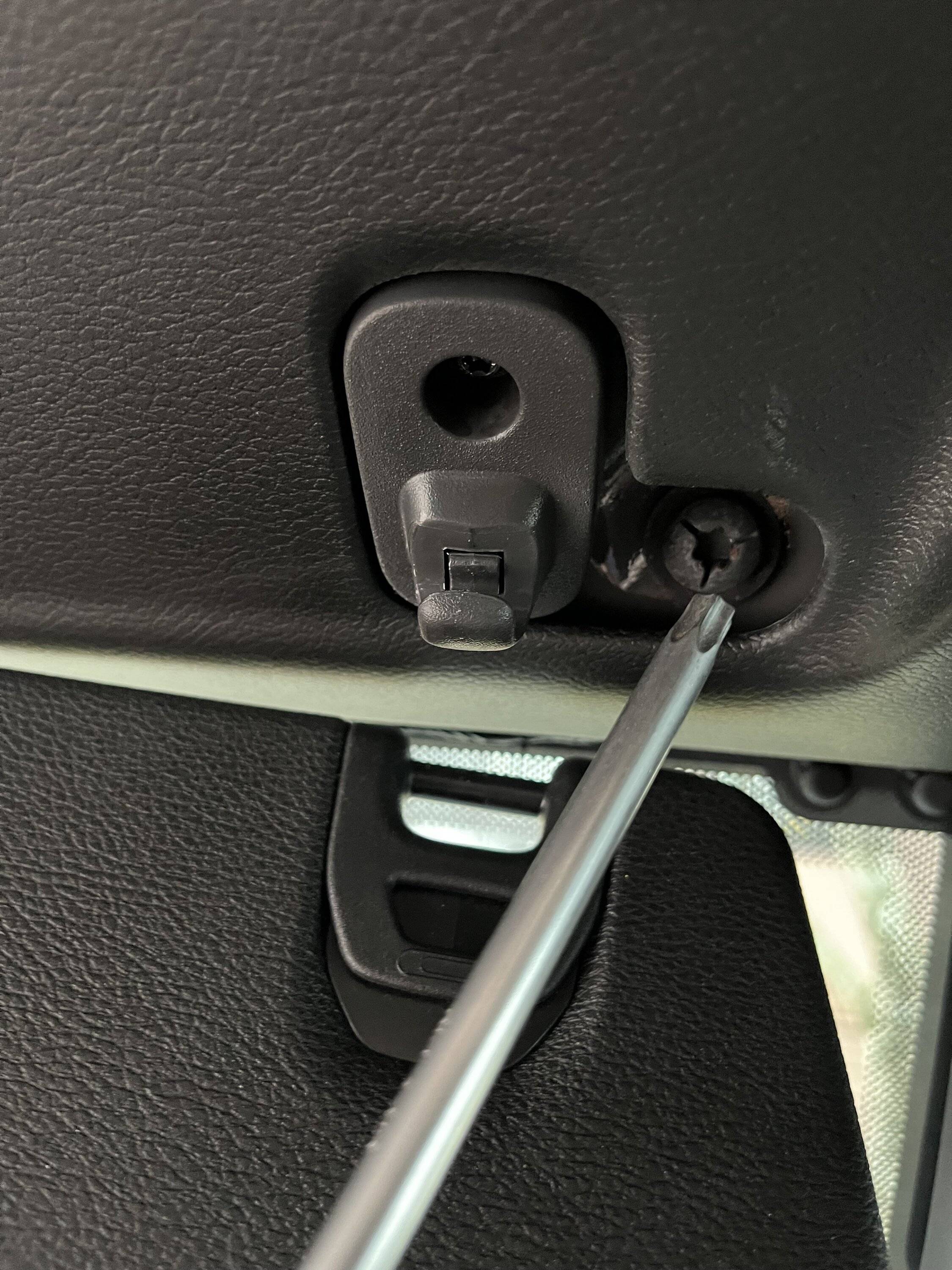

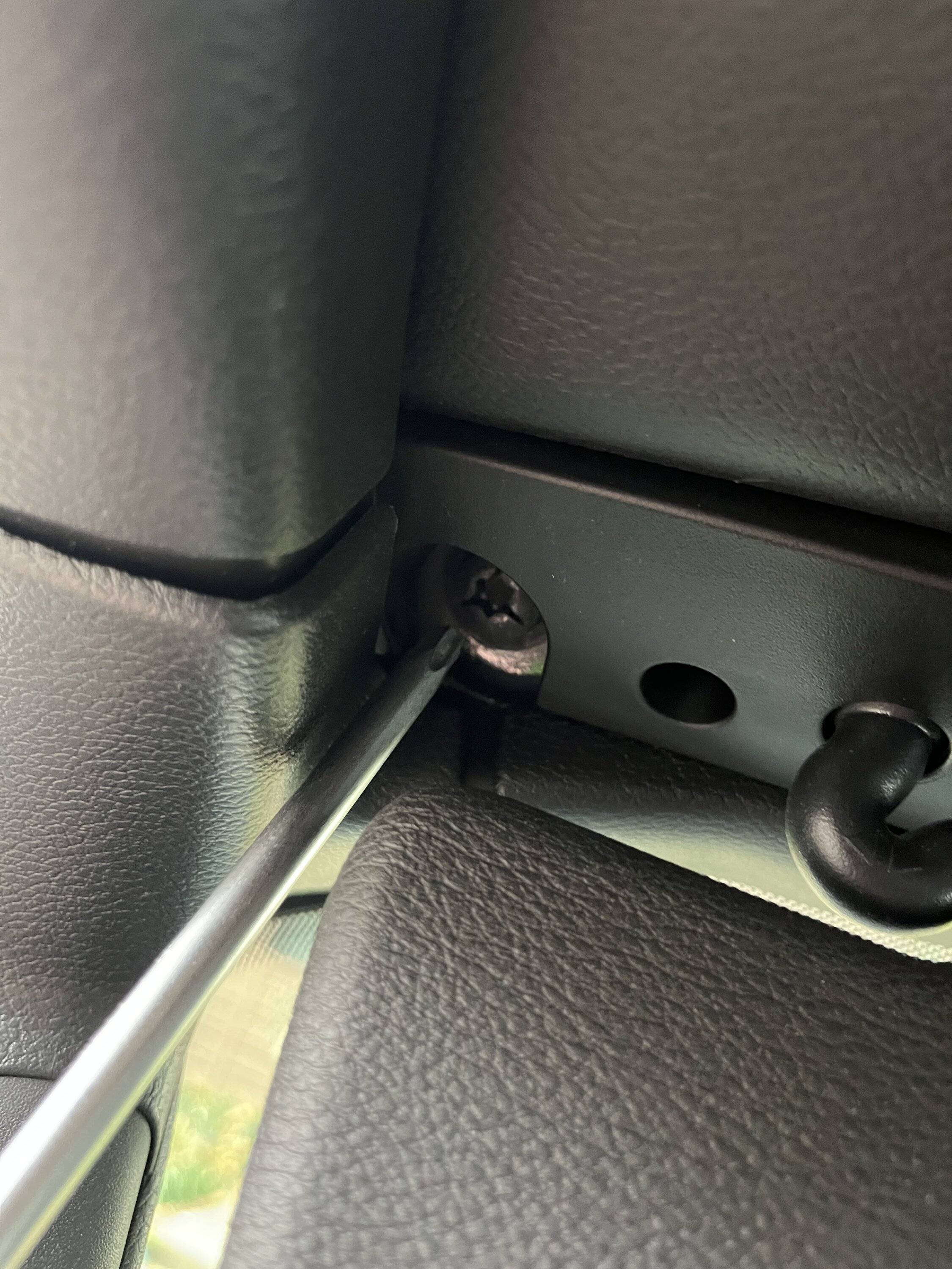

Thanks for the tip. I had 1 outer bolt loose. I hope this fixes the mystery squeak that I have occasionally. I thought it was a bad shock absorber. I’ve attached 2 photos…. Please verify these are the correct bolts.
@Roadrunner71
Those are the correct bolts.
There are 4 in windshield bolts in total .. you showed the 2 end bolts / L & R side in your pics. There are 2 other bolts in the middle.
