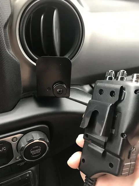

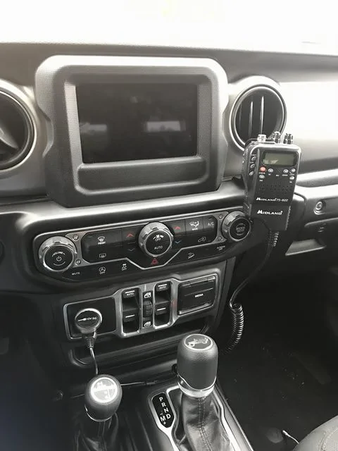

I just put in the Cooltech mount. Very easy instal, and thought out quite well.
The mount doesn't come with a hangar, so you have to supply your own. Being I have a Midland 75-822 (GREAT little radio BTW) it has a belt clip and no provision to mount a button on the back. So I put the button on the Cooltech bracket, and a cheapo truck stop stick on hangar on the bracket. Totally not a permanent solution, but it will work until I figure something else out. (Like drilling a hole in the radio to mount the button.

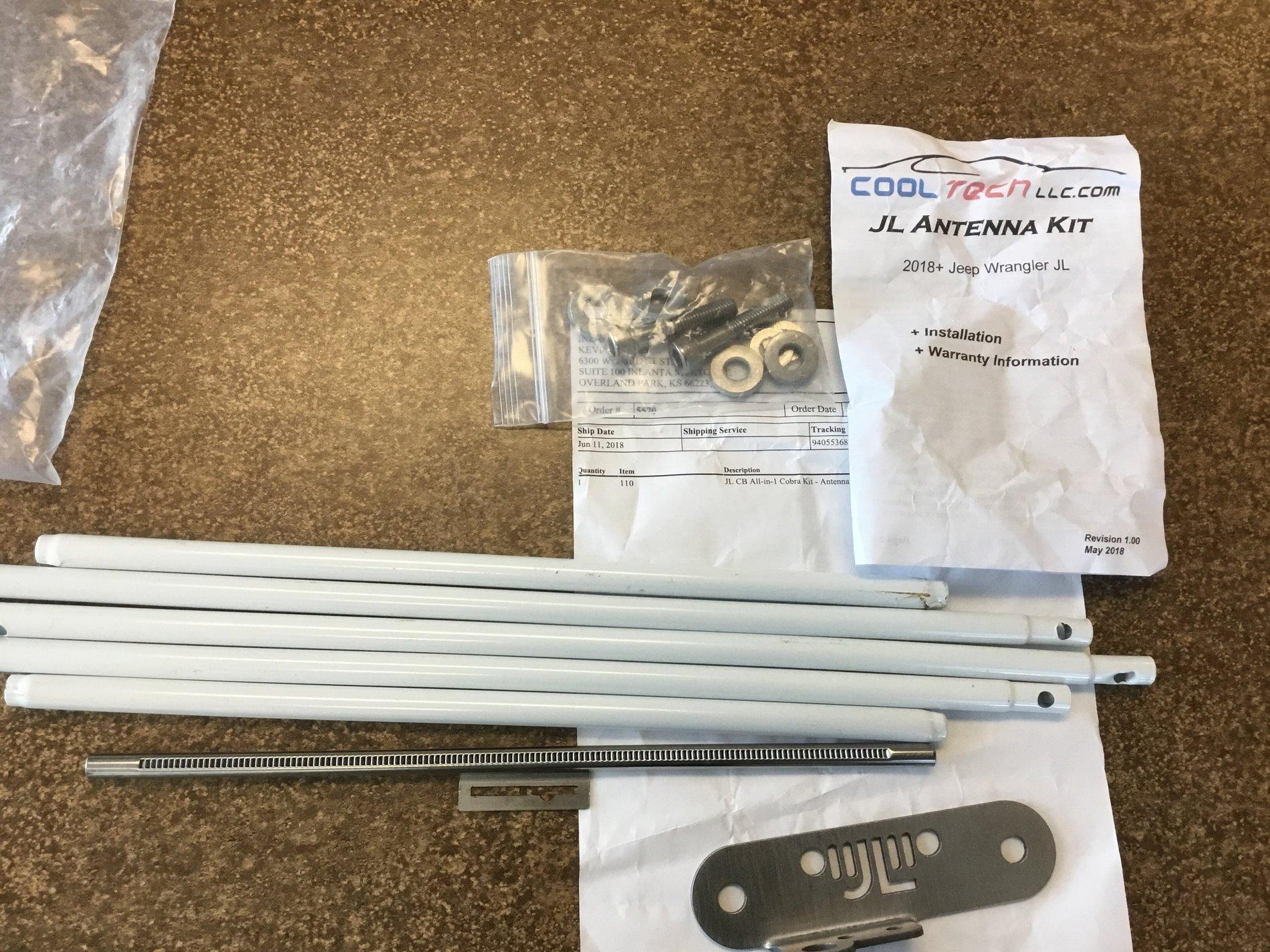

Does anyone have a contact number for Kendall at Cooltech? I ordered the JL CB Kit and I got a package that clearly wasn’t the kit. Looks more like a tent pole and some kind of baffle. I have been calling the phone number listed on their website and it is never answered and does not allow you to leave a message. I have also emailed Kendall with no response. Really starting to question Cooltec as a part/service provider.

Contents of what I was sent. Supposed to be a JL CB All in ! Cobra Kit - Antenna Color/Length 4’ Black.
