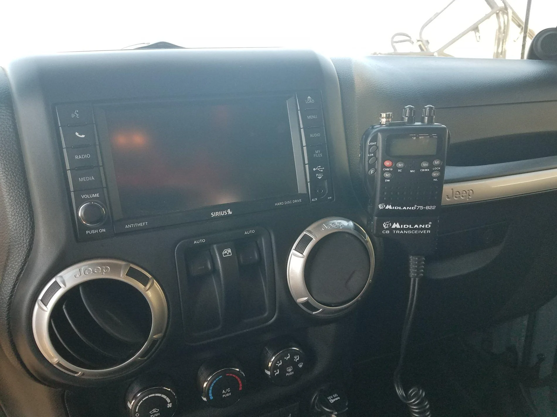

This is what I was running on my JK. I'm hoping to make the same mount work. I'll look at it tomorrow.
Let me know how it goes, I have the same CB, but I am sure the Cobra 75 would work just fine too with that mount.

Update: went out with 28 Jeeps from a local Jeep Club today, worked like a champ, chrystal clear and well over 5 mile ranges when we got staggered out on the way to the trail.

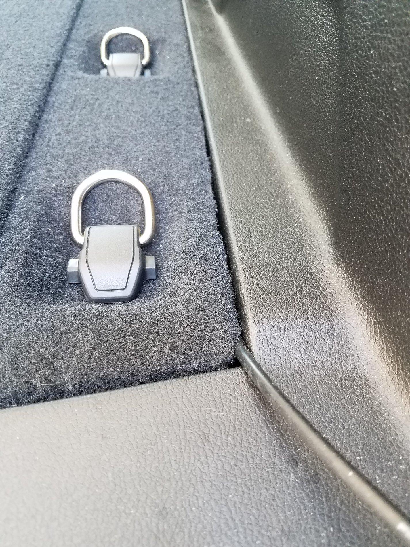

I assume you ran the coax cable under the plastic on the floor by the passenger side doors. How did you route it from the back seat to the tailgate? Did you go under the carpet or through the plastic on the passenger rear side? If you went through the plastic, how did you pop it off? Pictures appreciated.

Jeep Wrangler JL CB Antenna Mount, What I Did 20180413_153715
This is where I ran it from the back. Then under the carpet at the rear seats center seat belt mounts.
Thanks. Tomorrow, I am going to take some time and see how the large black plastic piece on the right snaps or bolts on. That is how I did my JK and it looks like a clean install. I didn't see any bolts so I am going to get my plastic trim tools out and see how it comes apart.
All I did was press it down in the gap with a flat head screw driver.
