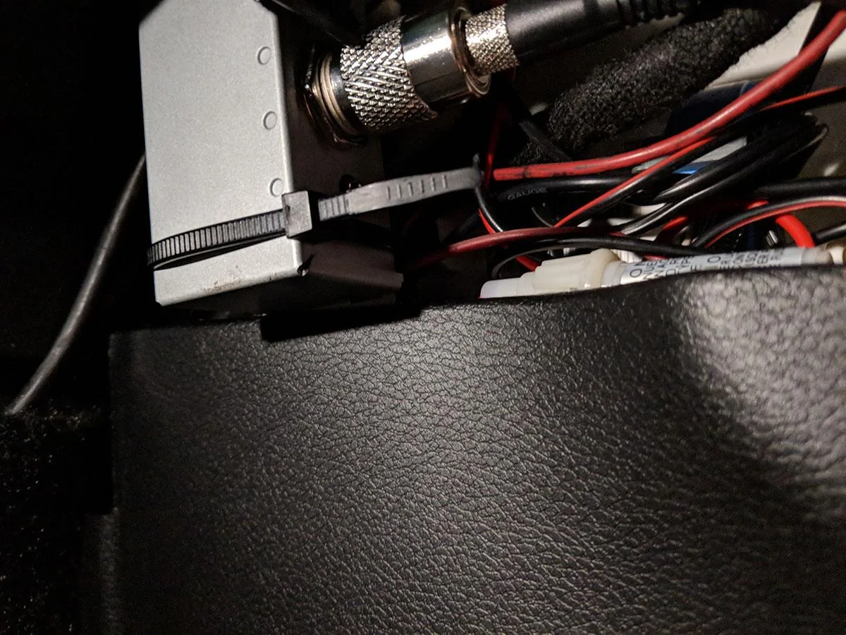

Are you guys mounting the Cobra box behind the console? I tried to feel behind there and there didn't appear to be any room.

This looks a little messier than it actually is, but this is the very end of the plastic trim on the passenger side as it goes under the footwell. I just stuffed the box back behind it and zip tied it to a thick wiring harness back there. Not exactly my ideal location, but it works and I'm not getting any interference on the CB from it. But yeah, there's nothing you can zip tie to or hang the box off of behind the glovebox like you could in the JK.

I felt under the dash and found a flat spot on a piece of plastic which I have no idea what it is; blindly I put a piece of Velcro tape on it and a piece on the cb box and it works perfect!
