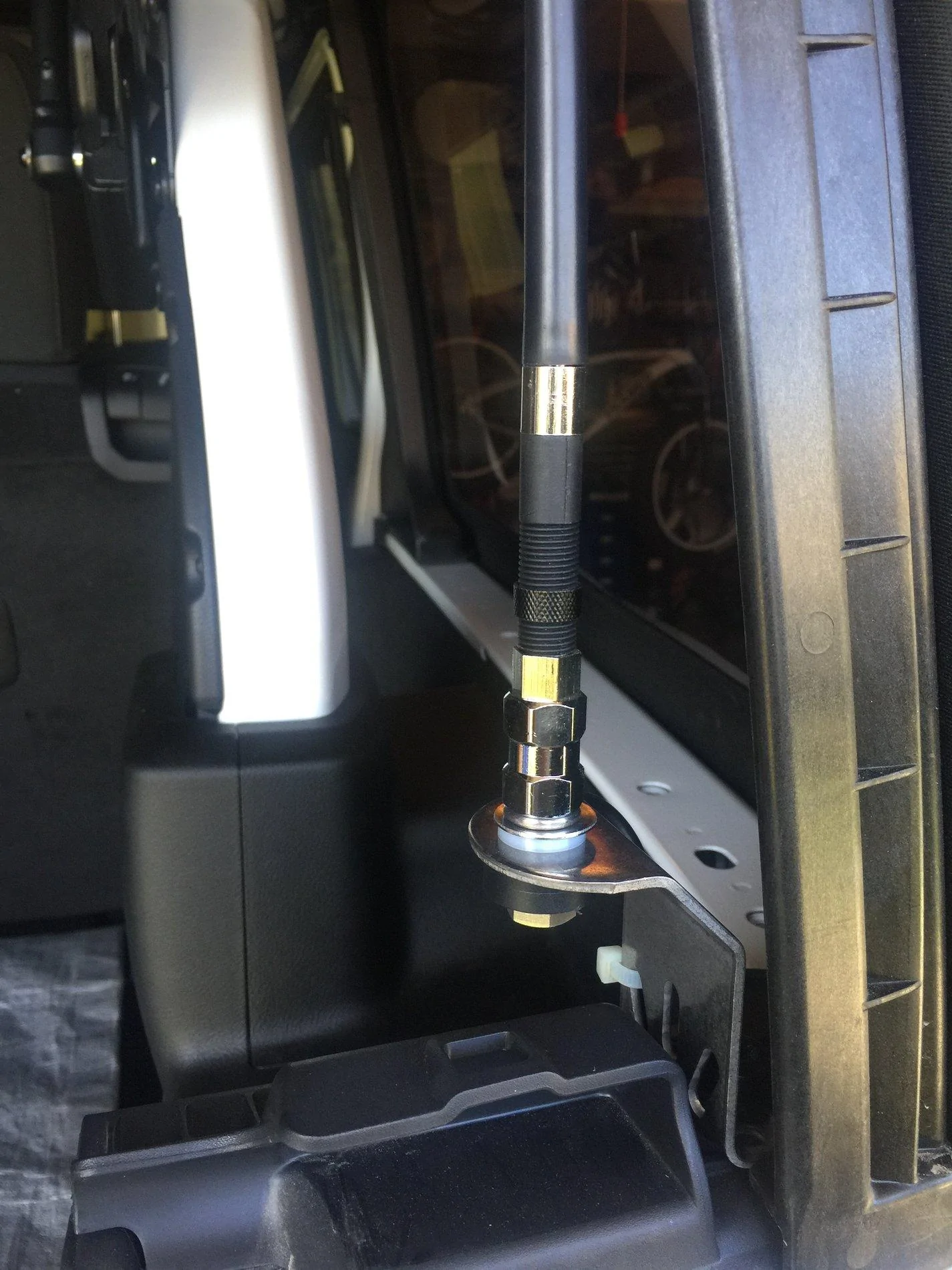

All installed, works great!!!
The mic mount was really easy to install. The instructions state that you have to pry open the Hvac Plastic and you would think so but all I did was push down on the top of the plastic right next to the grab bar and it popped open. Push down and out on it.
The blemish you see on the antenna mount is actually a reflection from the antenna base.

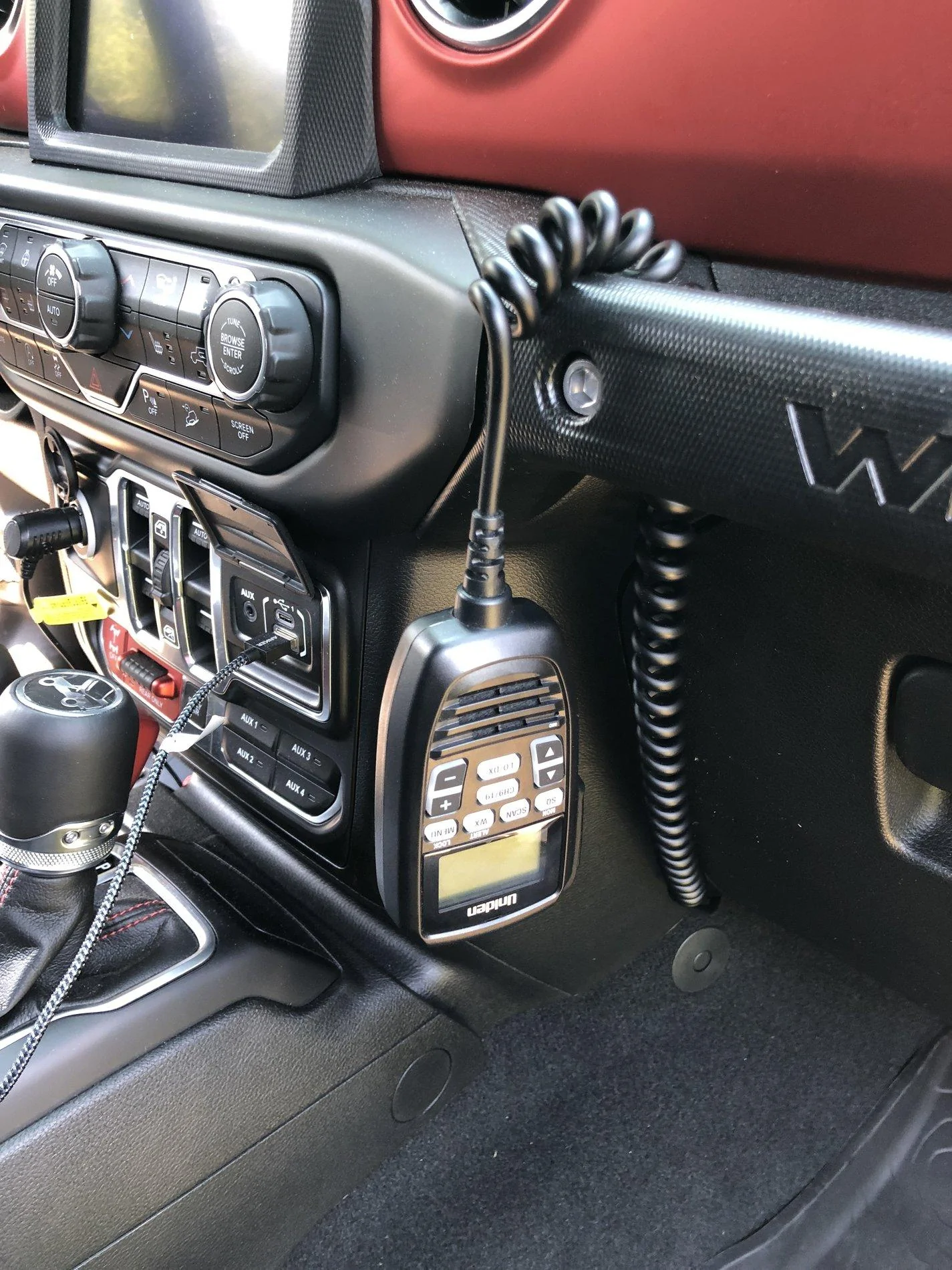

Nice. I've got my bracket and antenna installed and my coax neatly tucked over the amp housing and the plastic trim along the floor. I just need to wire up the Cobra 75, but I'm still on the fence about location. I just don't want my CB up near the front of the dash. I simply don't use it enough to warrant having it there. I'm still thinking of putting it down low as shown in my "test" photo.
Thanks!
Yeah that spot in your test shot is a good one!

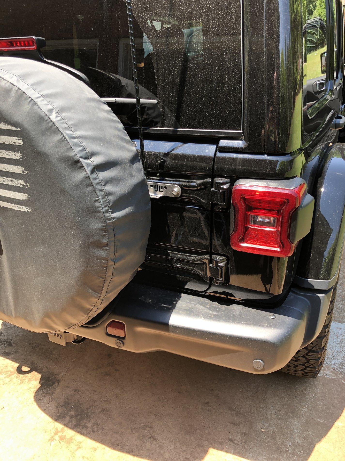

Until we have more aftermarket antenna mount choices for the JL, here is my solution.
A 15” trucker rubber duck antenna hidden behind the canvas.
Good enough to communicate in close proximity, which is mostly what I need it for.
Just as an update, I tested this setup last week in Moab.
Works very well for car-to-car communication within a range of up to 1/2 mile. Better for cars behind you than cars in front of you.
I believe the antenna position in the back, anchored near the spare - while popular - is fundamentally flawed, because the bottom 2' of the antenna is blocked by the chassis. I am waiting for options to anchor the antenna in the front of the car.

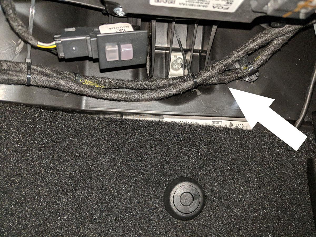

Now, I still can't find the :swear: powered wires/aux button wire bundle under the passenger footwell. I don't know why these had to be hidden or camoflaged the way they are.
It's run from the right side of the footwell to the left, then folded and back towards the right. It's weird, but look for that and you'll find it.
I'm wiring up my CB right now, too. :rock:
Under the carpet?
