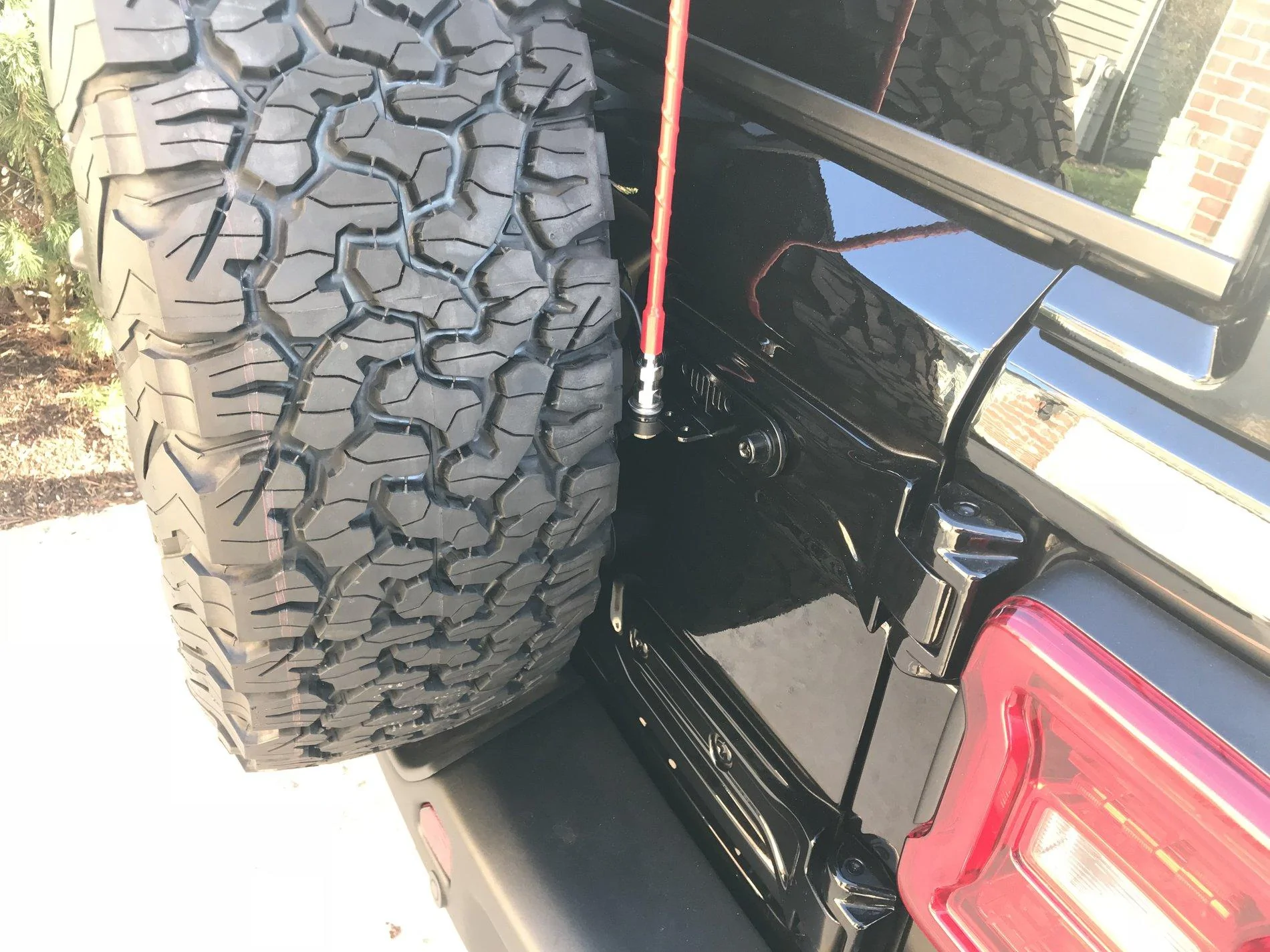

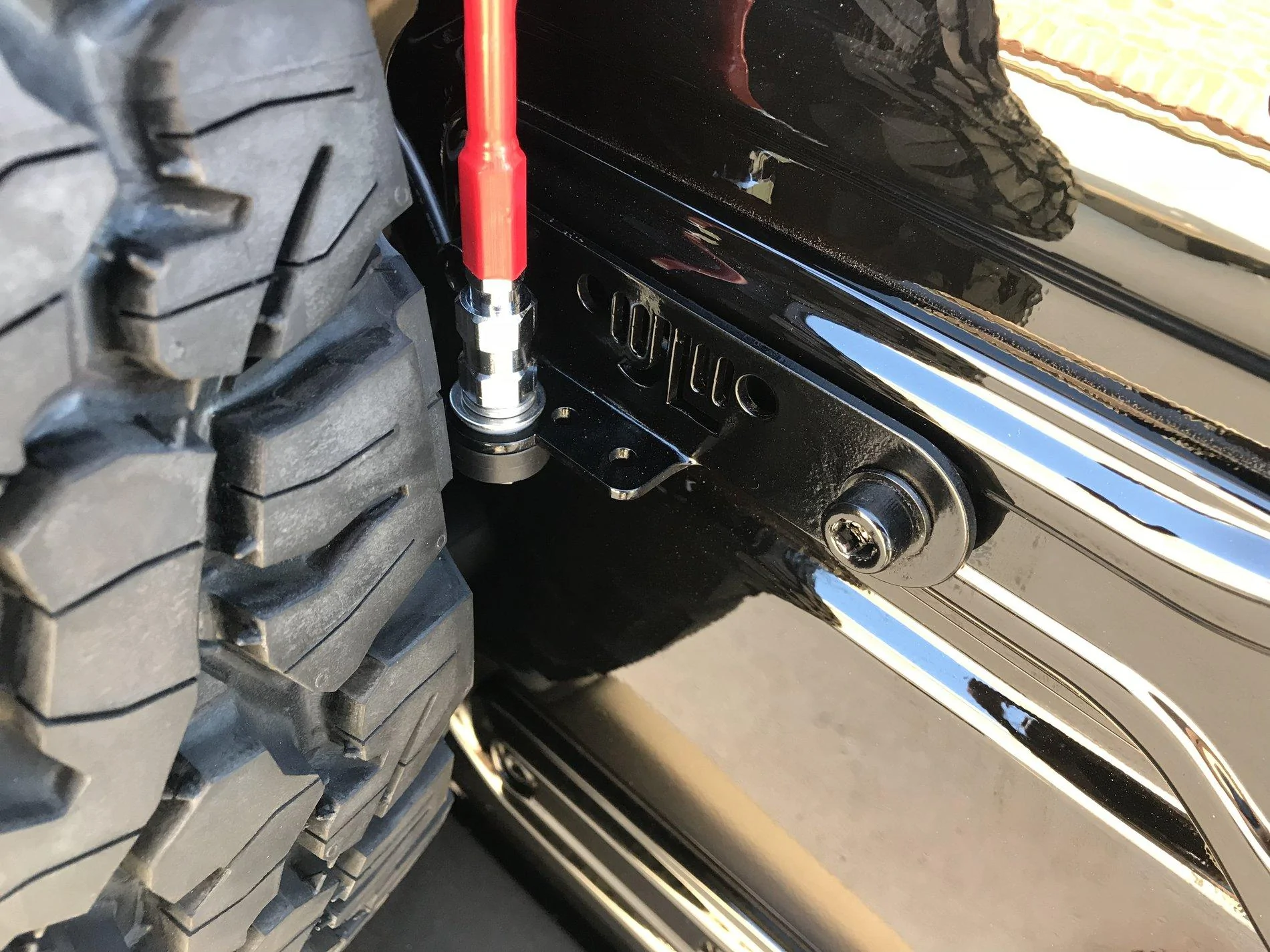

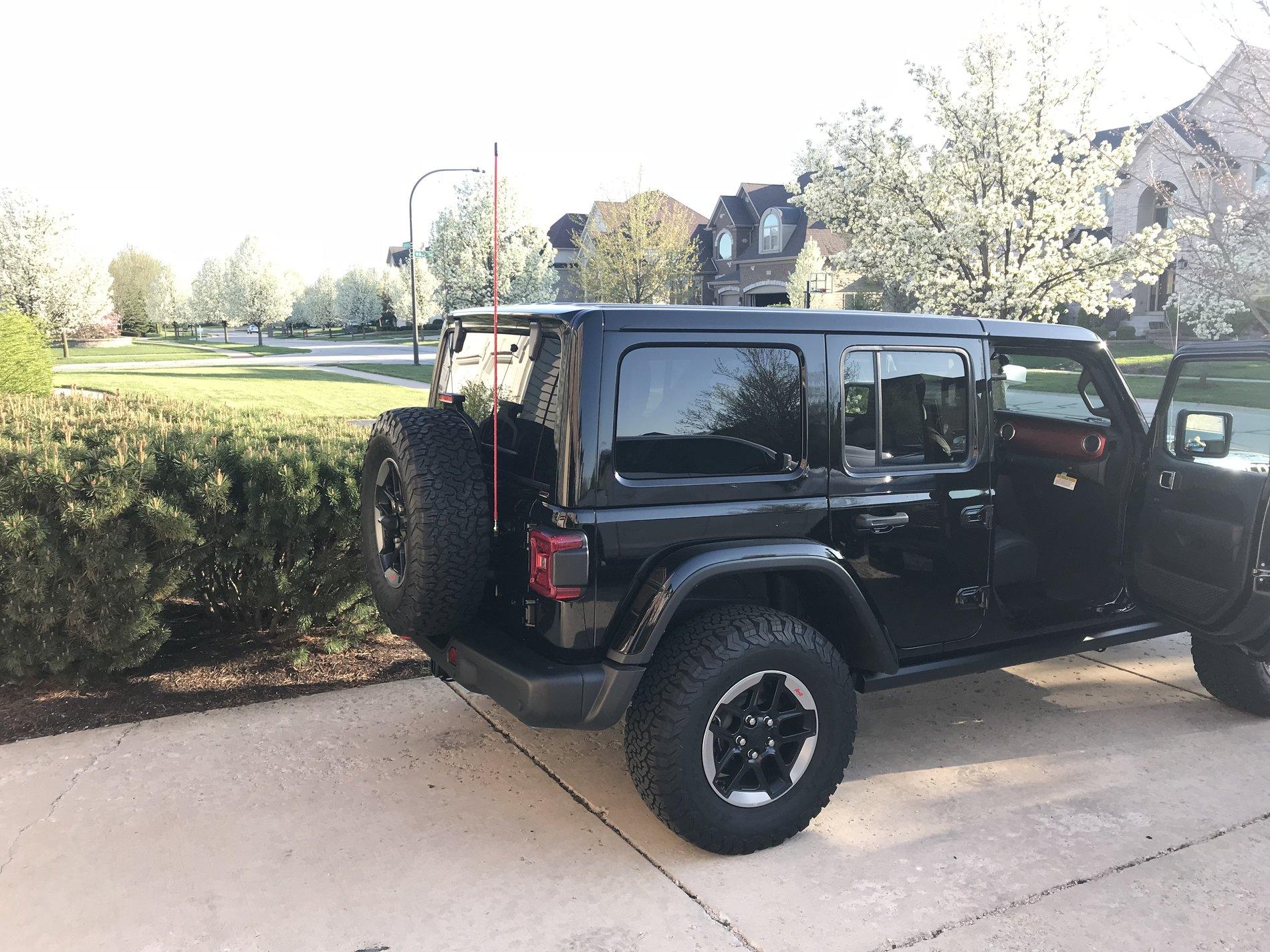

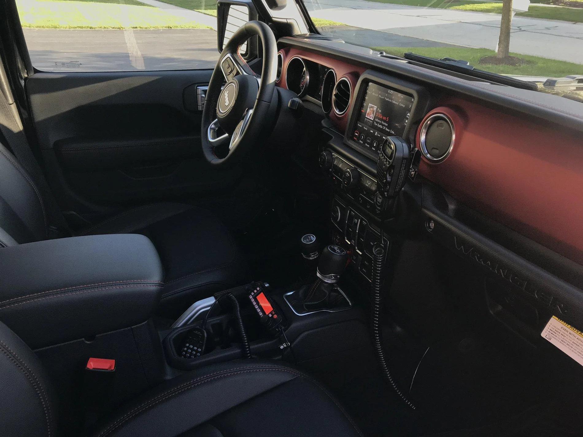

All installed, works great!!!
The mic mount was really easy to install. The instructions state that you have to pry open the Hvac Plastic and you would think so but all I did was push down on the top of the plastic right next to the grab bar and it popped open. Push down and out on it.
The blemish you see on the antenna mount is actually a reflection from the antenna base.

Did you get the 4 foot ant. I don't know which to get and if it really makes any difference.
I have the 4 foot and I’m thinking it will be better than the 3 foot especially for front reception and transmitting.

Yeah, I'll go with 4', for sure. Have you tried it out? How's the range?
I got the SWR down to 1.5
Didn’t really get a chance to test it out much as it’s Sunday and not many truckers in my area until tomorrow. I did talk to one trucker that was only 1 1/2 Miles away but he said the radio sounded Great! He sounded good as well.

Looks great! Where did you mount the box for the Cobra? I haven't had time to look to see how much room there is yet.
Thanks Rubidouxit, I actually have no idea what I mounted it to. I can’t fit under the dam dash to see what’s up there. I felt a smooth piece of metal and took some Velcro tape and mounted it to that.
I actually did the same thing with the vhf/uhf Radio I have; I mounted that under the seat with the Velcro tape. The sticky side of the Velcro actually sticks to the carpet very well. I though I could just use the hook side of the Velcro on the radio and have it stick to the carpet but the hooks don’t grab the carpet well and I needed to put the other part of the Velcro tape on the carpet; if that makes sense.
