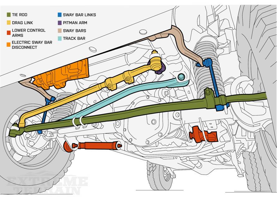

Could I trouble you for a pic showing track bar and drag link, I would like to see how they look in relation with each other, if this made them more parallel, or less. If they’re not parallel, I don’t understand how it got rid of your bumpsteer unless your track bar isn’t adjusted long enough .

I’ve got a bunch of stuff ordered (AEV 2.5” lift, track bars, wheels/tires) but nothing installed yet. I’ve been worried I will introduce bump steer and actually ordered that teraflex relocation bracket in addition to their adjustable track bar. I called teraflex yesterday and they said I didn’t need both the adj trackbar and the bracket... yet here you are. The stuff I keep reading says to prevent bump steer the trackbar and drag link need to be parallel. Are yours?
Jeep Wrangler JL BUMP Steer 265B6C63-05D3-47C6-A31D-F5904CE4FA4E
Based on what it looks like with such dissimilar mounting locations/pivot points I don’t understand how we don’t all have bump steer on a stock Jeep.
Thanks
Roky
Equally as confused. If i drop my drag link back down it would look like a Y between track and drag.
Thanks
Roky
will try to see if I can get a picture later.
I can tell you measurements though.
Ground to center of the track bar mount (axle end) WAS 17"
Ground to center of the track bar with bracket (axle end) is 18"
Ground to Passenger Drag link is 18" (measuring the centerpoint of the drag link end)

That is very interesting what brAcket do you have? Mine was rasied almost 3” with my flip.
*edit* answered my own question (teraflex) lol
