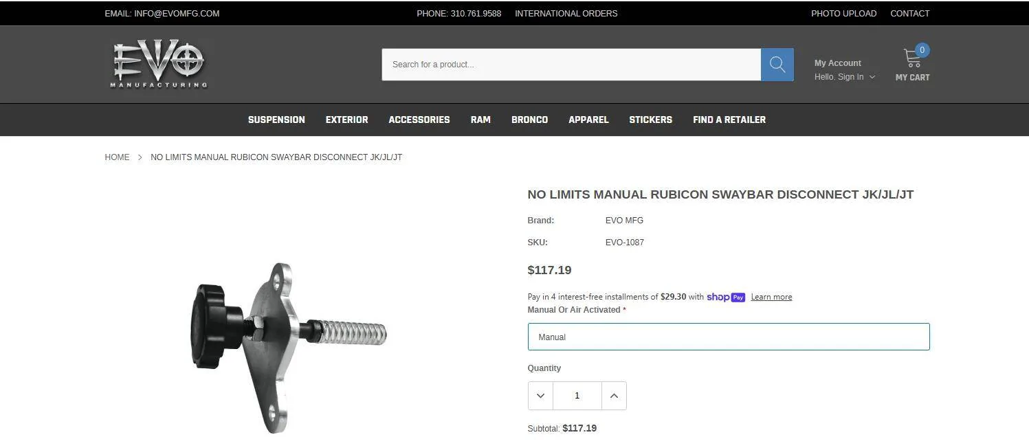

For the sway bar disconnect, too bad you don't live near me as I have 2 from my current and previous rubicons sitting in my garage. If you can source one locally for cheap or free, just purchase this:
https://evomfg.com/products/nolimit...d9yDeFfsOQAI_rnp6y5_NQvd0b8zEWoo4sJuoQQcqxdkU

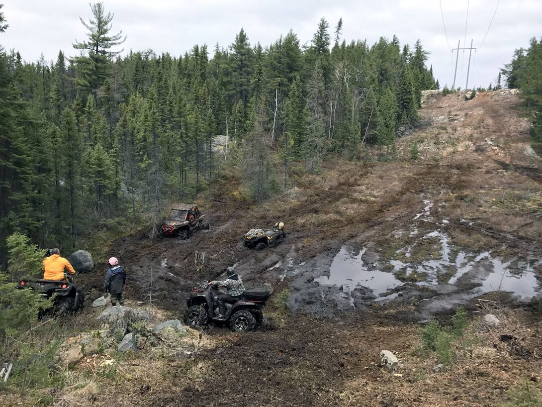

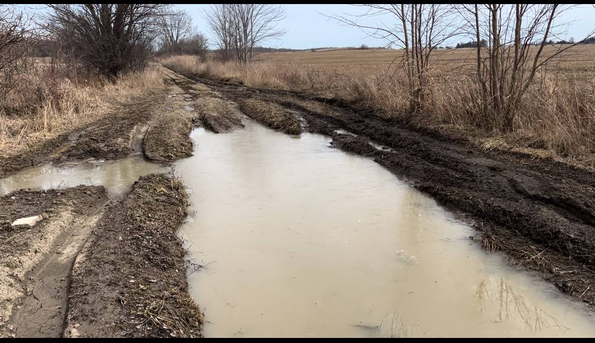

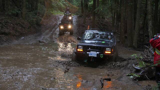

its going to still be my daily driver so I don't want to jack it up like crazy, im mostly going to be using it in mud/sand and super rutted/washed out roads. there will be rocks as I live on the Canadian shield, but no crazy rock crawling
i like the idea of the rubi take off swaybar, but taking off the swaybar disconnects is more what I'm looking for
heres some pictures of trails where I am (I didn't take them)

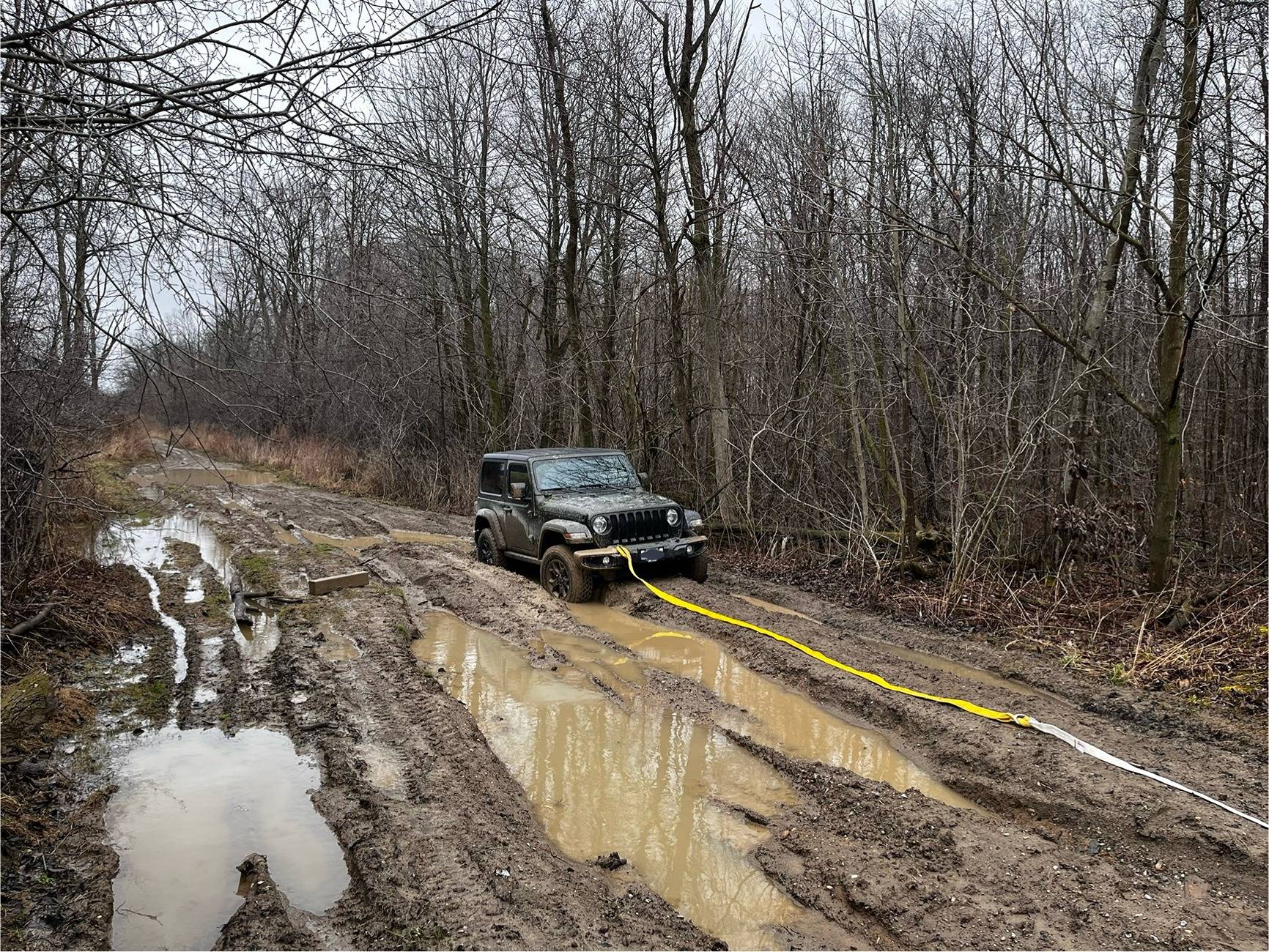

here are a few pictures from what ive done stock, almost everything is doable stock, but better with some mods

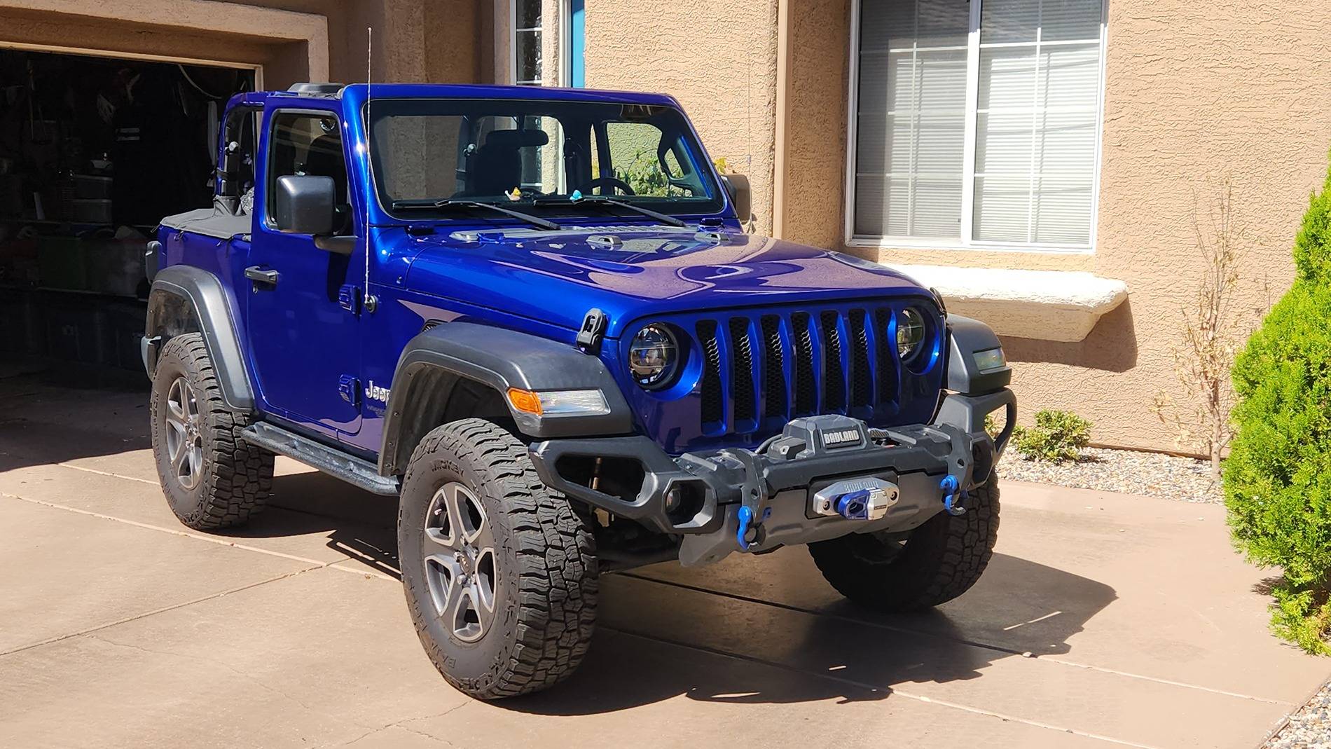

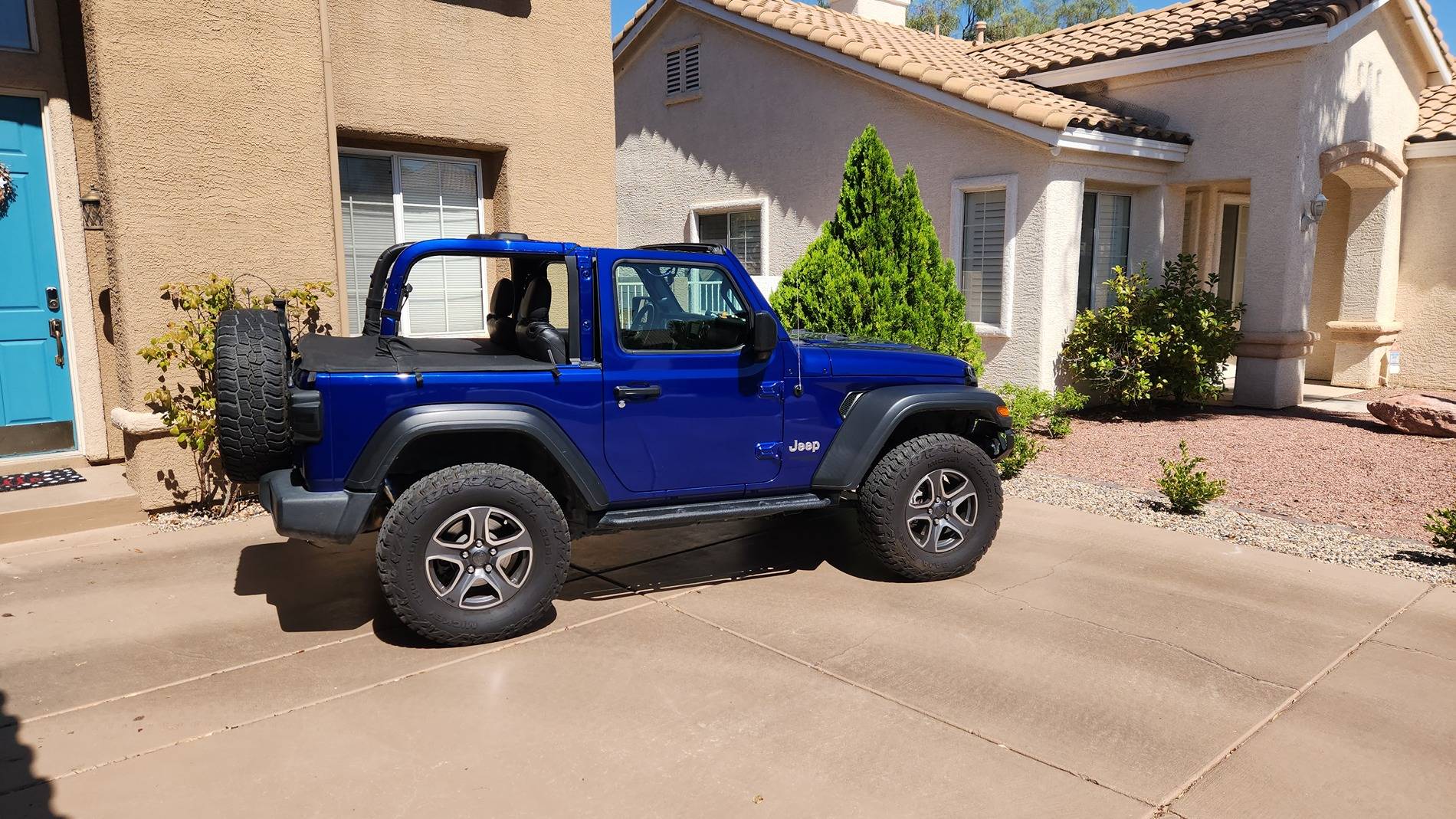

I wanted my sport s to be capable without breaking the bank.
2020 2 door 2.0t
Rubicon recon suspension = 2.5" lift
Bilstien 1500 shocks
Rugged Ridge Venator bumper
HF 12k lb Badland winch
Apex auto LYNX sway bar disconnects
Baja Boss 285/70 a/t tires
Firewall mounted ARB single
Barricade Enhanced Rubi Rails
Mifland mtx275 gmrs radio
I've run up to 6 rated trails without issue - without lockers mind you. The BLD works amazingly well with the automatic and a little extra care over lines and tire placement.
It's also my daily driver and work truck. It's nicely balanced for both on and off road needs...

stock tire size? that looks good!
there is tonnes of mud and loose climbs here so lockers are fairly high on my list

Yeah, for the mud you're going to want lockers. The Baja Boss also comes in a much more agressive M/T that is also very well liked.
The auto LYNX disconnects are pricy, but for the mud you'd love them! A quick turn of a knob and you're locked/unlocked and the reviews have said they hold up fantatic in the mud.

The auto Lynx does work great, had it on my JTM, and very easy to use. If you do not go this route, be prepared to be muscling around the rig at times trying to reconnect the end links.
The factory sway bar off a rubicon can or should be found cheap, with that additional piece from EVO which makes it a breeze as well to disconnect. Hated the electronic disconnect due to auto reconnecting at speed and also "the flop", so the antirock suits my needs.
