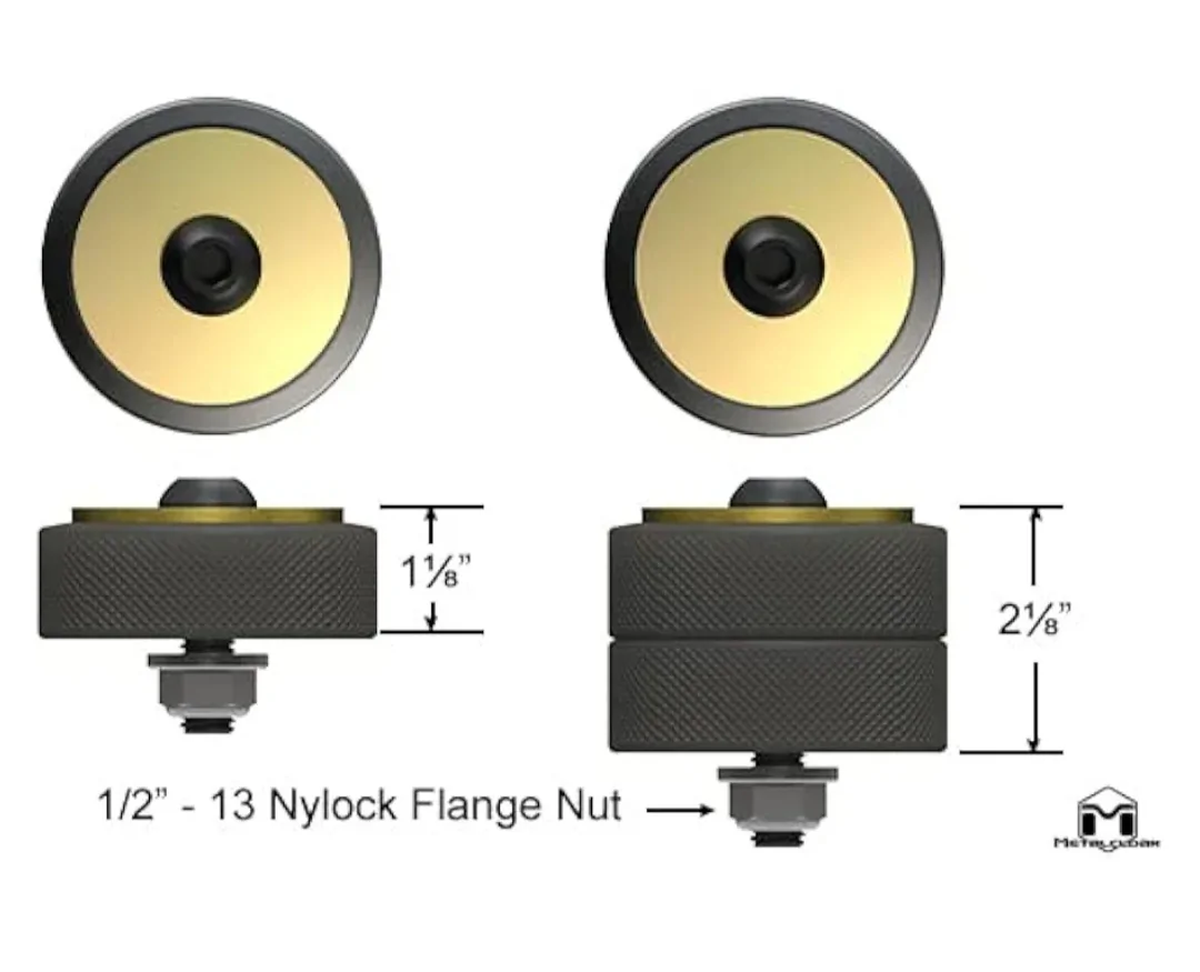

Hmmm. I just stumbled upon Metalcloak bump stop replacements. They are allegedly 1" longer than stock and smooth out bumps too. Set of all 4 is around $100 bucks. I might be willing to do that for a simple solution, if they really are longer than the stock bump stops.

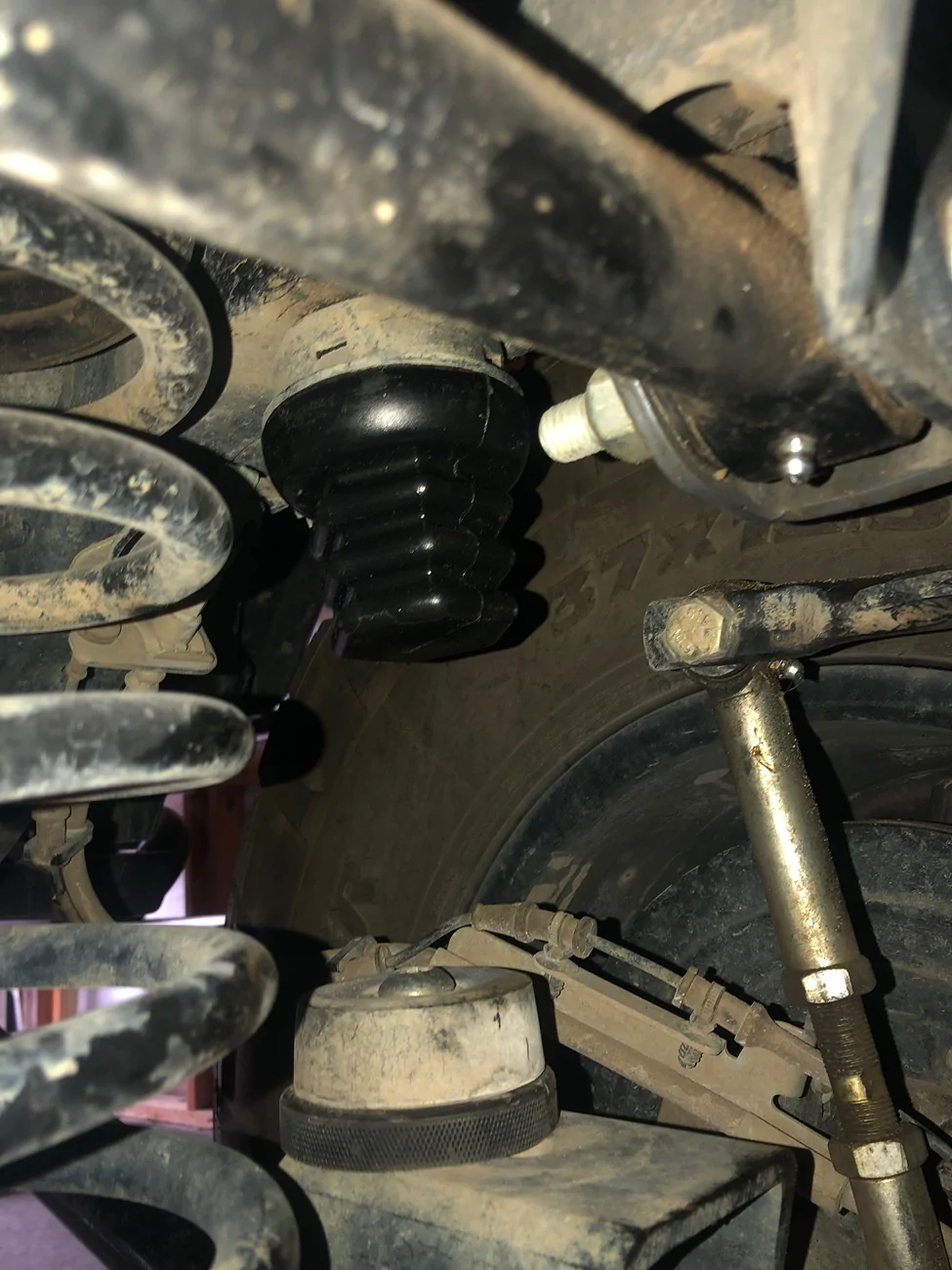

Yeah they don’t compress the last inch….. they really do work good…here’s what they look like on…..
Jeep Wrangler JL Budget Bump Stop Extension Options? IMG_9176
Jeep Wrangler JL Budget Bump Stop Extension Options? IMG_9179
