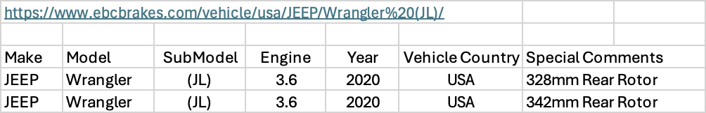

So, I am about to order new EBC front and rear brake pads for my 2020 JLU Sport, but apparently I need to know what size my rear rotors are. Any thoughts on how I can determine that? Also, would love your thoughts on EBC pads and others. Many thanks.
See this post: https://www.jlwranglerforums.com/forum/threads/392-rear-brake-swap.104339/#post-2215731
Front rotor diameterFront rotor widthFront rotor typeFront caliper piston sizeFront caliper piston countFront caliper typeRear rotor diameterRear rotor widthRear rotor typeRear caliper piston sizeRear caliper piston countRear caliper type
Sport33024Vented482Floating32812Solid452Floating
Sahara33028Vented512Floating34214Solid482Floating
Rubicon33028Vented512Floating34214Solid482Floating
Sahara 4xe33028Vented512Floating34522Vented512Floating
Rubicon Xtreme Recon33028Vented512Floating34522Vented512Floating
Rubicon 4xe33028Vented512Floating35022Vented512Floating
Rubicon 39233028Vented512Floating35022Vented512Floating
