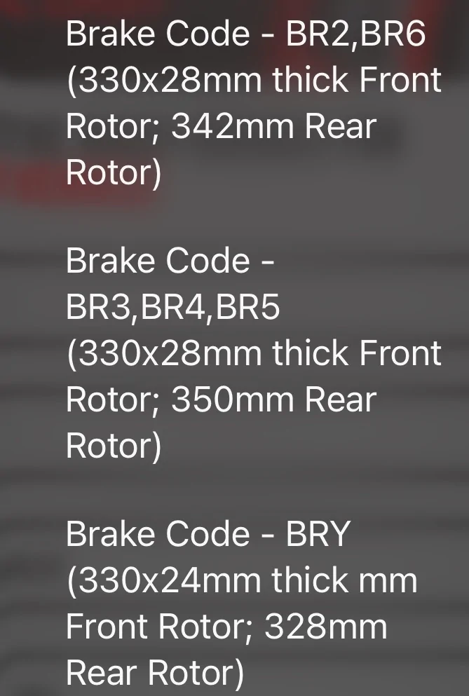

Be carefull when purchasing rotors, calibers. Jeep produced a couple of rotor thickness, and diameters for the Wrangler Sport S specifically. The thicker rotor will not fit onto a Jeep with the thinner style. Thinner means about 1/8" thinner. They look the same, but the calibers will not fit over the thicker rotor if your jeep is the thinner style.
Also, they produced a couple of different calibers. They made a high performance style will dual 54 mm, and a dual unit with smaller pistons. They are not interchangeable.

Be sure to order from a Mopar site with your VIN and elsewhere here is a guide on what the brake codes mean.
BRY - base Sport and Sport S
BR2 - Right hand drive(RHD)
BR3 - 4XE models
BR4 - Xtreme Recon pkg, 392
BR5 - Sahara High Altitude
BR6 - Willys, Sahara, Rubicon, and all w/Eco Diesel
