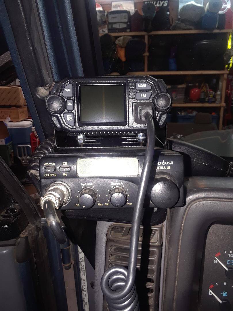

In my TJ I started out with a CB. Then folks were wanting to require GMRS (and one group once was wanting to use Ham). So I got both my Ham (KI7TSP) and GMRS license. Since the CB was already mounted in the Jeep, I put a 25W BTECH UV-25X2 Ham radio on top of the CB using a CB mount I had sitting around. This UV-25X2 also covers the GMRS frequencies. It is a small compact unit that could be plugged into a cigarette socket (although mine is hard wired).
BaoFeng or BTECH haters need not respond.
Amazon.com: BTECH UV-25X2 (Second Gen.) Mini Mobile 25 Watt Dual Band Base, Mobile Radio: VHF, UHF Amateur (Ham) : Electronics
Jeep Wrangler JL Boafeng advice HAM radio.1
Jeep Wrangler JL Boafeng advice Ham radio.2

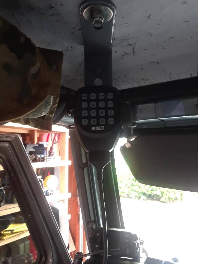

I made a simple mount for the mike, and bolted it to the roof using an existing bolt for the roof rack (I didn't like it mounted on the dash as shown in the picture above). This set-up worked nicely. If using GMRS, you need to know the frequency for the specific GMRS channel. I usually had two or three GMRS frequencies programmed in case we needed to switch from one to another.
Jeep Wrangler JL Boafeng advice ham radio.5

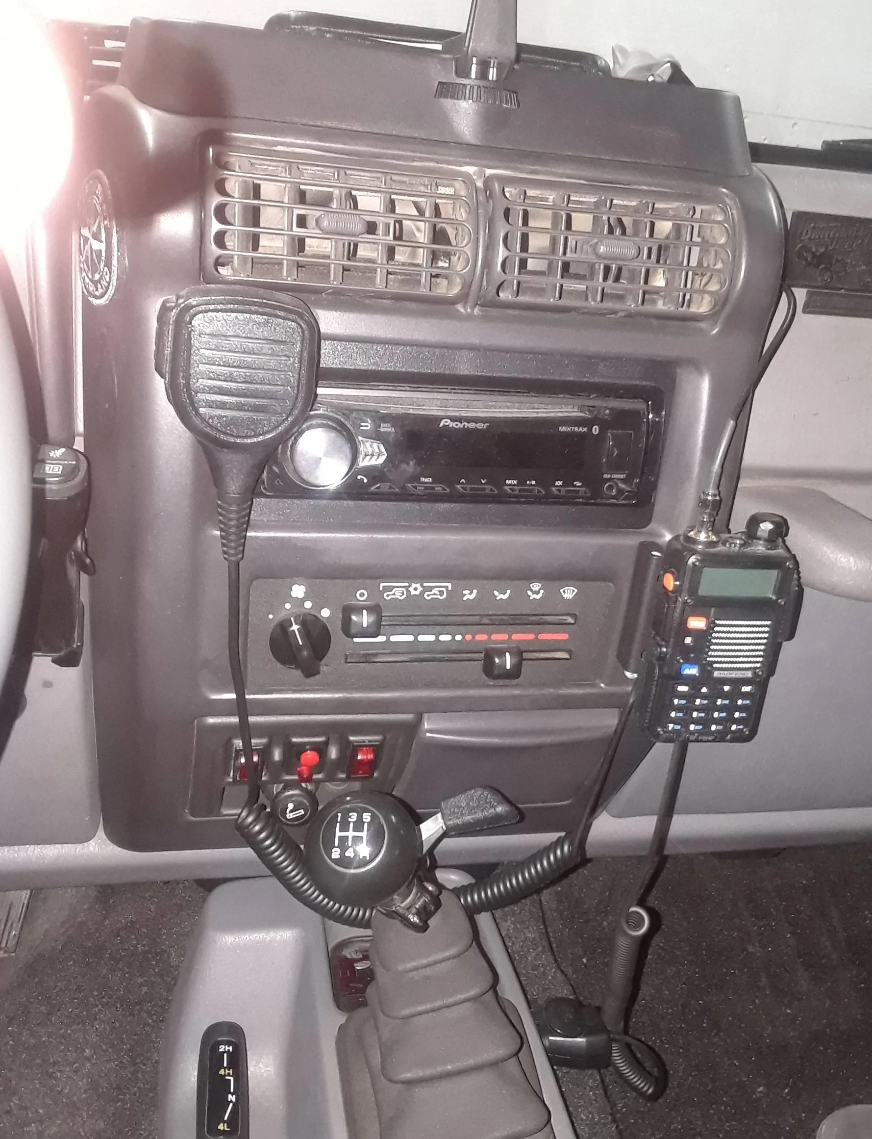

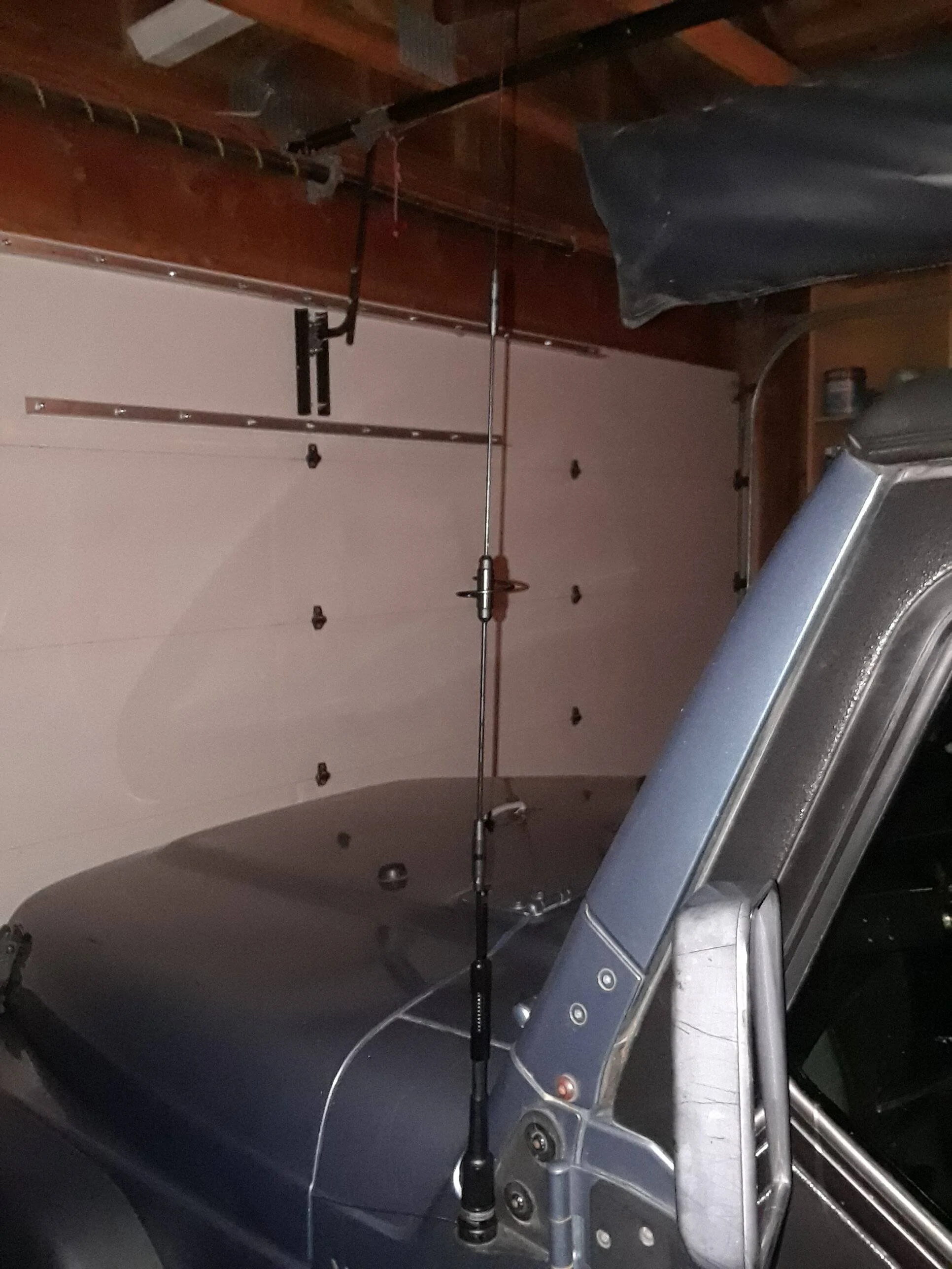

At one time (before I got the UV-25X2) I had my BaoFeng UV-5R (and later a BF-F8HP) clipped on a mount on the dash, had a battery delete in the radio (12V port this thing is plugged into below is always on), and connected to an antenna mounted outside the Jeep. The sound came out of the hand-held mike. This set-up actually worked pretty well, and was convenient to use. It got me into the Ham/GMRS game.
Jeep Wrangler JL Boafeng advice BaoFeng on TJ dash
Jeep Wrangler JL Boafeng advice HAM antenna
