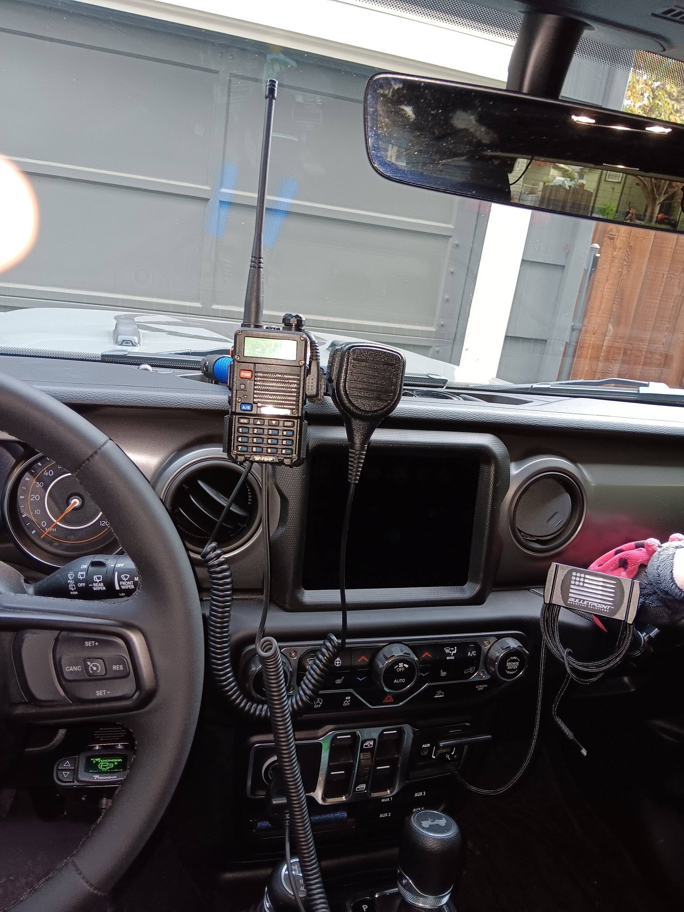

So my Bullet Point mounts came in. Simple installation. One ball and arm for the radio, and one for the mike. I got the 7cm arms; I'm thinking of swapping out the 7cm arm holding the radio for a 4cm arm. But otherwise I am pleased.

In these previous couple pics you can see my phone mount too.

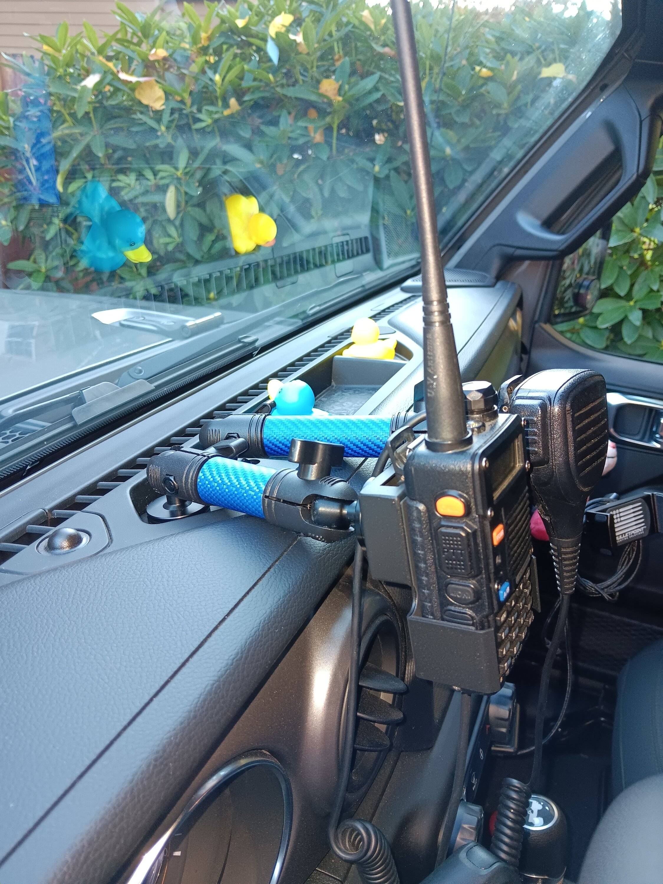

If you get this Bulletpoint two-ball mount for the top of the dash...
Jeep Wrangler JL Boafeng advice 20231031_154149
Jeep Wrangler JL Boafeng advice 20231031_154117
you have to trim the rubber mat that lines the tray. You'll lose about 1.5" of tray space, but there's still plenty of room for your sunglasses and a duck.

If you remove the rubber tray flooring (it just lifts out in one piece) there's a screw down there on either end (it is in at an angle, you can see the angled down triangle tab in the picture below on the mount where the screw will go through). You take the screw out, place the two-ball piece in there, and replace the screw. The two-ball mount also has an adhesive backing.
They also sell a single ball mount that goes in the same place if you just wanted one arm to hold a little handheld radio like a UV-5R and not have another arm for holding a mike.
But one of these type mounts gets your radio's antenna up high above your hood. I figure your reception is better there than having the radio in your center console cup holder or sitting in your lap.

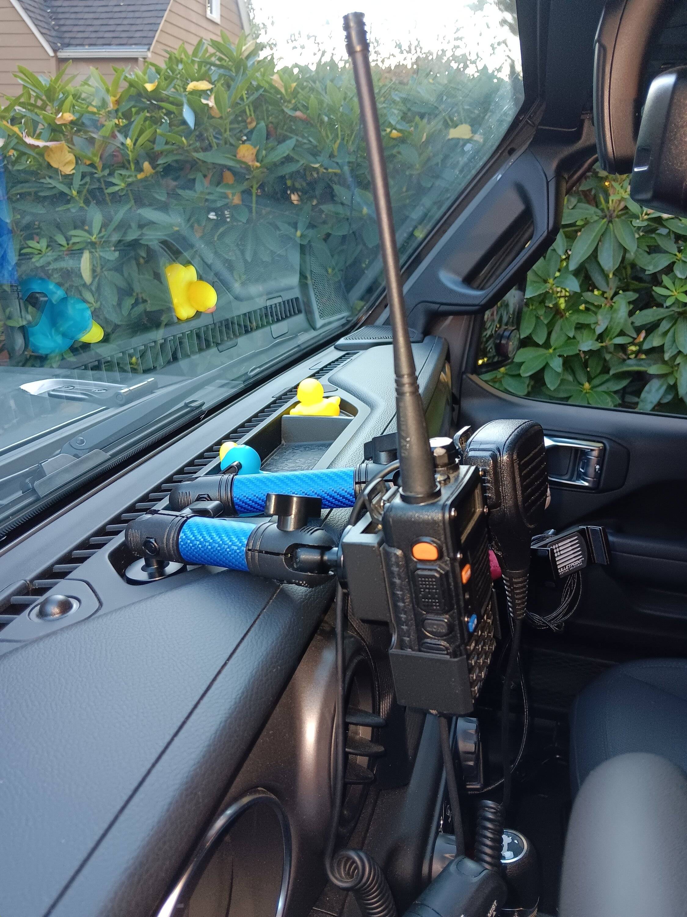

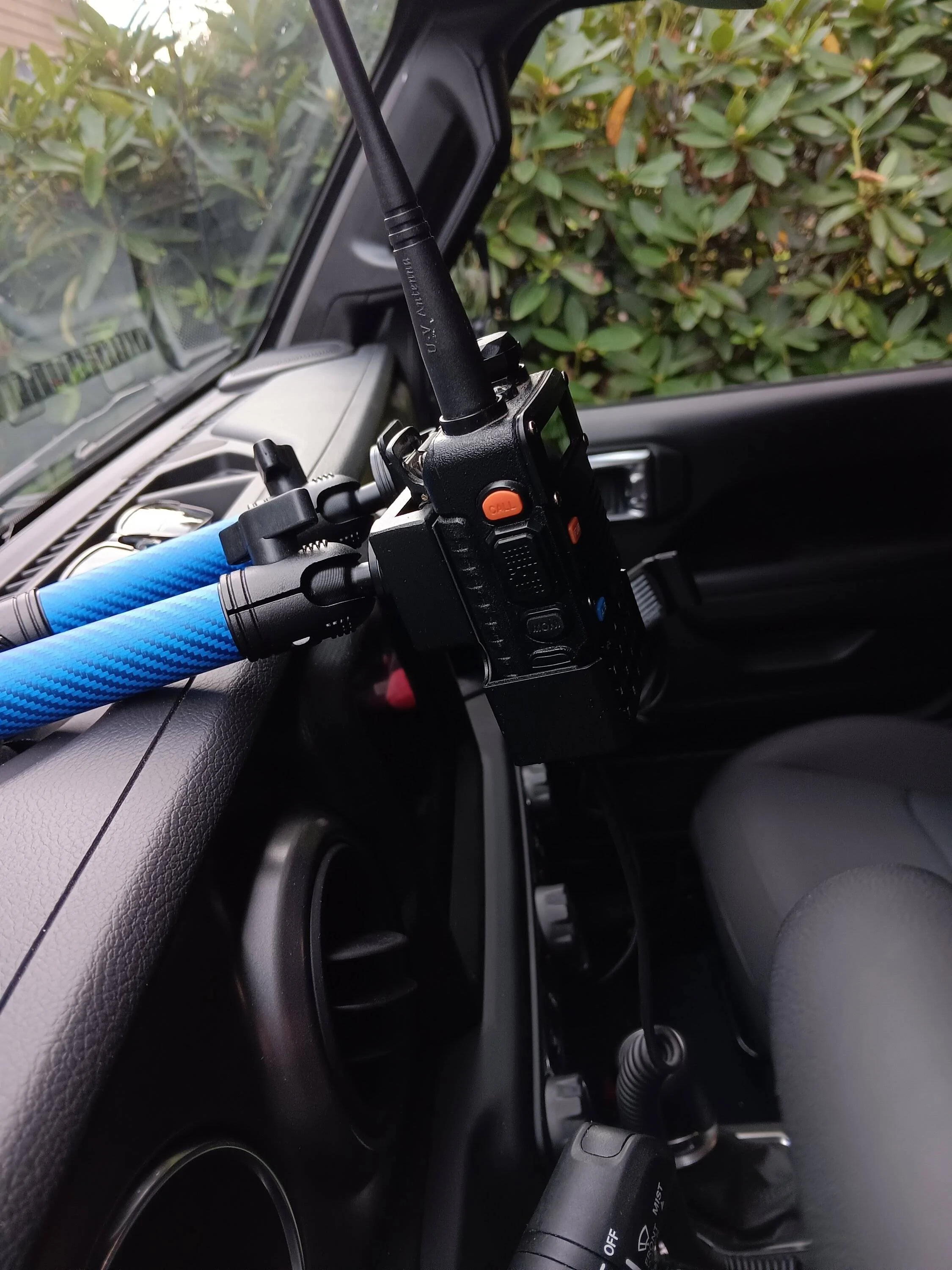

Ok... I'm sure some of you have been anxiously waiting for my 4cm arm to come in to replace one on the 7cm arms and see how it works. The wait is over!
I replaced the radio holder's 7cm arm with the shorter 4cm arm. Makes a huge difference. It brings the radio closer to the dash, and now the mic face is in the same plane as the radio. Here are some pics.

The only thing I don't like is that the 12volt accessory plug isn't hot all the time. But I've got extra UV-5Rs so I'm fine (the one pictured is an 8 Watt radio) for when I'm outside the Jeep.
So this makes a nice little inexpensive kinda hard mounted radio setup for group trail runs. The antenna is up high (sun visor still has full range of motion). Sound comes out the mic (I actually have a new mic on order that's supposed to be better - we'll see) and the mic is easy to reach and use. BaoFeng (and others) make UV-5R sized GMRS Radios that'll fit with this Bulletpoint mount.
And if you do later get a larger more expensive radio, you're still ahead of the game cause you've got a hand held (or two) to go along with your bigger radio. And a place to put your new radio's mic.
