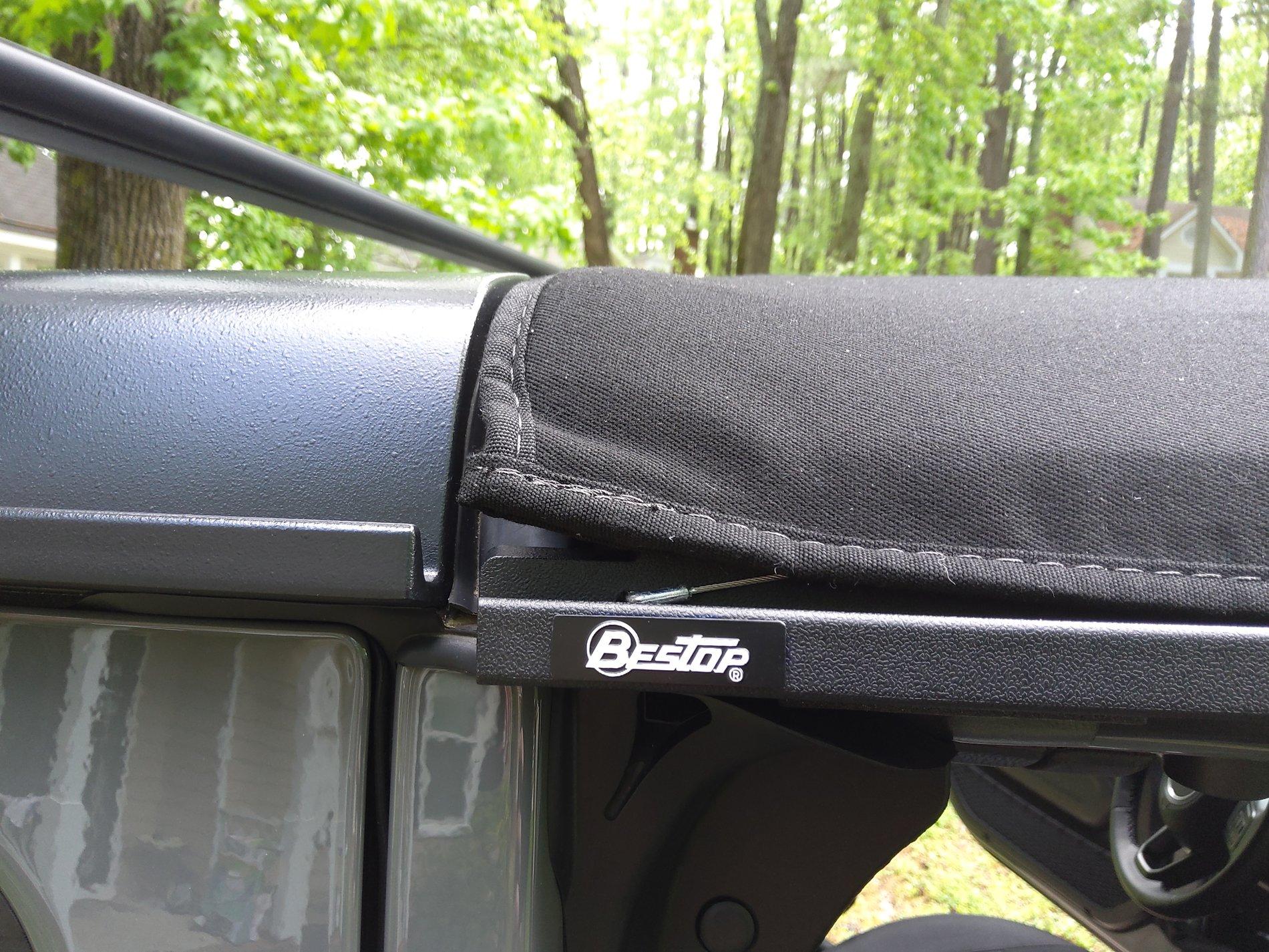

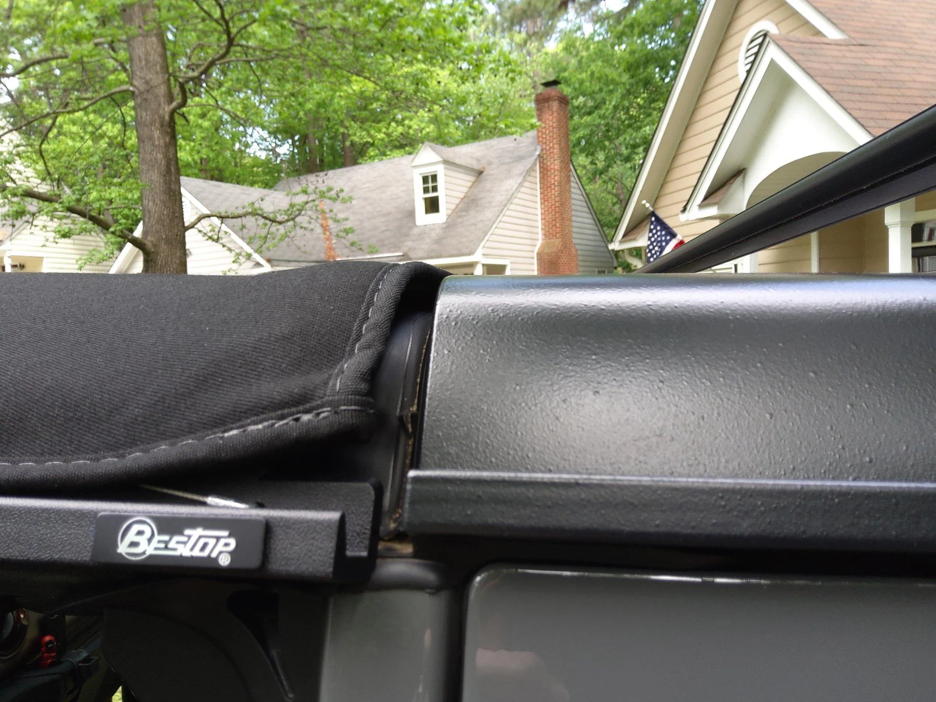

Just installed mine. This dosen't look right all.
Don't stress. When I installed mine a few weeks back I had the same issue on one side. All you need to do is fold the top all the way open, then starting on one side loosen the side rail bolts. On the base in each rear corner is a rubber boot/seal. Right now your foldable top seal is on the outside. This is not correct. With the rail(s) loosened, you should be able to put the fabric top seal on the inside of the bottom one correctly. It's hard to explain without pics, but go take a look and it should be obvious once you understand. Hope this helps.

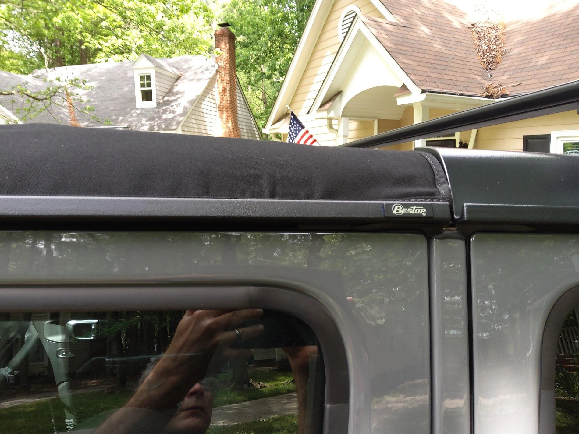

I messed with it and got it fixed. I was stressed! Thanks!
