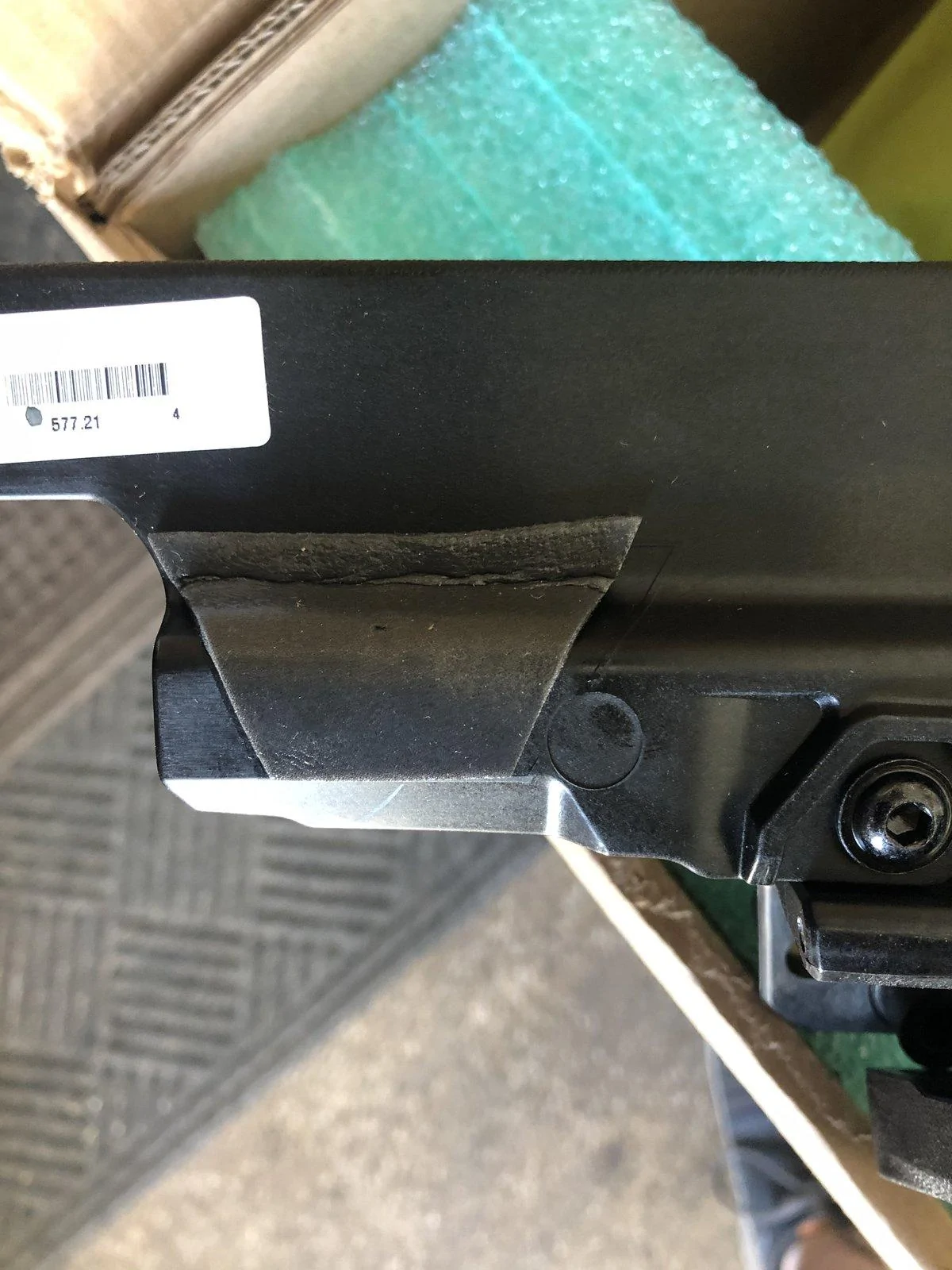

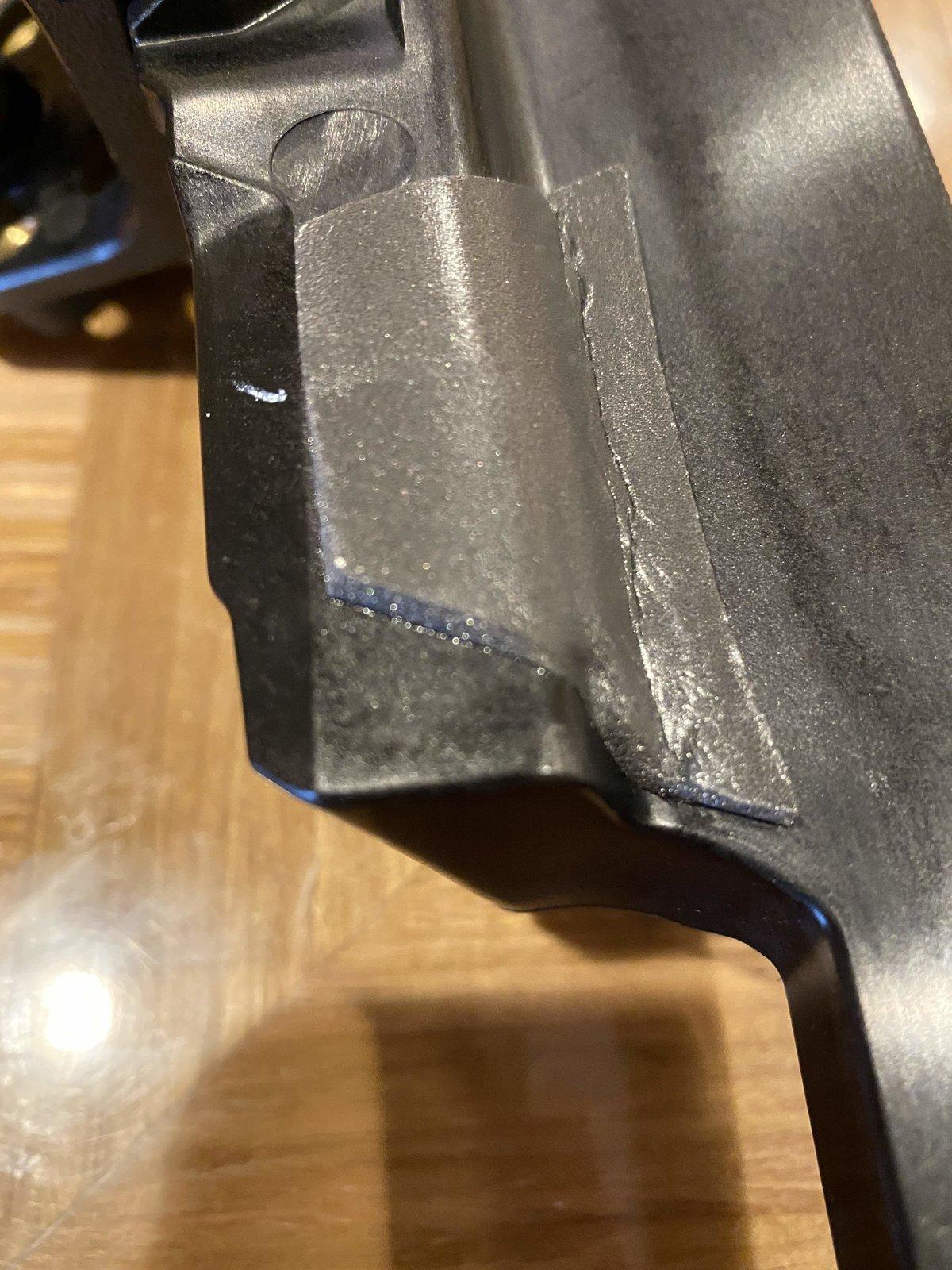

@Bestop, I just had a chance to really examine the door rails from my Sunrider, now that they have been removed from my Jeep. Upon close inspection, I definitely notice a difference in the foam pads on the front of each rail. The front edge of the passenger side foam is still plush and has some thickness and give to it. The front edge of the driver side, where my leak was, is flattened out and no longer has any thickness to it. I believe this was causing an improper seal and allowing water to seep between the door rail and the rubber mucket it sits in. I'm not sure how that happened. I don't know if it's possible to over tighten the door rails. I basically snugged them up by hand until tight. I've attached some pics to show what I've found. I will definitely examine the door surrounds when my replacement top arrives. Hope this proves helpful.

Sorry about your knee. When you install your top, would you mind taking some pictures of the foam on the front part (the sides without the Bestop logos, like I did above) of the door rails before you start putting everything together? Post them here if you can. Thanks.

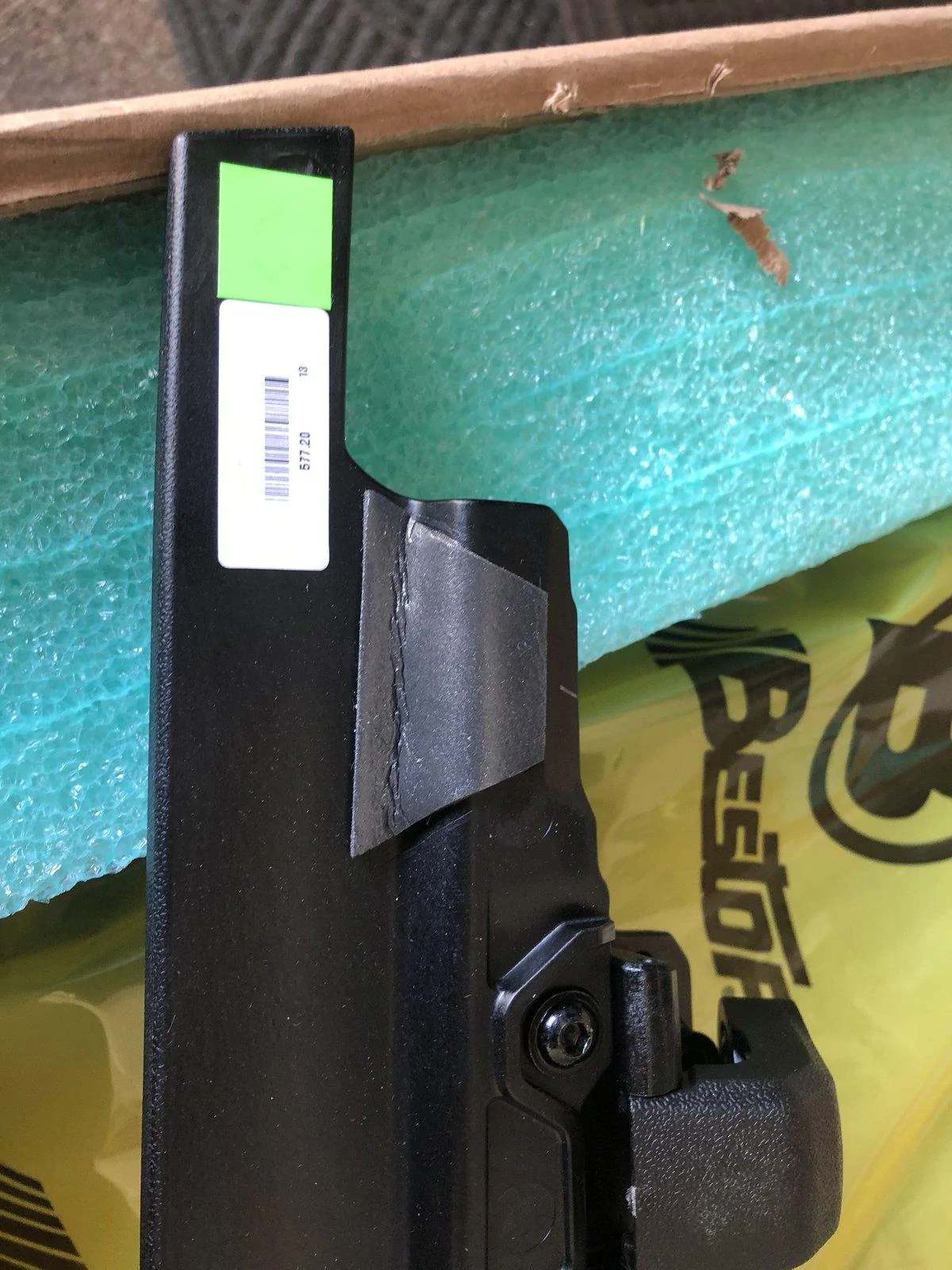

Install is easy, I did have a little issue keeping the unit square but that's me being anal. I do have a lot of noise from driver side and the latch is extremely loose compared to the passenger side. Here are the photos.
Much appreciated. Those foam pads look nice and plush, so all should be good. My driver side definitely doesn't look like yours. Granted it was previously installed, but it should not have completely flattened out the way it did.Still waiting for my replacement top to arrive. Should be here tomorrow.
If you haven't already, contact Bestop support. They will get you sorted. They've been great throughout my ordeal. Good luck!
