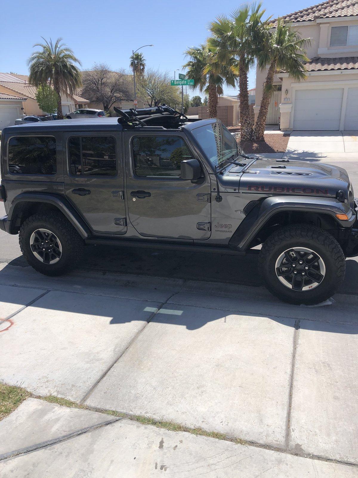

The little adjustment made to the driver side seems to have worked eliminating wind noise. This is by far the best thing I have added to the Jeep... Little photo after running supplies up to mom.
